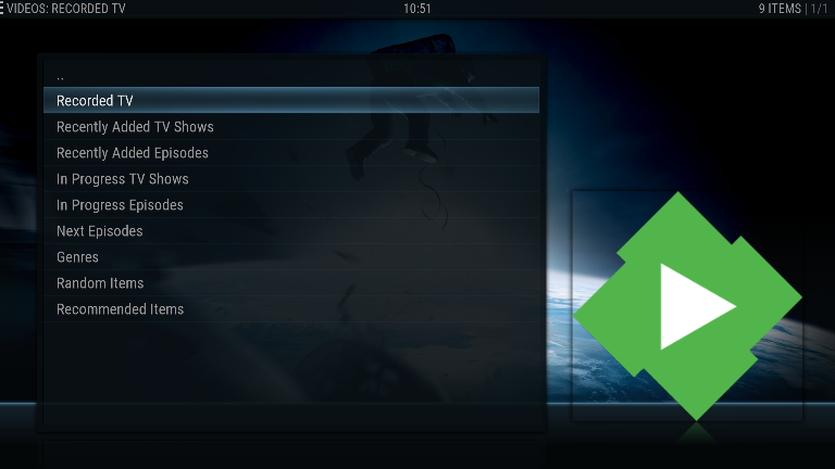

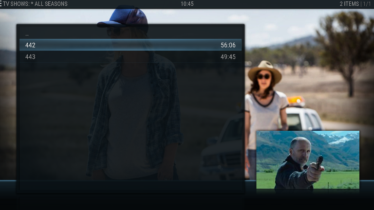

OompaLoompa 1 Posted July 2, 2017 Author Posted July 2, 2017 (edited) Thanks for your reply, but I'm a bit lost here ... let's take it step-by-step: >which displays everything type "show" Correct. In Emby Server I have created a separate library item called "Recorded TV" of type TV. In Kodi it's all lumped together under TV Shows. >See this to change your home shortcuts I've created a shortcut pointing to Add-On->Video Add-On->Emby->Recorded TV->Recorded TV but that (a) doesn't solve my problem described above and (b ) shows weird numbers instead of titles/file names. If I select just "Recorded TV" (without the second "Recorded TV") then it kinda works - shows all the options which I drill down into and then file names display OK. Edited July 2, 2017 by OompaLoompa
Angelblue05 4132 Posted July 2, 2017 Posted July 2, 2017 (edited) Ok, what you did is correct, the numbers happen when the shortcut type is incorrectly detected. Can you tell me what the shortcut is? It should start like ActivateWindow( Edited July 2, 2017 by Angelblue05

inkubux 7 Posted August 22, 2017 Posted August 22, 2017 Thanks for your reply, but I'm a bit lost here ... let's take it step-by-step: >which displays everything type "show" Correct. In Emby Server I have created a separate library item called "Recorded TV" of type TV. In Kodi it's all lumped together under TV Shows. >See this to change your home shortcuts I've created a shortcut pointing to Add-On->Video Add-On->Emby->Recorded TV->Recorded TV but that (a) doesn't solve my problem described above and (b ) shows weird numbers instead of titles/file names. If I select just "Recorded TV" (without the second "Recorded TV") then it kinda works - shows all the options which I drill down into and then file names display OK. I have the same issue while creating my menus items for my "Workouts" as they are the type TV Shows, but I like to separate them.. When you put a shortcut to a Add-On->Video Add-On->Emby->Workout->Workout, I also have numbers instead of shows. It's pretty annoying. You can do things with playlist, but it's long and cumbersome to configure as I like the categories like Recently Added, In Progress, that the adon populates by itself. I usually put them as widgets, So I need to recreate all theses playlist.. If I use other plugins I can't mention here, when going to Add-On->Video Add-On->"Some plugin"->TV Shows->Top Rated and put them as menu item or widget in kodi everything is fine.
Angelblue05 4132 Posted August 22, 2017 Posted August 22, 2017 (edited) @@inkubux The numbers appear because the shortcut defaulted to Music type, instead of Video type. To fix this, you need to edit the shortcut action and make sure it starts with ActivateWindows(Videos,... rather than ActivateWindows(Music,... Edited August 22, 2017 by Angelblue05 1
