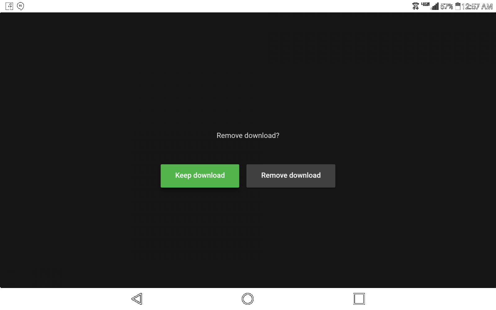

Dizzy49 99 Posted June 27, 2017 Author Posted June 27, 2017 @@Dizzy49, the files are removed during the next background sync with the server. Incidentally when you remove the download, the confirmation dialog box tells you about this. Did you read the dialog? No, the confirmation dialog did not mention that. When I an viewing the video and click the 'Downloaded Link' I get the following screen. When I click on 'Remove Download' it goes back to the video screen and it then says 'Download' instead of 'Downloaded'.
Luke 42243 Posted June 28, 2017 Posted June 28, 2017 @@Dizzy49, so what was the issue after you clicked Remove Download? The text changed to Download which sounds correct, right?
Dizzy49 99 Posted June 29, 2017 Author Posted June 29, 2017 (edited) @@Dizzy49, so what was the issue after you clicked Remove Download? The text changed to Download which sounds correct, right? Yes, but it was not actually removed from the device, and when I ran the sync again it didn't do anything since the memory was full. Based on my observations, it didn't remove the files until the upload was "complete". I ended up removing a bunch of apps and data to make room, and cancelled many of the videos. It uploaded the one remaining video, THEN it removed all of the videos I marked to remove. IMO, having to wait until it syncs to remove the videos is a bad user experience. When I click REMOVE, I expect it to be REMOVED, not queued for removal at some unknown point. If the device is full, I may need to clear room to install an app or something, and I need that space reclaimed immediately. At the moment the issue is made worse by the fact that the downloaded items don't play anyway. So they need to be removed before they will even play off the server while on the home network. So I had to remove, then manually sync, THEN I could play the video I wanted. Edited June 29, 2017 by Dizzy49
