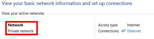

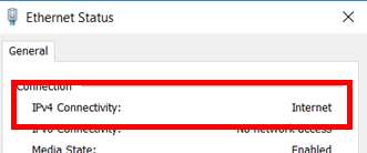

rhodges 49 Posted June 30, 2017 Posted June 30, 2017 I don't really know then. Proxy and windows firewall/router firewall settings are the only things I can think of. Longshot...You might double check your DNS server. A wild guess, but maybe they aren't resolving properly on the 2016 box and maybe Chrome will fall back internally to their 8.8.8.8 DNS servers. IPCONFIG /ALL and double check your DNS Servers and Default Gateway. A "telnet www.thetvdb.com 80" or "telnet www.google.com 443" should connect instantly like you see on your win 10 box. I have attached some pics highlighting what I'm referring to on the firewall. You probably already know this, but, on the off chance something got miss communicated... I am out of ideas at this point. Like I mentioned, I have Windows 2016 up and running and encountered none of these issues. Maybe just blow away the install and start again? Install and then try the telnet/IE thing right out of the box. Keep trying that after any post install configuration step you do.
