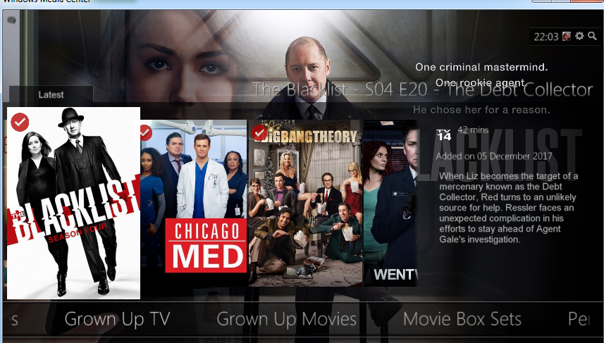

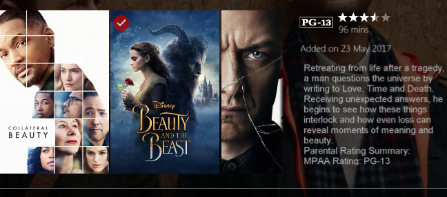

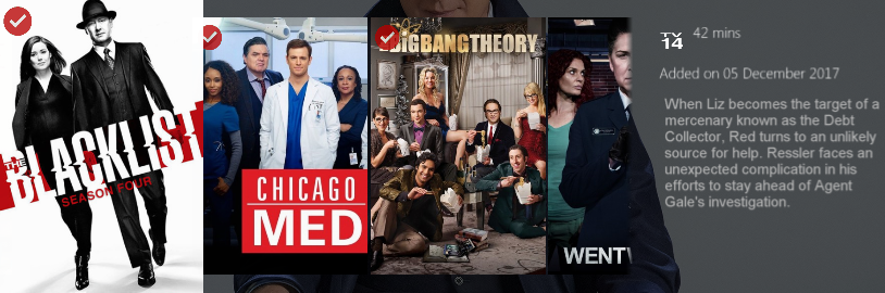

karldonteljames 3 Posted June 19, 2017 Posted June 19, 2017 Good evening. All of the media that is on my "TV Folder" lists the latest media as being added between August and December this year, obviously this is wrong. Any new movies that are added are imported with the correct date, I use media centre master to tag, and copy the files to the correct location, and after checking the metadata for those items the date on them seems correct. - the date on the video coincides with the date in the metadata file. The metadata "Date added behaviour for new content" is set to date scanned into library, and the date/time on my computer & tagging VM are both correct. Any suggestions as to why this might be happening? Below are pictures of my tv shows folder showing the date, movies folder, metadata manager and metadata settings. Many thanks.
Luke 42201 Posted June 19, 2017 Posted June 19, 2017 Are you sure it is set to date scanned, because your screenshot shows otherwise?

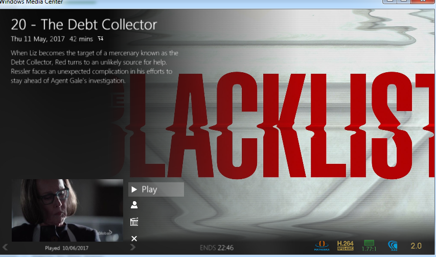

karldonteljames 3 Posted June 19, 2017 Author Posted June 19, 2017 lol, it was set to date scanned, but i think i changed it when i was checking the settings. it's saving as an xml file. i have just noticed that if i open the "tv series" and select an individual episode the date on the episode is correct. it looks like its getting a future date from the container maybe? Thanks

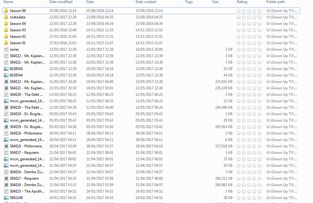

karldonteljames 3 Posted June 19, 2017 Author Posted June 19, 2017 (edited) this is a copy of all the files in the folder and sub-folders for the blacklist, sorted by date, but emby is showing that it was added on the 4th december 2017. Edited June 19, 2017 by karldonteljames
Luke 42201 Posted June 19, 2017 Posted June 19, 2017 That is probably the date modified timestamp, not date created.

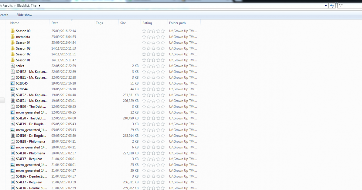

karldonteljames 3 Posted June 19, 2017 Author Posted June 19, 2017 I've added another screenshot. and here are a couple more.
Luke 42201 Posted June 19, 2017 Posted June 19, 2017 also check the metadata files to see if they have a dateadded value, because if they do then that will always be utilized over any dates on the files. the server doesn't make up these dates, they come from somewhere, so you will just have to find out where. but the important thing is to think about the state not now, but at the time the content was first scanned in. that's why this can be difficult to hunt down after the fact.
