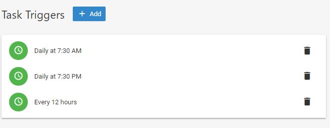

kingy444 117 Posted June 22, 2017 Author Posted June 22, 2017 (edited) Potentially something to point the issue out XMLTV are downloaded at 7AM and 7PM daily from my available source.EMBY then ingests these files from NextPVR at 7:30am and 7:30pm This morning around 9am when testing the debug file from @UncleJohnsBand everything was miraculously working again. I undid the changes and everything was still working - go figure. Come home this afternoon and everything is not working again - until after the 7:30pm sync of files - then everything starts working again. I guess the next step would be to test how long after the sync time 8:30, 9:30, 10:30 etc that the error starts occurring, and whether a forced sync of the same XML file fixes the issue - I can't see why this should effect anything though. Any ideas? The EPG doesnt change that much in those 12 hours to start throwing errors. edit: note that the epg source is only updated every 12 hours too - so there would be no change in files if i ran a sync at say 1pm Edited June 22, 2017 by kingy444

emveepee 133 Posted June 22, 2017 Posted June 22, 2017 (edited) No matter how many times Emby makes requests, the EPG data NextPVR only gets the data from the source once every 24 hours and you have it setup to happen at 12pm. That means from 12pm until 7:30pm Emby and NextPVR will be out of sync and you won't be able to record even if live tv continues work The rest of the time will use the 12pm DVB and 7:30 am xmltv data. Assuming you choose 12pm to get as much data in the evening as possible, it would make more sense to download your xmltv source closer to the NextPVR update time, and then follow that with the Emby download also once a day. You might want to consider alternative EPG sources, have you considered Schedules Direct? I have confirmed that the log message 2017-06-22 09:02:14.915 [DEBUG][29] Unknown schedule record occurs when the EPG ID is not valid and NEWA returns a 404 Martin Edited June 22, 2017 by emveepee
sub3 64 Posted June 22, 2017 Posted June 22, 2017 (edited) Yeah, Martin is correct. You have the situation where Emby has stale data, and (for example) it's asking NextPVR to record show ID 12345, but 12345 no longer exists in the database, You'd be best to have NextPVR update the EPG at some early hour like 3:00am, and have Emby pull in the listings from NextPVR soon after that (like 3:30am). Just one a day is probably enough, and avoid trying to update the EPG in primetime like 7pm. Edited June 22, 2017 by sub3
kingy444 117 Posted June 22, 2017 Author Posted June 22, 2017 XMLTV are downloaded at 7AM and 7PM daily from my available source. EMBY then ingests these files from NextPVR at 7:30am and 7:30pm When i said this i meant i am already doing extra syncs
sub3 64 Posted June 22, 2017 Posted June 22, 2017 (edited) I'd get rid of those, and only do a single update about 15-30 minutes after NextPVR is scheduled to do its overnight EPG update. Ideally set NextPVR to do it's EPG update well away from any time you might be recording. (ie, like 3am) The problem was occurring between the times NextPVR updated it's EPG (12PM) and the time Emby reloaded it's EPG from NextPVR (7PM). During this time Emby would had stale show data, with show IDs that no longer match the real shows in the database. (at least that would be with XMLTV or DVB EPG...Schedules Direct works differently and unlikely to have the same issue) Edited June 22, 2017 by sub3
kingy444 117 Posted June 22, 2017 Author Posted June 22, 2017 so i tested at 6:30 this morning - no issue. 11 hours after the epg update, ill try around 5-6 pm today aswell. perhaps from what your saying at 1pm as well? Why would this make a difference when the same XML data is being loaded at 7:30 and 12pm? i forgot to mention that after i download the updated epg files at 7am, i also do a force update of the nextpvr epg - hence leaving till 7:30 for emby to do the sync. why would we doing less epg updates be preferable? wouldn't keeping the epg up to date as possible be the best solution?
sub3 64 Posted June 22, 2017 Posted June 22, 2017 (edited) Why would this make a difference when the same XML data is being loaded at 7:30 and 12pm? Ok - let me explain in more detail why you should do the Emby update just after the NextPVR EPG update. (below relates to using XMLTV or DVB EPG in NextPVR) When NextPVR updates it's EPG it effectively deletes all the listings that are in the database, and replaces it with the new EPG data. When it does this each show is allocated the next show ID. So...at 7PM tonight might be NCIS, and it's allocated ID 12345. At some point after that Emby is pulling in the NextPVR EPG data. It then also knows there is a show called NCIS at 7PM tonight, with a show ID of 12345. If NextPVR then updates EPG again, 12345 is deleted when the new EPG data is inserted. NCIS at 7PM is still in the new EPG data, but it gets a new ID, like maybe 23456. If Emby hasn't refreshed its data, and you try to schedule a recording for NCIS, it'll effectively say to NextPVR "record show 12345", and NextPVR is return "sorry, I don't have a show 12345". So... to minimize the risk of this happening, just make sure Emby updates it's data just after NextPVR has updated EPG. This way, Emby will have the correct show IDs, and you won't encounter the situation described above. Edited June 22, 2017 by sub3

kingy444 117 Posted June 23, 2017 Author Posted June 23, 2017 Also 3:40pm and it seems to be broken again with the last sync happening at 7:30 this morning (test at 8 am worked fine) Run a manual "Refresh Guide" task in emby to sync the file from 7am again, Even though it is the same data being synced - the same recording now works... While the approach of doing less syncs makes sense, it appears that resyncing fixes the issue? Any ideas now?
