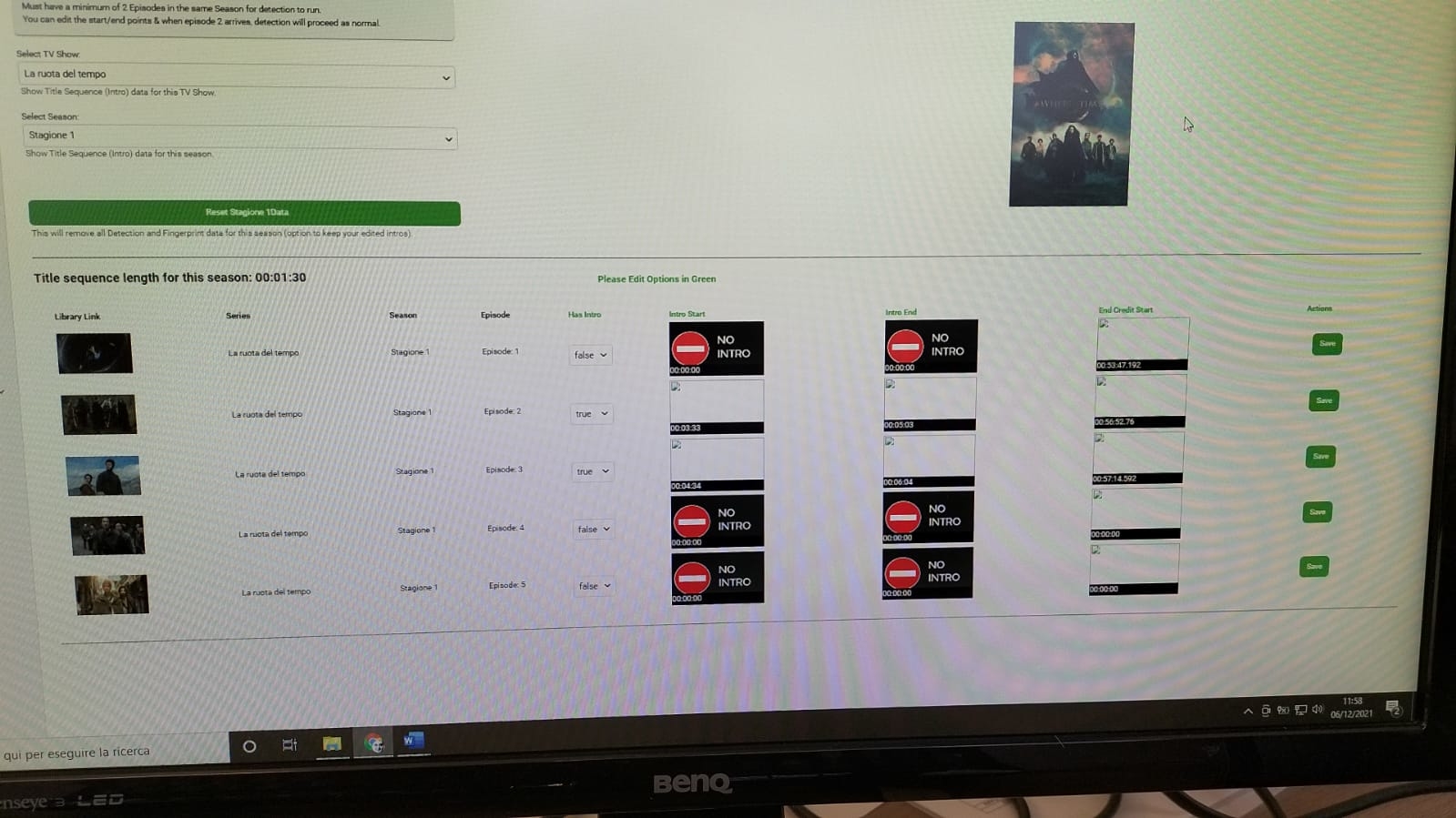

fbrassin 47 Posted December 6, 2021 Posted December 6, 2021 I've just run FP and SD. In the "wheel of time" i already had the first 3 episode detected correctly, episode 4 and 5 are new ones. But i see them without intro even if there is one. Here is what i see. Do you want me to try anything? 1

fbrassin 47 Posted December 6, 2021 Posted December 6, 2021 1 hour ago, neik said: @fbrassin, what OS and what Emby version are you in? The server is installed on ubuntu, server version is 4.7.0.18 beta 1

fbrassin 47 Posted December 6, 2021 Posted December 6, 2021 (edited) 1 hour ago, Cheesegeezer said: Try and reset the season. and run FP and Detect again. What we have noticed is that the Detection can be cut short the core library scan or config backup tools run. We will add a disclaimer when released. but there is nothing we can do about it. I reset season and update metadata of the season. And not intro and end credits have been found. Do you mean that sometimes FP is stopped before ending? BTW, if it happens again, do i need only to reset season or also update metadata? Edited December 6, 2021 by fbrassin
neik 874 Posted December 6, 2021 Posted December 6, 2021 1 hour ago, fbrassin said: The server is installed on ubuntu, server version is 4.7.0.18 beta It might be related to that as I am seeing the same. From what I know there is something wrong that the next or one of the next server betas should solve. chef, cheese, what fbrassin is seeing seems to be the extraction problem I reported in the testing topic. Please correct me if I am wrong though.
Cheesegeezer 3106 Posted December 6, 2021 Posted December 6, 2021 1 hour ago, fbrassin said: I reset season and update metadata of the season. And not intro and end credits have been found. Do you mean that sometimes FP is stopped before ending? BTW, if it happens again, do i need only to reset season or also update metadata? See Neik response below 19 minutes ago, neik said: It might be related to that as I am seeing the same. From what I know there is something wrong that the next or one of the next server betas should solve. chef, cheese, what fbrassin is seeing seems to be the extraction problem I reported in the testing topic. Please correct me if I am wrong though. Ahhhh yes.... Glad you're here to remind us!! lol There appears to be an issue with the new ffmpeg. Would you be able to go into your system.old folder and switch the 3 x ffmpeg files to the system folder. this could fix it, if it is a ffmpeg revision included in linux beta.
