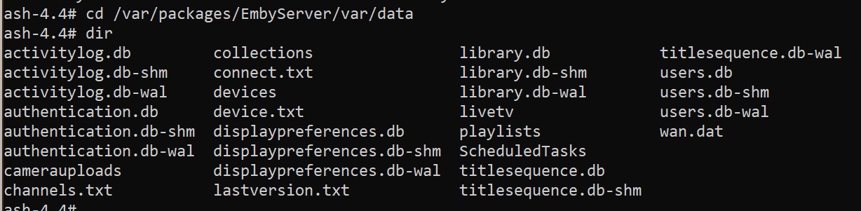

kaj 339 Posted October 13, 2021 Posted October 13, 2021 2 minutes ago, Cheesegeezer said: Hi Kaj, there are a lot of unauthorised access errors in the log to file paths, wondering if this is the issue. probably not, it doesn’t look like any errors are from Introskip. Have you got thumbnail images showing in the UI? As it seems to be requesting a lot of them. Everything thumbnail-wise working perfectly, missing none. Maybe it's my client (Edge Dev with many security extensions?). I can try again using the Emby Theatre app? where should the database be created? As I can't find that all all.

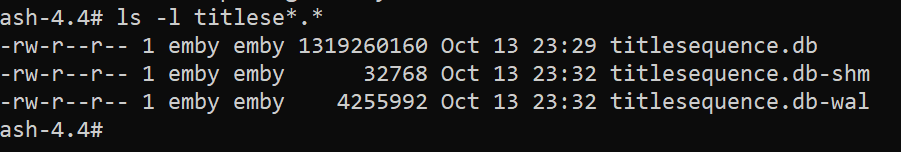

chef 3811 Posted October 13, 2021 Posted October 13, 2021 45 minutes ago, kaj said: Thanks for looking into this. What is failing on the sync side? Is this it: Data path: /var/packages/EmbyServer/var Application path: /volume1/@appstore/EmbyServer/system System.UnauthorizedAccessException: System.UnauthorizedAccessException: Access to the path is denied. I did upgrade to DSM 7 and had problems that @cayars helped me with. Task is running really slowly, just like the first time, so only up to 1.2% right now. The weird Season 8 I think is from a very old folder with Game of Thrones from way before my Emby days... I don't quite understand why it is Fingerprinting the library again. That has me stumped. Would you be able to tell me the size of the titleSequence.db file? If you don't mind letting it run until it is complete, When it finishes you could post a log again. It might not be until tomorrow morning. In that case, the log will save and there will be a new log create in the early hours of the morning. Perhaps, we can look at both of them, to really get an idea as to why it ran twice. If that's cool with you?
kaj 339 Posted October 13, 2021 Posted October 13, 2021 (edited) 6 minutes ago, chef said: I don't quite understand why it is Fingerprinting the library again. That has me stumped. Would you be able to tell me the size of the titleSequence.db file? If you don't mind letting it run until it is complete, When it finishes you could post a log again. It might not be until tomorrow morning. In that case, the log will save and there will be a new log create in the early hours of the morning. Perhaps, we can look at both of them, to really get an idea as to why it ran twice. If that's cool with you? Yup, no probs, I'll leave it running until it's finished. Edited October 13, 2021 by kaj
chef 3811 Posted October 13, 2021 Posted October 13, 2021 (edited) Good morning @kaj. Just wondering if the task completed, and if the file size grew for the data base file at all? if the data base file isn't too large, would you consider PM'ing me the file. If it is absolutely huge, then we'll have to sort out some other ways to double check results, and figure out what might be happening. Would love to see some logs in any case, if you have time today. thank you again for taking the time! Edited October 13, 2021 by chef

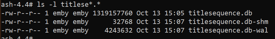

kaj 339 Posted October 13, 2021 Posted October 13, 2021 23 minutes ago, chef said: Good morning @kaj. Just wondering if the task completed, and if the file size grew for the data base file at all? if the data base file isn't too large, would you consider PM'ing me the file. If it is absolutely huge, then we'll have to sort out some other ways to double check results, and figure out what might be happening. Would love to see some logs in any case, if you have time today. thank you again for taking the time! Morning Chef... (or rather it's 11.30pm here ) It's going even more slowly than before...only at 16.6% right now File size has remained exactly the same:
chef 3811 Posted October 13, 2021 Posted October 13, 2021 1 minute ago, kaj said: Morning Chef... (or rather it's 11.30pm here ) It's going even more slowly than before...only at 16.6% right now File size has remained exactly the same: The file size maintaining is actually a good thing. Db files don't change size untill we tell them to. Can I see a log again? 11:30pm, you are on the other side of the planet. Awesome!

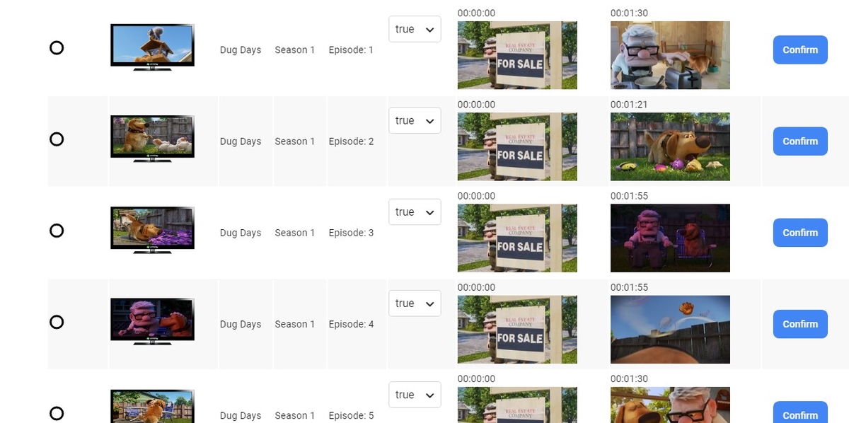

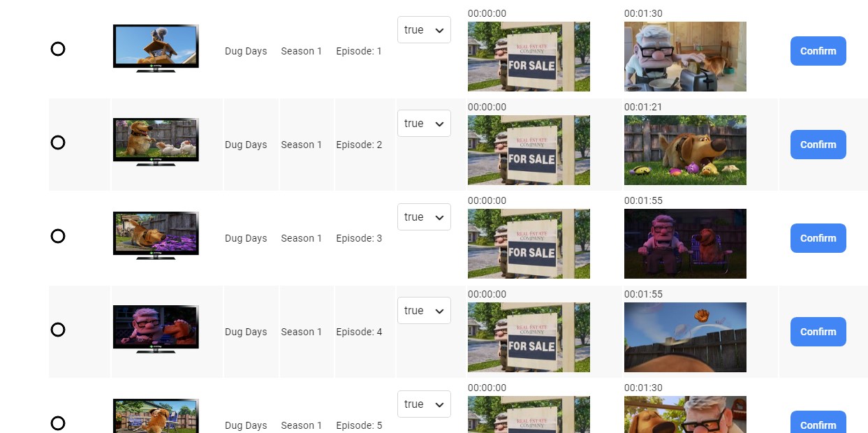

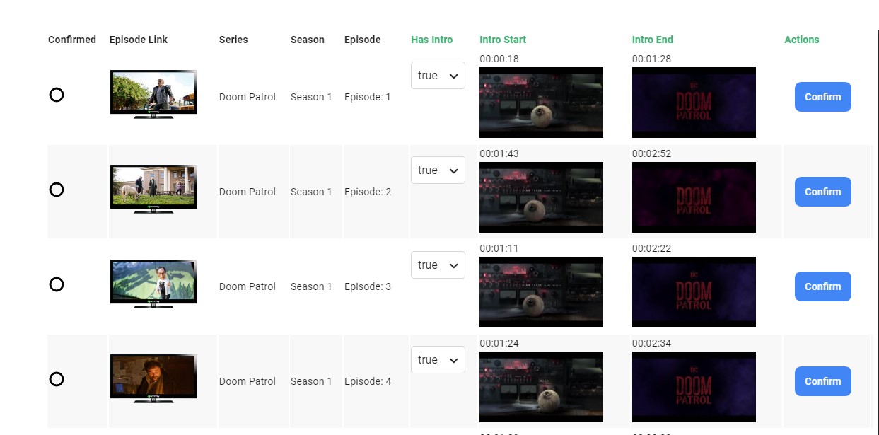

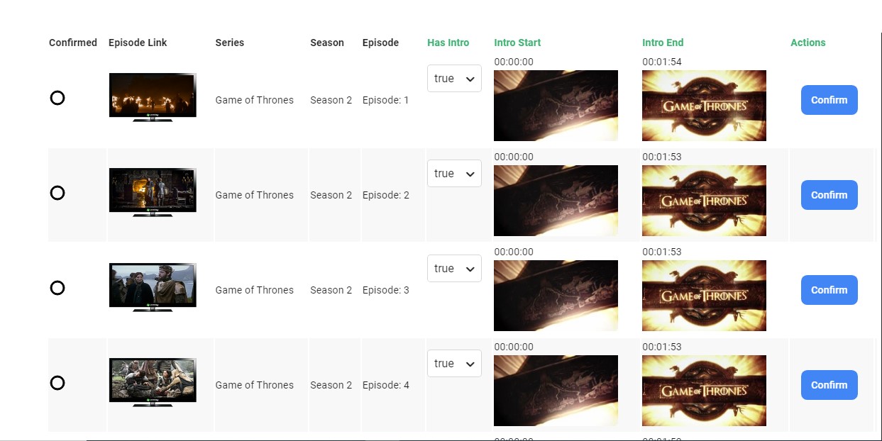

chef 3811 Posted October 13, 2021 Posted October 13, 2021 So I thought I'd share some of my screen shots of the plugin doing its job well. It's very exciting! And I'm hopeful to see some results from the community like this. 2
CBers 7557 Posted October 13, 2021 Posted October 13, 2021 35 minutes ago, chef said: So I thought I'd share some of my screen shots of the plugin doing its job well. It's very exciting! And I'm hopeful to see some results from the community like this. What's the difference between the GREEN and ORANGE dots @chef ? 1
samuelqwe 317 Posted October 13, 2021 Posted October 13, 2021 4 minutes ago, CBers said: What's the difference between the GREEN and ORANGE dots @chef ? Green is for episodes where you have confirmed the intro, and yellow is yet to be confirmed. 1

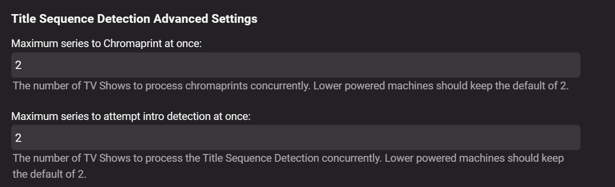

chef 3811 Posted October 13, 2021 Posted October 13, 2021 41 minutes ago, kaj said: Morning @chef Update: Only at 42.5% this morning Hmm... If you go into advanced settings, and set the concurrent fingerprint value up to 4. Then stop the task, and start it again. We should see it jump to 42.5%. Then continue at a faster rate. Would you mind trying that?
kaj 339 Posted October 13, 2021 Posted October 13, 2021 13 minutes ago, chef said: Hmm... If you go into advanced settings, and set the concurrent fingerprint value up to 4. Then stop the task, and start it again. We should see it jump to 42.5%. Then continue at a faster rate. Would you mind trying that? Both of these to 4?
chef 3811 Posted October 13, 2021 Posted October 13, 2021 Just now, kaj said: Both of these to 4? Just the top one
kaj 339 Posted October 13, 2021 Posted October 13, 2021 @chef Done, but..... started on 1%, then a couple of seconds later went to -0.7%, now sitting on 0%. Taking the dog out for a 20 minute walk, will check on return
