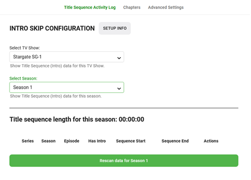

TXK57 36 Posted October 12, 2021 Posted October 12, 2021 I updated to the latest dll file and this allowed the tasks to actually run. However, when I go through any of my shows they do not show anything. Could you let me know what to check next?
Cheesegeezer 3106 Posted October 12, 2021 Posted October 12, 2021 31 minutes ago, TKX57 said: I updated to the latest dll file and this allowed the tasks to actually run. However, when I go through any of my shows they do not show anything. Could you let me know what to check next? That's a very old interface there. You probably need to clear your browser cache. It should look like this now.

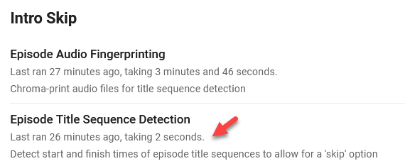

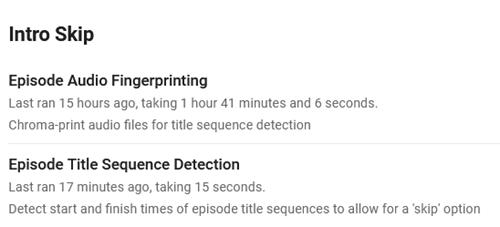

kaj 339 Posted October 12, 2021 Posted October 12, 2021 So, my initial Audio Fingerprinting finished while I was sleeping last night, after about 36 hours or so. However, as I was asleep and the installation had set up Audio Fingerprinting as a run-every-24-hours scheduled task, it is now running again, currently on 10.2%. Do I let it finish running before attempting anything else? I've probably added less than 10 new episodes since the initial scan started. Maybe the installation should not set any scheduled tasks, and that should be added manually once the initial large scan has completed? 1

chef 3811 Posted October 12, 2021 Posted October 12, 2021 1 hour ago, kaj said: So, my initial Audio Fingerprinting finished while I was sleeping last night, after about 36 hours or so. However, as I was asleep and the installation had set up Audio Fingerprinting as a run-every-24-hours scheduled task, it is now running again, currently on 10.2%. Do I let it finish running before attempting anything else? I've probably added less than 10 new episodes since the initial scan started. Maybe the installation should not set any scheduled tasks, and that should be added manually once the initial large scan has completed? @kaj can I see another log. Unfortunately, I'm not sure we can have an empty field in the schedule part of the scheduled task. You can remove the schedule, but the code expects something there. If fingerprinting is running again, it should skip over items that already have the data, so it should be quick and painless. But a log would be very helpful. Thank you again!
