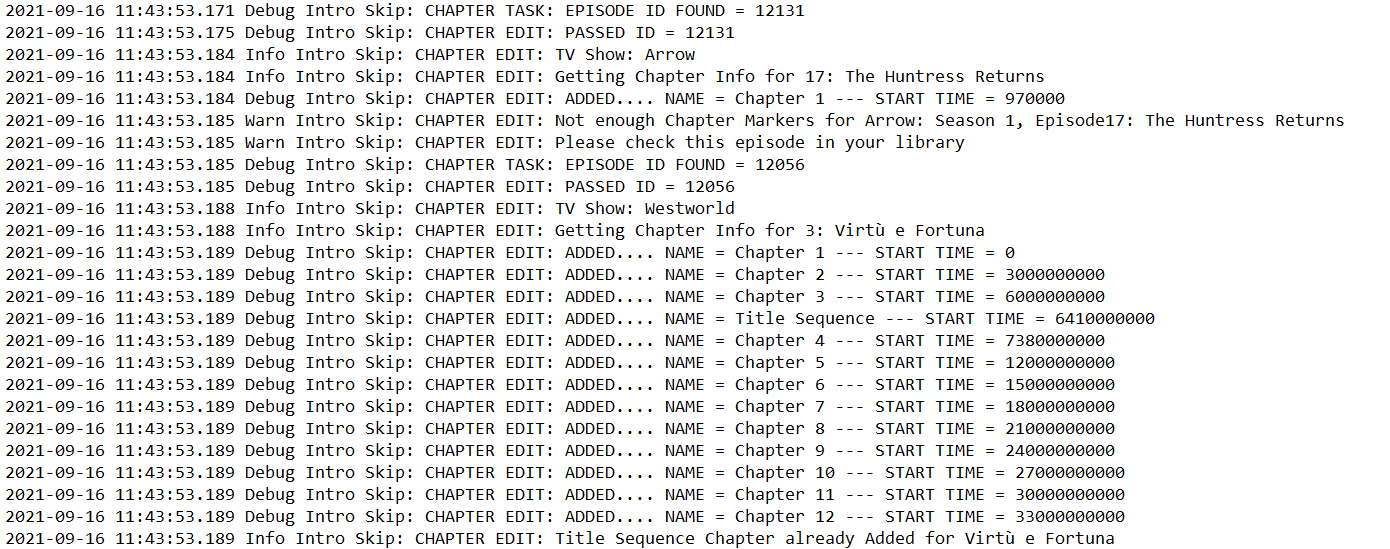

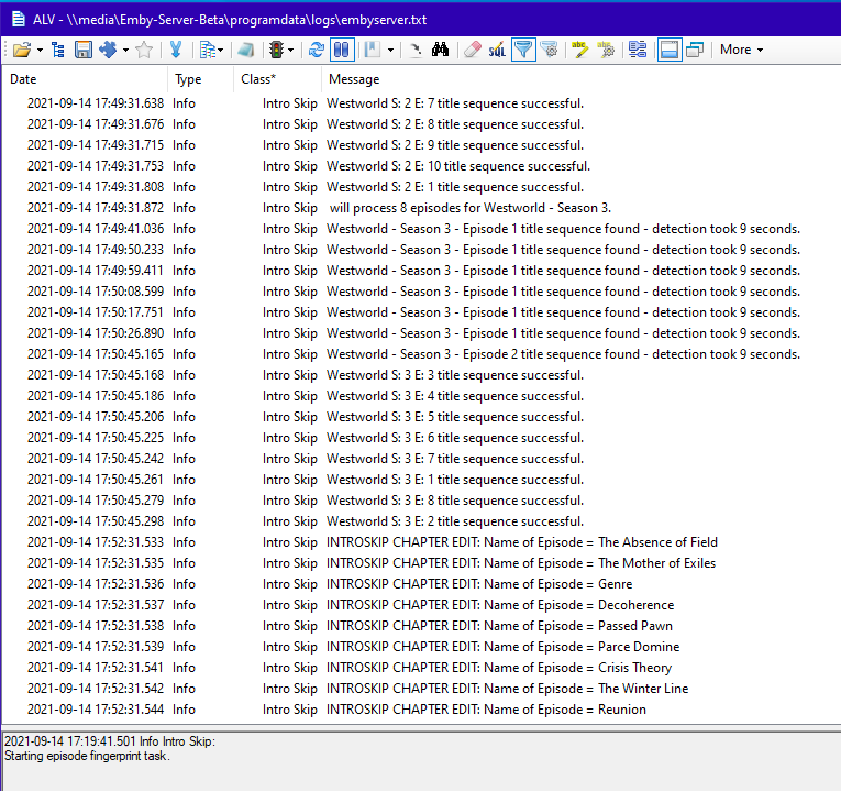

rbjtech 5345 Posted September 16, 2021 Posted September 16, 2021 (edited) 53 minutes ago, CBers said: @Cheesegeezer / @chef Would it be possible to change the log entry for each of the 3 scheduled tasks so that they are easily identified? It may even help yourselves debugging stuff with only having to filter for one of them. Perhaps: Intro Skip Audio Intro Skip Episode Intro Skip Chapters OR Intro Skip A Intro Skip E Intro Skip C Just a thought. The Class needs to stay as 'Intro Skip' (as it uses the Plugin Name') but the Message could be prefixed by the stage - FP, Detect or Chapter - I agree. Chapter already does - but it repeats Introskip as well ... .. probably not top of the list at the moment but in the strive for perfection I'll add to the list .. edit - btw - this is an old log, I would also need to filter for type = 'Debug' to get these messages now.. Edited September 16, 2021 by rbjtech
Cheesegeezer 3106 Posted September 16, 2021 Posted September 16, 2021 1 minute ago, rbjtech said: The Class needs to stay as 'Intro Skip' (as it uses the Plugin Name') but the Message could be prefixed by the stage - FP, Detect or Chapter - I agree. Chapter already does - but it repeats Introskip as well ... I've removed all of the Introskip prefixes now 1
Cheesegeezer 3106 Posted September 16, 2021 Posted September 16, 2021 I also think that if @chef new detection code is a mega winner -- we can Consolidate the FP and Detection tasks into 1 Task to avoid confusion for the masses when released. 1
Cheesegeezer 3106 Posted September 16, 2021 Posted September 16, 2021 8 minutes ago, rbjtech said: The Class needs to stay as 'Intro Skip' (as it uses the Plugin Name') but the Message could be prefixed by the stage - FP, Detect or Chapter - I agree. Chapter already does - but it repeats Introskip as well ... .. probably not top of the list at the moment but in the strive for perfection I'll add to the list .. edit - btw - this is an old log, I would also need to filter for type = 'Debug' to get these messages now.. what is that notepad reader you are using mate? You can see below the tidy up, and whether it's part of the task running or if it's editing the chapters. 1

rbjtech 5345 Posted September 16, 2021 Posted September 16, 2021 5 minutes ago, Cheesegeezer said: what is that notepad reader you are using mate? You can see below the tidy up, and whether it's part of the task running or if it's editing the chapters. https://github.com/Scarfsail/AdvancedLogViewer Once you have setup a 'template' to read the emby log format - then you can just filter/parse all the IntroSkip messages with a single click .. If you want to have a play - this is my parser for any emby log : 3
