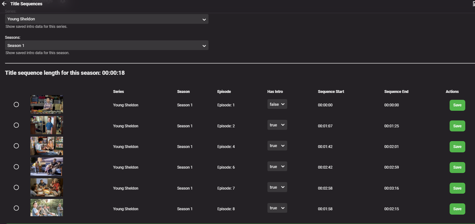

CBers 7557 Posted September 16, 2021 Posted September 16, 2021 (edited) 1 hour ago, CBers said: I'm just running "Title Sequence Detection", so should I stop it and wait for the next release? Will the plugin pick up from where it left of? No worries, the task finished in 1 hour 12 minutes. When checking the Title Sequences for my TV shows, they are all FALSE. 2021-09-16 08:24:45.092 Info Intro Skip: will process 22 episodes for Young Sheldon - Season 1. 2021-09-16 08:26:30.683 Info Intro Skip: Young Sheldon - Season 1 - Episode 2 title sequence found - detection took 4 seconds. 2021-09-16 08:26:35.161 Info Intro Skip: Young Sheldon - Season 1 - Episode 2 title sequence found - detection took 4 seconds. 2021-09-16 08:26:44.052 Info Intro Skip: Young Sheldon - Season 1 - Episode 2 title sequence found - detection took 4 seconds. 2021-09-16 08:27:02.281 Info Intro Skip: Young Sheldon - Season 1 - Episode 2 title sequence found - detection took 4 seconds. 2021-09-16 08:27:06.768 Info Intro Skip: Young Sheldon - Season 1 - Episode 2 title sequence found - detection took 4 seconds. 2021-09-16 08:27:11.216 Info Intro Skip: Young Sheldon - Season 1 - Episode 2 title sequence found - detection took 4 seconds. 2021-09-16 08:27:20.417 Info Intro Skip: Young Sheldon - Season 1 - Episode 2 title sequence found - detection took 4 seconds. 2021-09-16 08:27:29.647 Info Intro Skip: Young Sheldon - Season 1 - Episode 2 title sequence found - detection took 4 seconds. 2021-09-16 08:27:34.339 Info Intro Skip: Young Sheldon - Season 1 - Episode 2 title sequence found - detection took 4 seconds. 2021-09-16 08:27:39.080 Info Intro Skip: Young Sheldon - Season 1 - Episode 2 title sequence found - detection took 4 seconds. 2021-09-16 08:27:58.066 Info Intro Skip: Young Sheldon - Season 1 - Episode 2 title sequence found - detection took 4 seconds. 2021-09-16 08:28:25.315 Info Intro Skip: Young Sheldon - Season 1 - Episode 3 title sequence found - detection took 4 seconds. 2021-09-16 08:28:53.183 Info Intro Skip: Young Sheldon - Season 1 - Episode 4 title sequence found - detection took 4 seconds. 2021-09-16 08:28:57.863 Info Intro Skip: Young Sheldon - Season 1 - Episode 4 title sequence found - detection took 4 seconds. 2021-09-16 08:29:07.422 Info Intro Skip: Young Sheldon - Season 1 - Episode 4 title sequence found - detection took 4 seconds. 2021-09-16 08:29:17.238 Info Intro Skip: Young Sheldon - Season 1 - Episode 4 title sequence found - detection took 4 seconds. 2021-09-16 08:29:27.157 Info Intro Skip: Young Sheldon - Season 1 - Episode 4 title sequence found - detection took 4 seconds. 2021-09-16 08:30:03.750 Info Intro Skip: Young Sheldon - Season 1 - Episode 6 title sequence found - detection took 4 seconds. 2021-09-16 08:30:59.744 Info Intro Skip: Young Sheldon - Season 1 - Episode 8 title sequence found - detection took 4 seconds. 2021-09-16 08:32:12.352 Info Intro Skip: Young Sheldon S: 1 E:1 title sequence successful. 2021-09-16 08:32:16.645 Info Intro Skip: Young Sheldon S: 1 E:11 title sequence successful. 2021-09-16 08:32:20.189 Info Intro Skip: Young Sheldon S: 1 E:12 title sequence successful. 2021-09-16 08:32:23.842 Info Intro Skip: Young Sheldon S: 1 E:14 title sequence successful. 2021-09-16 08:32:27.648 Info Intro Skip: Young Sheldon S: 1 E:16 title sequence successful. 2021-09-16 08:32:31.298 Info Intro Skip: Young Sheldon S: 1 E:17 title sequence successful. 2021-09-16 08:32:35.028 Info Intro Skip: Young Sheldon S: 1 E:18 title sequence successful. 2021-09-16 08:32:38.619 Info Intro Skip: Young Sheldon S: 1 E:22 title sequence successful. 2021-09-16 08:32:41.937 Info Intro Skip: Young Sheldon S: 1 E:2 title sequence successful. 2021-09-16 08:32:48.815 Info Intro Skip: Young Sheldon S: 1 E:13 title sequence successful. 2021-09-16 08:32:56.010 Info Intro Skip: Young Sheldon S: 1 E:3 title sequence successful. 2021-09-16 08:33:03.369 Info Intro Skip: Young Sheldon S: 1 E:5 title sequence successful. 2021-09-16 08:33:07.044 Info Intro Skip: Young Sheldon S: 1 E:7 title sequence successful. 2021-09-16 08:33:14.166 Info Intro Skip: Young Sheldon S: 1 E:19 title sequence successful. 2021-09-16 08:33:21.333 Info Intro Skip: Young Sheldon S: 1 E:21 title sequence successful. 2021-09-16 08:33:28.399 Info Intro Skip: Young Sheldon S: 1 E:4 title sequence successful. 2021-09-16 08:33:34.846 Info Intro Skip: Young Sheldon S: 1 E:20 title sequence successful. 2021-09-16 08:33:42.099 Info Intro Skip: Young Sheldon S: 1 E:6 title sequence successful. 2021-09-16 08:33:48.945 Info Intro Skip: Young Sheldon S: 1 E:10 title sequence successful. 2021-09-16 08:33:55.934 Info Intro Skip: Young Sheldon S: 1 E:8 title sequence successful. 2021-09-16 08:33:59.904 Info Intro Skip: Young Sheldon S: 1 E:15 title sequence successful. 2021-09-16 08:34:04.124 Info Intro Skip: Young Sheldon S: 1 E:9 title sequence successful. 2021-09-16 08:34:08.056 Info Intro Skip: will process 22 episodes for Young Sheldon - Season 2. 2021-09-16 08:37:37.440 Info Intro Skip: Young Sheldon S: 2 E:4 title sequence successful. 2021-09-16 08:37:41.182 Info Intro Skip: Young Sheldon S: 2 E:6 title sequence successful. 2021-09-16 08:37:44.774 Info Intro Skip: Young Sheldon S: 2 E:7 title sequence successful. 2021-09-16 08:37:52.073 Info Intro Skip: Young Sheldon S: 2 E:10 title sequence successful. 2021-09-16 08:37:59.286 Info Intro Skip: Young Sheldon S: 2 E:11 title sequence successful. 2021-09-16 08:38:06.746 Info Intro Skip: Young Sheldon S: 2 E:19 title sequence successful. 2021-09-16 08:38:14.141 Info Intro Skip: Young Sheldon S: 2 E:21 title sequence successful. 2021-09-16 08:38:21.488 Info Intro Skip: Young Sheldon S: 2 E:1 title sequence successful. 2021-09-16 08:38:28.796 Info Intro Skip: Young Sheldon S: 2 E:8 title sequence successful. 2021-09-16 08:38:32.531 Info Intro Skip: Young Sheldon S: 2 E:9 title sequence successful. 2021-09-16 08:38:39.371 Info Intro Skip: Young Sheldon S: 2 E:12 title sequence successful. 2021-09-16 08:38:46.936 Info Intro Skip: Young Sheldon S: 2 E:16 title sequence successful. 2021-09-16 08:38:50.685 Info Intro Skip: Young Sheldon S: 2 E:17 title sequence successful. 2021-09-16 08:38:54.700 Info Intro Skip: Young Sheldon S: 2 E:2 title sequence successful. 2021-09-16 08:38:58.580 Info Intro Skip: Young Sheldon S: 2 E:13 title sequence successful. 2021-09-16 08:39:02.234 Info Intro Skip: Young Sheldon S: 2 E:15 title sequence successful. 2021-09-16 08:39:05.889 Info Intro Skip: Young Sheldon S: 2 E:18 title sequence successful. 2021-09-16 08:39:13.155 Info Intro Skip: Young Sheldon S: 2 E:20 title sequence successful. 2021-09-16 08:39:20.644 Info Intro Skip: Young Sheldon S: 2 E:3 title sequence successful. 2021-09-16 08:39:28.039 Info Intro Skip: Young Sheldon S: 2 E:14 title sequence successful. 2021-09-16 08:39:35.450 Info Intro Skip: Young Sheldon S: 2 E:22 title sequence successful. 2021-09-16 08:39:43.022 Info Intro Skip: Young Sheldon S: 2 E:5 title sequence successful. 2021-09-16 08:40:01.735 Info Intro Skip: will process 21 episodes for Young Sheldon - Season 3. 2021-09-16 08:44:02.048 Info Intro Skip: Young Sheldon S: 3 E:9 title sequence successful. 2021-09-16 08:44:09.485 Info Intro Skip: Young Sheldon S: 3 E:11 title sequence successful. 2021-09-16 08:44:16.774 Info Intro Skip: Young Sheldon S: 3 E:13 title sequence successful. 2021-09-16 08:44:24.101 Info Intro Skip: Young Sheldon S: 3 E:17 title sequence successful. 2021-09-16 08:44:31.287 Info Intro Skip: Young Sheldon S: 3 E:18 title sequence successful. 2021-09-16 08:44:35.072 Info Intro Skip: Young Sheldon S: 3 E:20 title sequence successful. 2021-09-16 08:44:39.185 Info Intro Skip: Young Sheldon S: 3 E:1 title sequence successful. 2021-09-16 08:44:47.346 Info Intro Skip: Young Sheldon S: 3 E:15 title sequence successful. 2021-09-16 08:44:51.387 Info Intro Skip: Young Sheldon S: 3 E:16 title sequence successful. 2021-09-16 08:44:55.987 Info Intro Skip: Young Sheldon S: 3 E:2 title sequence successful. 2021-09-16 08:45:00.418 Info Intro Skip: Young Sheldon S: 3 E:6 title sequence successful. 2021-09-16 08:45:04.853 Info Intro Skip: Young Sheldon S: 3 E:7 title sequence successful. 2021-09-16 08:45:09.162 Info Intro Skip: Young Sheldon S: 3 E:12 title sequence successful. 2021-09-16 08:45:13.484 Info Intro Skip: Young Sheldon S: 3 E:19 title sequence successful. 2021-09-16 08:45:17.842 Info Intro Skip: Young Sheldon S: 3 E:3 title sequence successful. 2021-09-16 08:45:22.204 Info Intro Skip: Young Sheldon S: 3 E:21 title sequence successful. 2021-09-16 08:45:30.855 Info Intro Skip: Young Sheldon S: 3 E:4 title sequence successful. 2021-09-16 08:45:39.286 Info Intro Skip: Young Sheldon S: 3 E:10 title sequence successful. 2021-09-16 08:45:43.957 Info Intro Skip: Young Sheldon S: 3 E:5 title sequence successful. 2021-09-16 08:45:48.722 Info Intro Skip: Young Sheldon S: 3 E:14 title sequence successful. 2021-09-16 08:45:53.579 Info Intro Skip: Young Sheldon S: 3 E:8 title sequence successful. 2021-09-16 08:46:02.865 Info Intro Skip: will process 18 episodes for Young Sheldon - Season 4. 2021-09-16 08:48:59.895 Info Intro Skip: Young Sheldon S: 4 E:8 title sequence successful. 2021-09-16 08:49:07.414 Info Intro Skip: Young Sheldon S: 4 E:9 title sequence successful. 2021-09-16 08:49:14.415 Info Intro Skip: Young Sheldon S: 4 E:11 title sequence successful. 2021-09-16 08:49:21.164 Info Intro Skip: Young Sheldon S: 4 E:17 title sequence successful. 2021-09-16 08:49:24.748 Info Intro Skip: Young Sheldon S: 4 E:1 title sequence successful. 2021-09-16 08:49:31.823 Info Intro Skip: Young Sheldon S: 4 E:6 title sequence successful. 2021-09-16 08:49:38.762 Info Intro Skip: Young Sheldon S: 4 E:10 title sequence successful. 2021-09-16 08:49:45.720 Info Intro Skip: Young Sheldon S: 4 E:14 title sequence successful. 2021-09-16 08:49:52.620 Info Intro Skip: Young Sheldon S: 4 E:16 title sequence successful. 2021-09-16 08:49:56.366 Info Intro Skip: Young Sheldon S: 4 E:2 title sequence successful. 2021-09-16 08:50:00.189 Info Intro Skip: Young Sheldon S: 4 E:13 title sequence successful. 2021-09-16 08:50:04.327 Info Intro Skip: Young Sheldon S: 4 E:15 title sequence successful. 2021-09-16 08:50:08.055 Info Intro Skip: Young Sheldon S: 4 E:18 title sequence successful. 2021-09-16 08:50:11.643 Info Intro Skip: Young Sheldon S: 4 E:3 title sequence successful. 2021-09-16 08:50:22.254 Info Intro Skip: Young Sheldon S: 4 E:7 title sequence successful. 2021-09-16 08:50:29.335 Info Intro Skip: Young Sheldon S: 4 E:4 title sequence successful. 2021-09-16 08:50:36.535 Info Intro Skip: Young Sheldon S: 4 E:12 title sequence successful. 2021-09-16 08:50:51.561 Info Intro Skip: Young Sheldon S: 4 E:5 title sequence successful. What has gone wrong? Edited September 16, 2021 by CBers

Cheesegeezer 3106 Posted September 16, 2021 Posted September 16, 2021 2 minutes ago, CBers said: I only ran the 2 Episode tasks, not the Chapter one. no probs. Is Young Sheldon intro less than 20 seconds? If so then the detection ignores it.

CBers 7557 Posted September 16, 2021 Posted September 16, 2021 (edited) 8 minutes ago, Cheesegeezer said: no probs. Is Young Sheldon intro less than 20 seconds? If so then the detection ignores it. From memory no it's not, but I can play a few just to see. It wasn't just YS, but a lot of my TC shows. Edited September 16, 2021 by CBers
