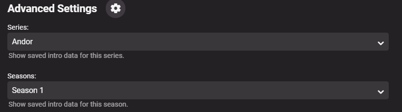

chef 3811 Posted September 15, 2021 Posted September 15, 2021 30 minutes ago, CBers said: I assume these are the initial steps required? When I open the plugin config page, it defaults to a TV show that has no seasons currently. What is the function of the Series field? Shouldn't the first option in the list be "All Shows"? Also, shouldn't the field be "Show Name", rather than "Series"? The default "Maximum parallel series to process at once" value is 2, but the text below the field says default is 4. I've deleted the schedule tasks triggers, as suggested earlier in this thread - once all completed, I will put them back. So what order do the tasks need to run in, as is on the Scheduled Tasks page? Thanks. This is great, and much appreciated. We had originally defaulted to 4 but it was too much for low powered NAS machine to run 4 at once so we changed it to 2. We have to update the UI. Thanks for catching that. The first drop down will allow you to choose a series, and the second will allow you to choose a season of that series to populate the list full of episodes. Does that not make sense when it is the first time looking at the UI? It sounds like we might need a help tab... Or something, to explain how to get results. We take it for granted because we have been working with the system for about a year, but it would make sense that a user looking at this for the time might not understand the steps to take, and what to do.
CBers 7557 Posted September 15, 2021 Posted September 15, 2021 Just now, chef said: The first drop down will allow you to choose a series, and the second will allow you to choose a season of that series to populate the list full of episodes. Does that not make sense when it is the first time looking at the UI? No, not really. I expected the process to only work against the selected TV show. Also, what order does the processing work, as it seems to have started half-way though the list of TV Show, rather than A-Z? 2021-09-15 12:40:23.255 Info Intro Skip: Chroma-print database contains 0 items. 2021-09-15 12:40:23.267 Info Intro Skip: Father Brown (2013) - Season 9 chromaprint profile is up to date. 2021-09-15 12:40:24.798 Debug Intro Skip: The Falcon and the Winter Soldier - S:1 - E:0: Extracting chunks from binary chroma-print. 2021-09-15 12:40:24.799 Debug Intro Skip: The Falcon and the Winter Soldier - S:1 - E:0: .bin file removed. 2021-09-15 12:40:24.799 Info Intro Skip: The Falcon and the Winter Soldier - S:1 - E:0: Saving. 2021-09-15 12:40:24.804 Info Intro Skip: The Falcon and the Winter Soldier - S:1 - E:0 complete - 1 seconds. 2021-09-15 12:40:25.332 Debug Intro Skip: Silent Witness - S:24 - E:4: Extracting chunks from binary chroma-print. 2021-09-15 12:40:25.336 Debug Intro Skip: Silent Witness - S:24 - E:4: .bin file removed. 2021-09-15 12:40:25.336 Info Intro Skip: Silent Witness - S:24 - E:4: Saving. 2021-09-15 12:40:25.337 Info Intro Skip: Silent Witness - S:24 - E:4 complete - 2 seconds. 2021-09-15 12:40:26.146 Debug Intro Skip: The Expanse - S:5 - E:0: Extracting chunks from binary chroma-print. 2021-09-15 12:40:26.147 Debug Intro Skip: The Expanse - S:5 - E:0: .bin file removed. 2021-09-15 12:40:26.147 Info Intro Skip: The Expanse - S:5 - E:0: Saving. 2021-09-15 12:40:26.147 Info Intro Skip: The Expanse - S:5 - E:0 complete - 1 seconds. 2021-09-15 12:40:38.319 Debug Intro Skip: Manifest - S:3 - E:1: Extracting chunks from binary chroma-print. 2021-09-15 12:40:38.327 Debug Intro Skip: Manifest - S:3 - E:1: .bin file removed. 2021-09-15 12:40:38.327 Info Intro Skip: Manifest - S:3 - E:1: Saving. 2021-09-15 12:40:38.329 Info Intro Skip: Manifest - S:3 - E:1 complete - 15 seconds. I have "Maximum parallel series to process at once" set to 4. 1
Cheesegeezer 3106 Posted September 15, 2021 Posted September 15, 2021 2 minutes ago, chef said: This is great, and much appreciated. We had originally defaulted to 4 but it was too much for low powered NAS machine to run 4 at once so we changed it to 2. We have to update the UI. Thanks for catching that. The first drop down will allow you to choose a series, and the second will allow you to choose a season of that series to populate the list full of episodes. Does that not make sense when it is the first time looking at the UI? It sounds like we might need a help tab... Or something, to explain how to get results. We take it for granted because we have been working with the system for about a year, but it would make sense that a user looking at this for the time might not understand the steps to take, and what to do. Morning Treacle!! We could just create a Help button and link to this buddy, all the hard work is done then and we can just edit this without having to keep releasing updates. 1

chef 3811 Posted September 15, 2021 Posted September 15, 2021 3 minutes ago, CBers said: No, not really. I expected the process to only work against the selected TV show. Also, what order does the processing work, as it seems to have started half-way though the list of TV Show, rather than A-Z? 2021-09-15 12:40:23.255 Info Intro Skip: Chroma-print database contains 0 items. 2021-09-15 12:40:23.267 Info Intro Skip: Father Brown (2013) - Season 9 chromaprint profile is up to date. 2021-09-15 12:40:24.798 Debug Intro Skip: The Falcon and the Winter Soldier - S:1 - E:0: Extracting chunks from binary chroma-print. 2021-09-15 12:40:24.799 Debug Intro Skip: The Falcon and the Winter Soldier - S:1 - E:0: .bin file removed. 2021-09-15 12:40:24.799 Info Intro Skip: The Falcon and the Winter Soldier - S:1 - E:0: Saving. 2021-09-15 12:40:24.804 Info Intro Skip: The Falcon and the Winter Soldier - S:1 - E:0 complete - 1 seconds. 2021-09-15 12:40:25.332 Debug Intro Skip: Silent Witness - S:24 - E:4: Extracting chunks from binary chroma-print. 2021-09-15 12:40:25.336 Debug Intro Skip: Silent Witness - S:24 - E:4: .bin file removed. 2021-09-15 12:40:25.336 Info Intro Skip: Silent Witness - S:24 - E:4: Saving. 2021-09-15 12:40:25.337 Info Intro Skip: Silent Witness - S:24 - E:4 complete - 2 seconds. 2021-09-15 12:40:26.146 Debug Intro Skip: The Expanse - S:5 - E:0: Extracting chunks from binary chroma-print. 2021-09-15 12:40:26.147 Debug Intro Skip: The Expanse - S:5 - E:0: .bin file removed. 2021-09-15 12:40:26.147 Info Intro Skip: The Expanse - S:5 - E:0: Saving. 2021-09-15 12:40:26.147 Info Intro Skip: The Expanse - S:5 - E:0 complete - 1 seconds. 2021-09-15 12:40:38.319 Debug Intro Skip: Manifest - S:3 - E:1: Extracting chunks from binary chroma-print. 2021-09-15 12:40:38.327 Debug Intro Skip: Manifest - S:3 - E:1: .bin file removed. 2021-09-15 12:40:38.327 Info Intro Skip: Manifest - S:3 - E:1: Saving. 2021-09-15 12:40:38.329 Info Intro Skip: Manifest - S:3 - E:1 complete - 15 seconds. I have "Maximum parallel series to process at once" set to 4. Currently the task will not take a sort order. When dealing with TPL (Task Parallel Library) it doesn't care which order the items are taken from a list, it only cares that it eventually takes all of them (in your case 4 at a time). We definitely need to implement a way to choose which series to scan. I can put together a tab which allows series selection. This is probably one of the most requested, and important things to add. @samuelqwe you had an idea yesterday for series selection, what was it again?

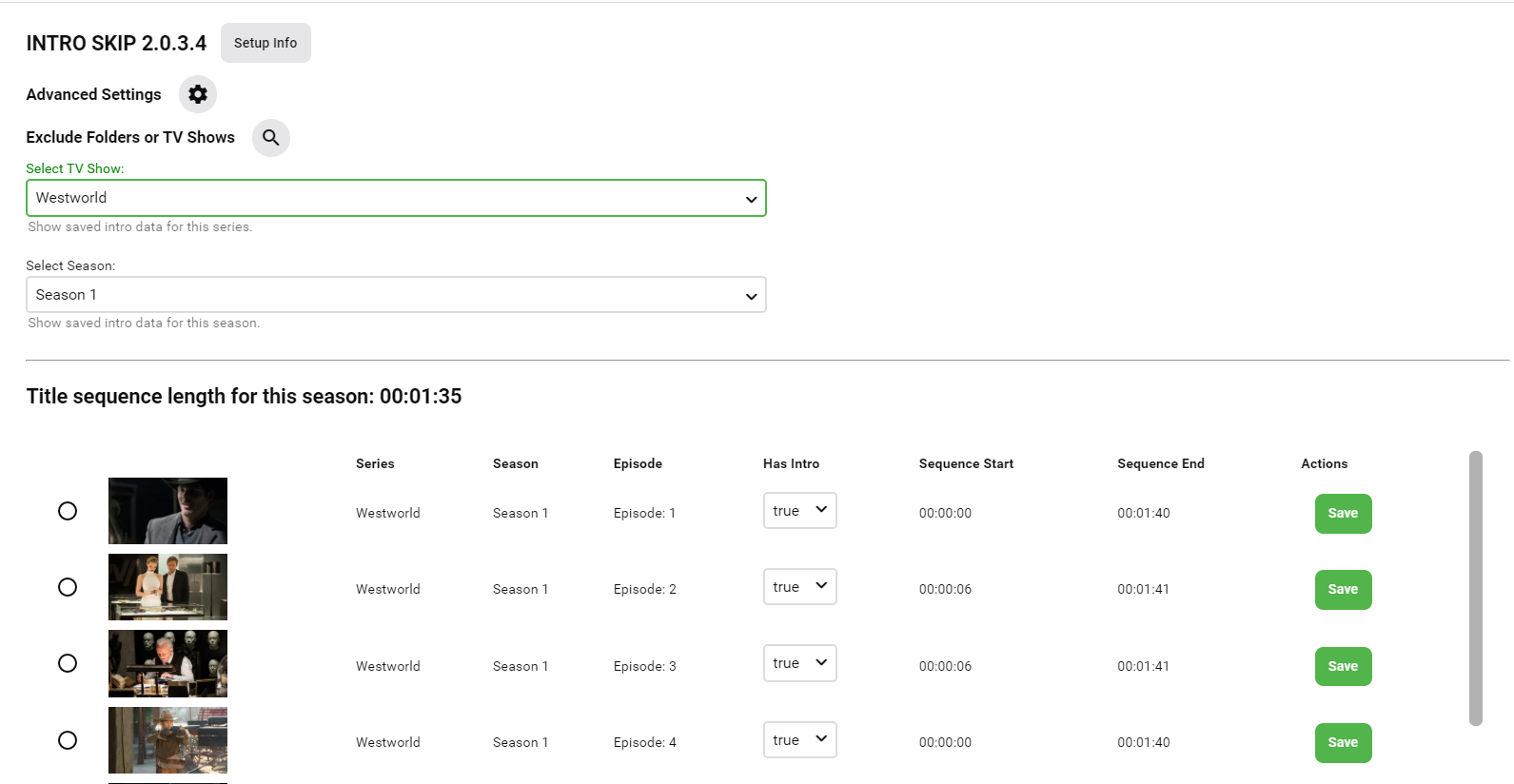

Cheesegeezer 3106 Posted September 15, 2021 Posted September 15, 2021 @chef I just threw these in.... What are your thoughts? The setup info button links to the Instructions page on the forum. The Exclude folder or TV Shows is not wired up yet and I should leave you to do your wonders with HTML and JS lol - Coz I suck at it. 1

chef 3811 Posted September 15, 2021 Posted September 15, 2021 15 minutes ago, Cheesegeezer said: @chef I just threw these in.... What are your thoughts? The setup info button links to the Instructions page on the forum. The Exclude folder or TV Shows is not wired up yet and I should leave you to do your wonders with HTML and JS lol - Coz I suck at it. Nice! What about creating tabs at the top of the page. I know how to do that. The new layout would be similar to auto organize, where the first tab would be the series selection/editing tab. The second tab could be advanced settings. Then we'd have an entire page to handle/add settings and we wouldn't be limited to the size of a modal. The advanced tab could handle series selection, and the elements we have already in the modal. What about that? 2
Cheesegeezer 3106 Posted September 15, 2021 Posted September 15, 2021 18 minutes ago, chef said: Nice! What about creating tabs at the top of the page. I know how to do that. The new layout would be similar to auto organize, where the first tab would be the series selection/editing tab. The second tab could be advanced settings. Then we'd have an entire page to handle/add settings and we wouldn't be limited to the size of a modal. The advanced tab could handle series selection, and the elements we have already in the modal. What about that? I like that!!! using the Auto Organise Layout with Tabs at the top would provide a very nice clean and full experience to the user. 1

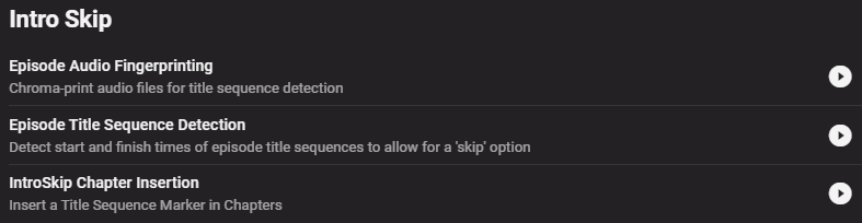

CBers 7557 Posted September 15, 2021 Posted September 15, 2021 1 hour ago, chef said: Currently the task will not take a sort order So how does it start the processing on a completely new system then? You must have programmed the order? Just curious.
Cheesegeezer 3106 Posted September 15, 2021 Posted September 15, 2021 24 minutes ago, Micael456 said: Happy to turn on debug and provide any logs, just don't think there's much in there. I'm running Ubuntu, is there anything I can enable at the OS level to monitor the embyserver process and provide more useful stats? I think some screenshots prior to the detection process of cpu and memory usage for emby to show idle state demand, then running the process with some more screenshots at various points from emby usage. I don't know Ubuntu at all so pretty useless for info on best ways.
Cheesegeezer 3106 Posted September 15, 2021 Posted September 15, 2021 (edited) 6 minutes ago, CBers said: So how does it start the processing on a completely new system then? VOODOO MAGIC MAN!! Edited September 15, 2021 by Cheesegeezer 1
chef 3811 Posted September 15, 2021 Posted September 15, 2021 (edited) 1 hour ago, CBers said: So how does it start the processing on a completely new system then? You must have programmed the order? Just curious. Fingerprinting first. Title sequence Detection second. It currently scans everything TV show releated. Edited September 15, 2021 by chef
