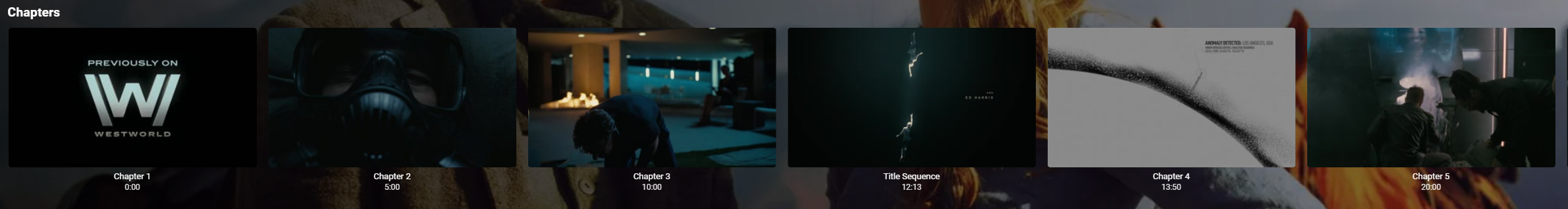

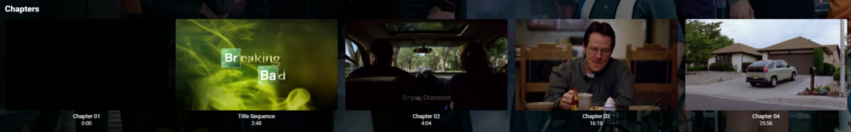

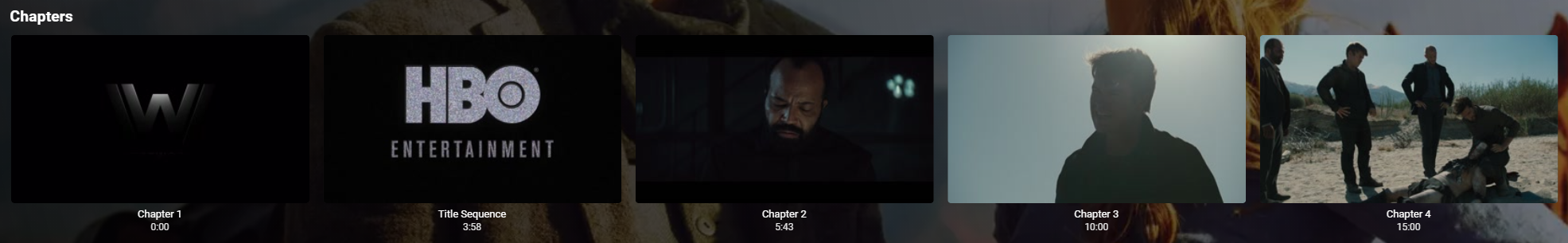

rbjtech 5345 Posted September 13, 2021 Posted September 13, 2021 While we wait for the outcome on the real 'Intro Skip' button - the 'Title Sequence' being inserted into the existing chapters is working well. There are a couple of issues still to resolve, but the majority of my test shows had perfect placement of the sequence. Some examples below - 1. 'Title Sequence' added for episodes with 'Real' chapters. Original chapter points are untouched. 2. 'Title Sequence' added for episodes with 'Auto' chapters. Auto chapter points are trimmed accordingly, resorting back to the Original 5 minute chapters after. 3. 'Title Sequence' added late into the show (after Chapter 3).. again, Original chapter points are untouched. 4
chef 3811 Posted September 13, 2021 Posted September 13, 2021 2 hours ago, rbjtech said: While we wait for the outcome on the real 'Intro Skip' button - the 'Title Sequence' being inserted into the existing chapters is working well. There are a couple of issues still to resolve, but the majority of my test shows had perfect placement of the sequence. Some examples below - 1. 'Title Sequence' added for episodes with 'Real' chapters. Original chapter points are untouched. 2. 'Title Sequence' added for episodes with 'Auto' chapters. Auto chapter points are trimmed accordingly, resorting back to the Original 5 minute chapters after. 3. 'Title Sequence' added late into the show (after Chapter 3).. again, Original chapter points are untouched. That is super cool! Man, we did that guys! Congratulations to us all for a good job! Seriously cool stuff there. It is unique to emby, which makes it good, even if we get some imprecise results, the bulk of it is good. 5 1

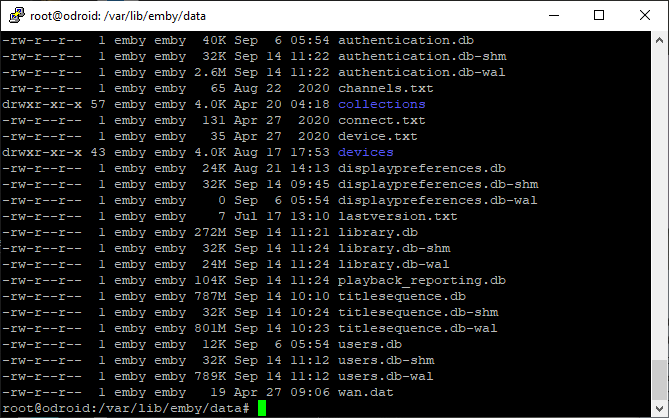

Micael456 45 Posted September 14, 2021 Posted September 14, 2021 2 hours ago, Cheesegeezer said: wait for next release. I would uninstall the plugin for now. Yeah I had to do that already. 2 hours ago, Cheesegeezer said: specs are and OS Odroid N2 (https://www.hardkernel.com/shop/odroid-n2-with-4gbyte-ram/) running Ubuntu 18.04 LTS. Boots from an A2 SD card. 2 hours ago, rbjtech said: Detection (the second task) Second task. If you recall, the first one had some speed issues for me, but that's more of a case of balancing the concurrent threads. The second task just straight up causes the process to terminate at some point, no more emby.
rbjtech 5345 Posted September 14, 2021 Posted September 14, 2021 1 minute ago, Micael456 said: Second task. If you recall, the first one had some speed issues for me, but that's more of a case of balancing the concurrent threads. The second task just straight up causes the process to terminate at some point, no more emby. ok thanks - so if it's the second task, then I believe the size of the dB may have a big impact - especially as your system only has 4Gb RAM overall - how big is the titlesequence.db file - in <emby root>/programdata/data ? When you run the task - does it instantly crash or does memory rapidly shoot up and then crash ?
Micael456 45 Posted September 14, 2021 Posted September 14, 2021 6 minutes ago, rbjtech said: ok thanks - so if it's the second task, then I believe the size of the dB may have a big impact - especially as your system only has 4Gb RAM overall - how big is the titlesequence.db file - in <emby root>/programdata/data ? When you run the task - does it instantly crash or does memory rapidly shoot up and then crash ? It's actually in /var/lib/emby/data on Linux? ~787MB though.
chef 3811 Posted September 14, 2021 Posted September 14, 2021 2 hours ago, Cheesegeezer said: I don't know how to do this. These are our only options public interface ILogger { void Debug(string message, params object[] paramList); void Debug(ReadOnlyMemory<char> message); void Error(string message, params object[] paramList); void Error(ReadOnlyMemory<char> message); void ErrorException(string message, Exception exception, params object[] paramList); void Fatal(string message, params object[] paramList); void FatalException(string message, Exception exception, params object[] paramList); void Info(string message, params object[] paramList); void Info(ReadOnlyMemory<char> message); void Log(LogSeverity severity, string message, params object[] paramList); void Log(LogSeverity severity, ReadOnlyMemory<char> message); void LogMultiline(string message, LogSeverity severity, StringBuilder additionalContent); void Warn(string message, params object[] paramList); void Warn(ReadOnlyMemory<char> message); @Cheesegeezer, when you create the log. Send in (ILogManager logManager). Then in the constructor use: 'ILogger Log = logManager.GetLogger(Plugin.Instance.Name)' This will use the name in the log entry 2
rbjtech 5345 Posted September 14, 2021 Posted September 14, 2021 7 minutes ago, Micael456 said: It's actually in /var/lib/emby/data on Linux? ~787MB though. ok - so reasonably big. When you run the task - does it instantly crash or does memory rapidly shoot up and then crash ? How much memory do you have 'free' ? The reason I'm going down this route is in the early days of the Plugin, @chef was loading the entire dB into memory to do the query .. .. thus if you did not have that memory free - then things would grind to a halt as it needed to page memory to disk. However, the query was changed to only query the relevant show - thus significantly reducing the dB memory overhead. So I'm wondering if your issue and this are somehow linked.. ?
chef 3811 Posted September 14, 2021 Posted September 14, 2021 2 minutes ago, rbjtech said: ok - so reasonably big. When you run the task - does it instantly crash or does memory rapidly shoot up and then crash ? How much memory do you have 'free' ? The reason I'm going down this route is in the early days of the Plugin, @chef was loading the entire dB into memory to do the query .. .. thus if you did not have that memory free - then things would grind to a halt as it needed to page memory to disk. However, the query was changed to only query the relevant show - thus significantly reducing the dB memory overhead. So I'm wondering if your issue and this are somehow linked.. ? Which version are you on @Micael456? I think Dave and I have something new today. Let's see what happens today, and if we still see high memory usage like that, then @rbjtech is right, we have no choice but to snag a season, process it fully and move on. But that will mean writing a hefty rework of the two main tasks. 1
