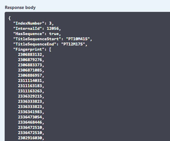

chef 3811 Posted September 13, 2021 Posted September 13, 2021 (edited) Darn I have to go to work! Here is the GetEpisodeTitleSequence return data: { "IndexNumber": 1, "InternalId": 40, "HasSequence": true, "TitleSequenceStart": "PT1M57S", "TitleSequenceEnd": "PT2M27S", "SeriesId": 5, "SeasonId": 29 } I'll have to write a query for a season Result of BaseTitleSequence when I get home. I'll also have to get all sync'd properly in my solution. It shouldn't be to difficult to write the Base for season Data. I wish I could code longer today... Darn! Edited September 13, 2021 by chef 1

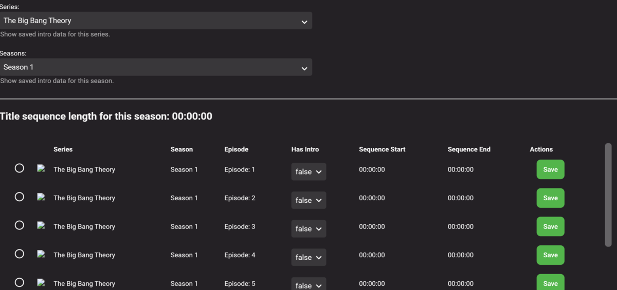

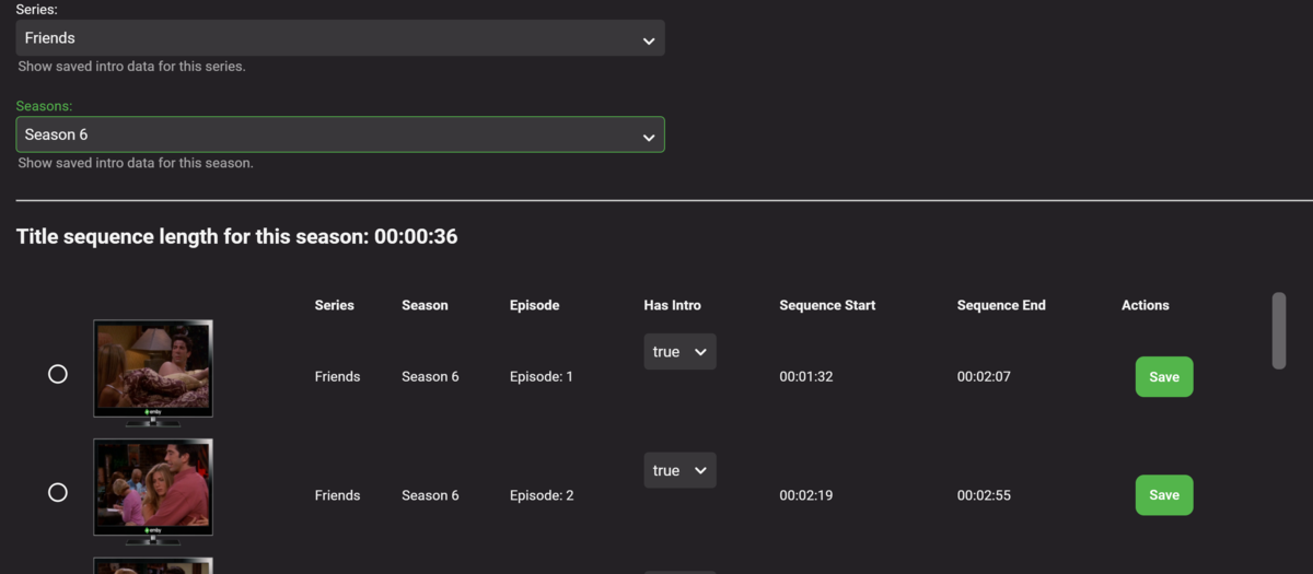

Sammy 791 Posted September 13, 2021 Posted September 13, 2021 IDK what version you guys are at but I'm on .2.9. After nearly two days here's some results. Do you need anything else? I know there's some re-caps in Season 6 that I have and the intro sequence is shorter: Not the only show with failure to detect but it seems to not have worked for The Big Bang Theory.
chef 3811 Posted September 13, 2021 Posted September 13, 2021 1 minute ago, Sammy said: IDK what version you guys are at but I'm on .2.9. After nearly two days here's some results. Do you need anything else? I know there's some re-caps in Season 6 that I have and the intro sequence is shorter: Not the only show with failure to detect but it seems to not have worked for The Big Bang Theory. Sammy your the man. Try pressing the removing season. Data button, then run the task again. See if it will It pick up BBT. 1
Cheesegeezer 3106 Posted September 13, 2021 Posted September 13, 2021 @chef I loaded up the dll and everything is broken for me. and I don't know where to start. I can see that the only thing changed is the repo here for me in the chapterEntry and Chapter Task. ITitleSequenceRepository repo = IntroSkipPluginEntryPoint.Instance.Repository;
Cheesegeezer 3106 Posted September 13, 2021 Posted September 13, 2021 37 minutes ago, Sammy said: IDK what version you guys are at but I'm on .2.9. After nearly two days here's some results. Do you need anything else? I know there's some re-caps in Season 6 that I have and the intro sequence is shorter: Not the only show with failure to detect but it seems to not have worked for The Big Bang Theory. Thanks sammy how long is the Big Bang theory intro? I think if it's less than 20secs it's ignored. I had Arrow and The Boys which are about 5 secs long so is not processed during detection. What is your feelings on the accuracy of the detection. As i have stated previously, i'm sure that the encoding is the real issue and not the detection of the plugin that throws inaccuracies. 1
crusher11 1145 Posted September 13, 2021 Posted September 13, 2021 Big Bang Theory worked fine for me, intro is 22-25 seconds depending on the season. Which indicates it's a bit fuzzy about the edges, as they should all be identical, but it's getting the bulk of it. 1

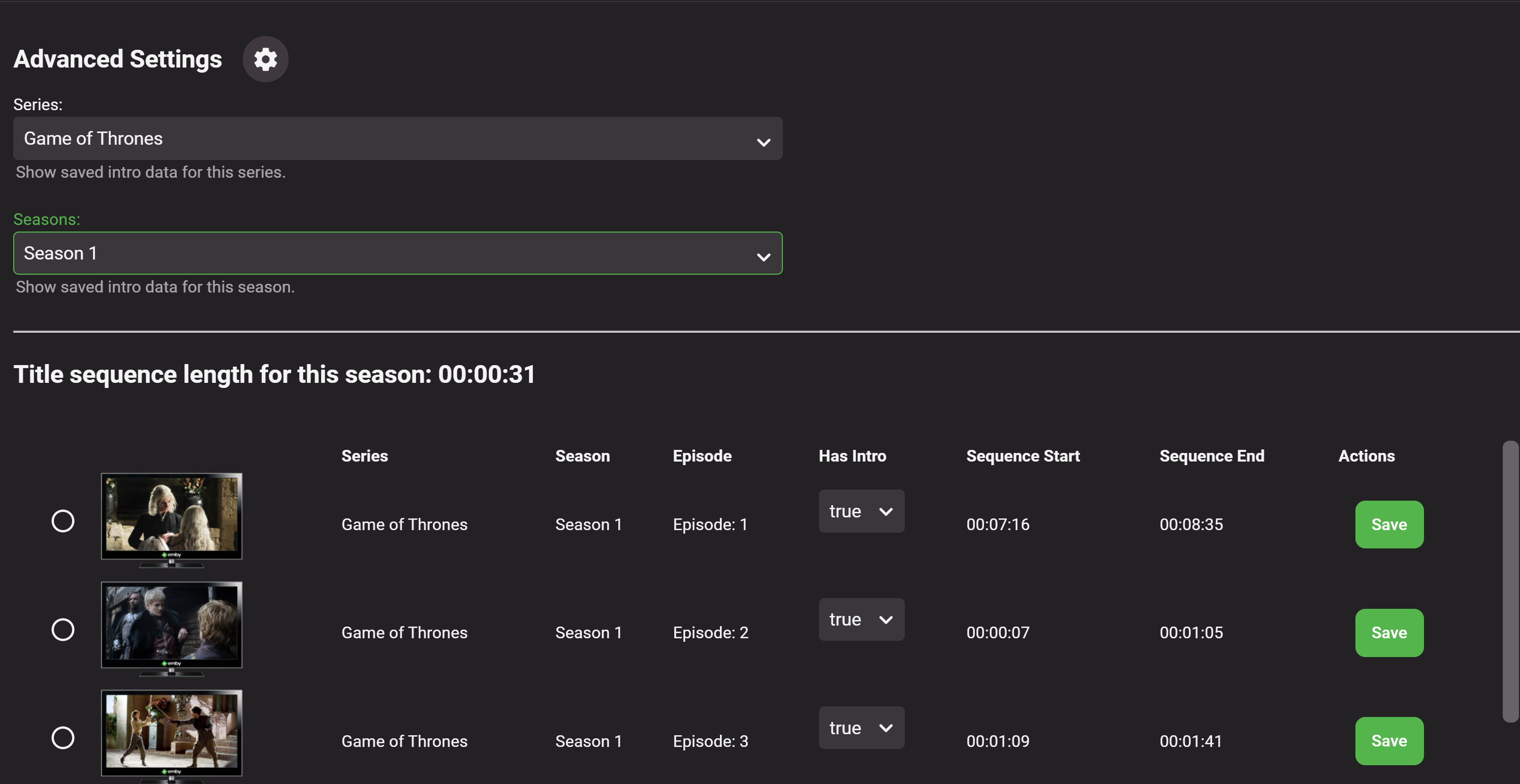

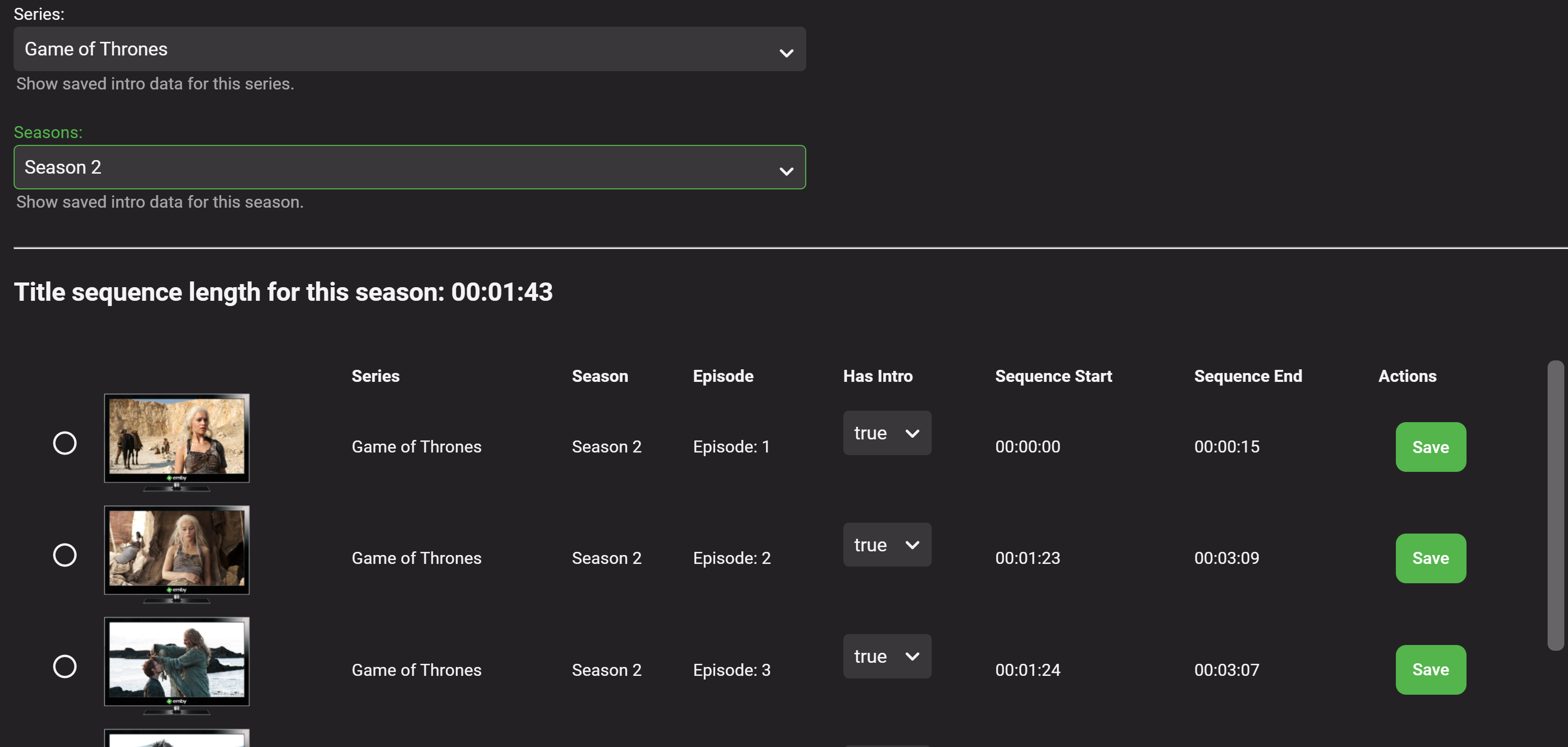

Sammy 791 Posted September 13, 2021 Posted September 13, 2021 42 minutes ago, chef said: Sammy your the man. Try pressing the removing season. Data button, then run the task again. See if it will It pick up BBT. I will do that. Does it only scan new entries after this? BTW, take a look at the GoT results. I got results but they don't look quite right. Is what I'm getting consistent with what others are seeing?
Sammy 791 Posted September 13, 2021 Posted September 13, 2021 7 minutes ago, Cheesegeezer said: Thanks sammy how long is the Big Bang theory intro? I think if it's less than 20secs it's ignored. I had Arrow and The Boys which are about 5 secs long so is not processed during detection. What is your feelings on the accuracy of the detection. As i have stated previously, i'm sure that the encoding is the real issue and not the detection of the plugin that throws inaccuracies. I'm not sue if GoT is being detected properly. See my comment to @chef above.
