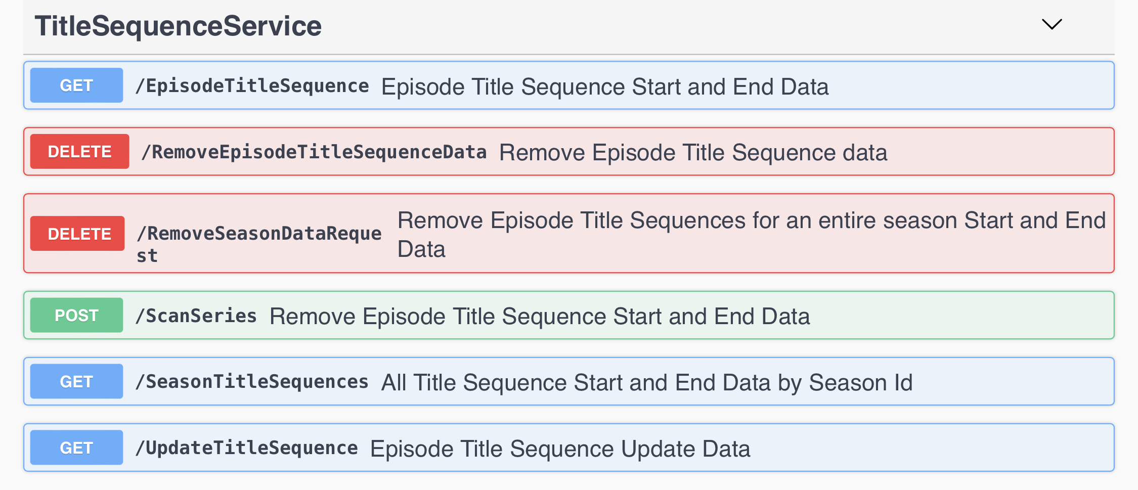

rbjtech 5345 Posted September 10, 2021 Posted September 10, 2021 9 minutes ago, chef said: You guys know that there is API endpoints for all the sequence data right? If you open the swagger, you can test it out. Just wanted to make sure that was clear. Not 100% sure what you mean by 'sequence' data ? Are you saying there is a new API function to lookup data in the IntrodB ? If yes, what's it called as I can't see anything new listed ?
Cheesegeezer 3106 Posted September 10, 2021 Posted September 10, 2021 13 minutes ago, rbjtech said: One to add - Could you change the log Class for the Chapter Insertion to use 'IntroSkip' instead of App - then we keep all the logging together Ahhh yeah sure, if i can remember how to do it lol 1
samuelqwe 317 Posted September 10, 2021 Posted September 10, 2021 8 minutes ago, rbjtech said: Not 100% sure what you mean by 'sequence' data ? Are you saying there is a new API function to lookup data in the IntrodB ? If yes, what's it called as I can't see anything new listed ? By sequence, he means intros. It’s not new, but there have been API endpoints to lookup the intro data for quite a while now. 1
crusher11 1145 Posted September 10, 2021 Posted September 10, 2021 4 hours ago, chef said: One of the things we as a community need to do, is audit the data. It was something that I've always said needs to happen. Just get a rough idea of how many episodes were right in a season, and how many needed the users attention. For the season you mentioned it sounds like a couple of the episodes were wrong, most of the others that had acceptable data. Overall it worked. Is that a fair statement? Well it failed on two episodes and there are only six episodes in the season, so that's a fairly high failure percentage but a fairly low total number of failures. All other seasons, which have an identical intro to the problem season, are fine. So I'm not sure what trips up those two episodes.
rbjtech 5345 Posted September 10, 2021 Posted September 10, 2021 4 minutes ago, samuelqwe said: By sequence, he means intros. It’s not new, but there have been API endpoints to lookup the intro data for quite a while now. Cool ! - I wasn''t aware of this .. Thanks for explaining @samuelqwe { "IndexNumber": 2, "InternalId": 1082, "HasSequence": true, "TitleSequenceStart": "PT3M49S", "TitleSequenceEnd": "PT5M13S", "Duration": 20, "SeriesId": 1078, "SeasonId": 1079, "Confirmed": false, "Processed": true } 1
Cheesegeezer 3106 Posted September 10, 2021 Posted September 10, 2021 1 hour ago, rbjtech said: Cool ! - I wasn''t aware of this .. Thanks for explaining @samuelqwe { "IndexNumber": 2, "InternalId": 1082, "HasSequence": true, "TitleSequenceStart": "PT3M49S", "TitleSequenceEnd": "PT5M13S", "Duration": 20, "SeriesId": 1078, "SeasonId": 1079, "Confirmed": false, "Processed": true } This is from IntroSkip code public class TitleSequenceResult { public int? IndexNumber { get; set; } public long InternalId { get; set; } public bool HasSequence { get; set; } = false; public TimeSpan TitleSequenceStart { get; set; } public TimeSpan TitleSequenceEnd { get; set; } public List<uint> Fingerprint {get; set;} public double Duration { get; set; } public long SeriesId { get; set; } public long SeasonId { get; set; } public bool Confirmed { get; set; } public bool Processed { get; set; } = false; } I'm about to test the plugin on my main library once the detection finishes. In my test version it will also test the automatic chapter image extraction as well, so lets see how that goes. At least the finger printing and detection will already be done. Thanks for the roadmap list also mate!! 1
Cheesegeezer 3106 Posted September 10, 2021 Posted September 10, 2021 (edited) 3 hours ago, rbjtech said: Latest updates below - Amazing work from @chef and @Cheesegeezer to get #5 out the door so quickly. (added Required Version Number - as development is happening fast, many testers are on older versions..) # Item Description Stage Latest Update Version Required Needs Core Updates ? ETA 1 FingerPrint(Chroma) Creates a template based on a percentage of the Audio runtime. Ready More efficient use of dB but good enough for release when used with scheduler 2.0.2.8 No Complete 2 Detection Detects the 'repeating Audio' vs other episodes and calculates the IntroStart and IntroEnd Ready Possibly more accuracy but certainly good enough at the moment with 90-95% 2.0.2.8 No Complete 3 Schedule Due to the Detection needing the FP database, a schedule needs to be run to ensure the data is available. Ready but needs work Working now but needs manual config 2.0.2.8 No ? 4 Scaling Depending on library size, these tasks can take days, even weeks - so it's important it's broken into manageable chunks. Ready but needs work Needs more testing on low powered NAS devices 2.0.2.8 No ? 5 Manual Skip The IntroStart/IntroEnd can be added into the existing chapter points without needing Core development work Testing 2.0.2.9 No Complete 6 IntroSkip - Manual Detection of an 'IntroStart/IntroEnd (in emby Chapters?) should bring a 'Skip Intro?' button to the front of the playback screen. Design Yes ? 7 IntroSkip - Auto Assuming accuracy is good enough, then #6 could also be automatic if given the option. Concept Yes ? 8 Community dB A community dB of existing IntroStart/End points Concept No ? 9 Specials Handling of Special Episodes - both In Season and Out of Season Concept No ? 10 Meta-Data Refresh What happens when Metadata is refreshed - do we keep chapter points ? Design No ? 11 External chapter file Write all chapters (incl new Intro) to an external XML or Text File Concept No ? ? Point 8 is a nice touch, but needs to be iron clad. I had a lot of issues when writing the MBChapters plugin, where I tried use as many variables as possible to get a match and even then it would fall short on some movie titles. Point 9 - I'll let chef decide on this. it would need to compare against a known fingerprint and use that to detect the intro in the special.. But it is definitely not high on the priority list. Point 10 - needs to just be an option for the user in config.... should be easy to code in. Point 11 - External Chapter file - What is the purpose of this? XML is nice to work with in C#, but we have a database and it would be good to keep it inside Emby so that other media platforms can't use our hard work. Thanks for updating this, very much appreciated. I'll look at point 10. I will also look at creating playbackprogress markers that flag when the intro starts and ends and create some public accessors that the devs can just use. Edited September 10, 2021 by Cheesegeezer
chef 3811 Posted September 10, 2021 Posted September 10, 2021 1 hour ago, rbjtech said: Cool ! - I wasn''t aware of this .. Thanks for explaining @samuelqwe { "IndexNumber": 2, "InternalId": 1082, "HasSequence": true, "TitleSequenceStart": "PT3M49S", "TitleSequenceEnd": "PT5M13S", "Duration": 20, "SeriesId": 1078, "SeasonId": 1079, "Confirmed": false, "Processed": true } It's how the client can request information to show the skip button, and know where to skip to in the stream.
