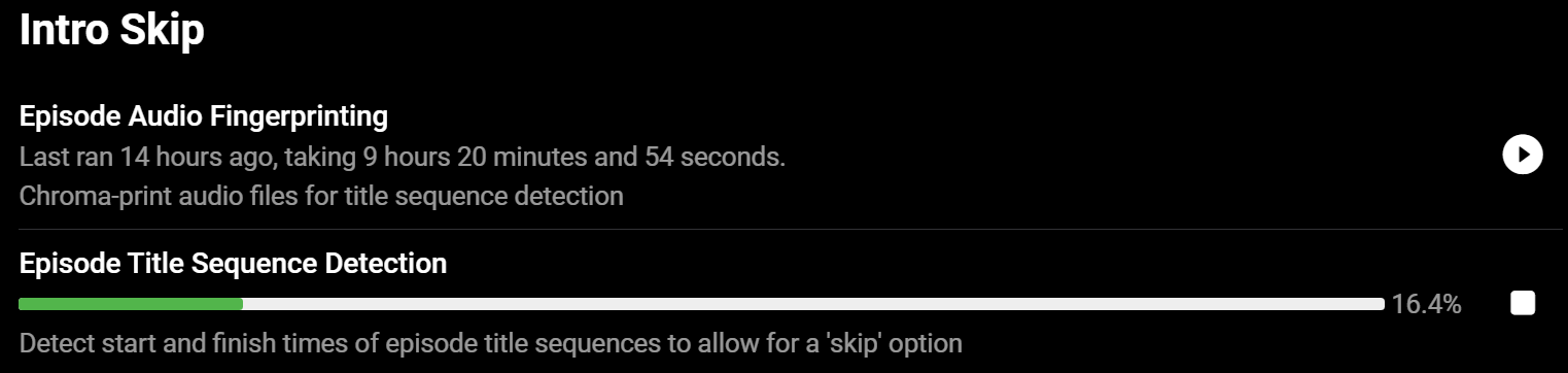

Cheesegeezer 3106 Posted September 10, 2021 Posted September 10, 2021 9 minutes ago, rbjtech said: Run on a large library, and you'll see what I mean .. Just running the FP now on my Main Server and only have 77 TV Shows, dunno how many episodes, but after 1hr of running the task i'm 29% in. I would say I have a small library lol

rbjtech 5345 Posted September 10, 2021 Posted September 10, 2021 (edited) Latest updates below - Amazing work from @chef and @Cheesegeezer to get #5 out the door so quickly. (added Required Version Number - as development is happening fast, many testers are on older versions..) # Item Description Stage Latest Update Version Required Needs Core Updates ? ETA 1 FingerPrint(Chroma) Creates a template based on a percentage of the Audio runtime. Ready More efficient use of dB but good enough for release when used with scheduler 2.0.2.8 No Complete 2 Detection Detects the 'repeating Audio' vs other episodes and calculates the IntroStart and IntroEnd Ready Possibly more accuracy but certainly good enough at the moment with 90-95% 2.0.2.8 No Complete 3 Schedule Due to the Detection needing the FP database, a schedule needs to be run to ensure the data is available. Ready but needs work Working now but needs manual config 2.0.2.8 No ? 4 Scaling Depending on library size, these tasks can take days, even weeks - so it's important it's broken into manageable chunks. Ready but needs work Needs more testing on low powered NAS devices 2.0.2.8 No ? 5 Manual Skip The IntroStart/IntroEnd can be added into the existing chapter points without needing Core development work Testing 2.0.2.9 No Complete 6 IntroSkip - Manual Detection of an 'IntroStart/IntroEnd (in emby Chapters?) should bring a 'Skip Intro?' button to the front of the playback screen. Design Yes ? 7 IntroSkip - Auto Assuming accuracy is good enough, then #6 could also be automatic if given the option. Concept Yes ? 8 Community dB A community dB of existing IntroStart/End points Concept No ? 9 Specials Handling of Special Episodes - both In Season and Out of Season Concept No ? 10 Meta-Data Refresh What happens when Metadata is refreshed - do we keep chapter points ? Design No ? 11 External chapter file Write all chapters (incl new Intro) to an external XML or Text File Concept No ? ? Edited September 10, 2021 by rbjtech 1
