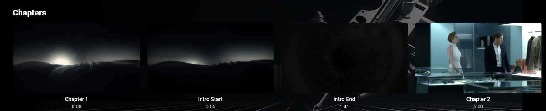

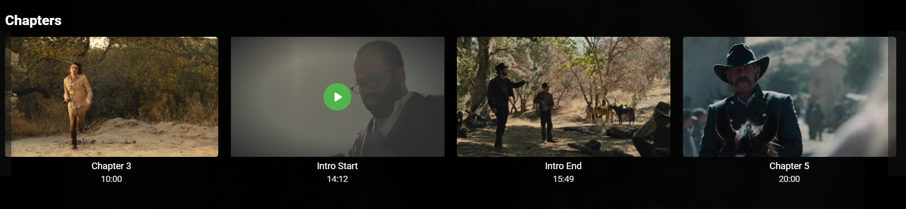

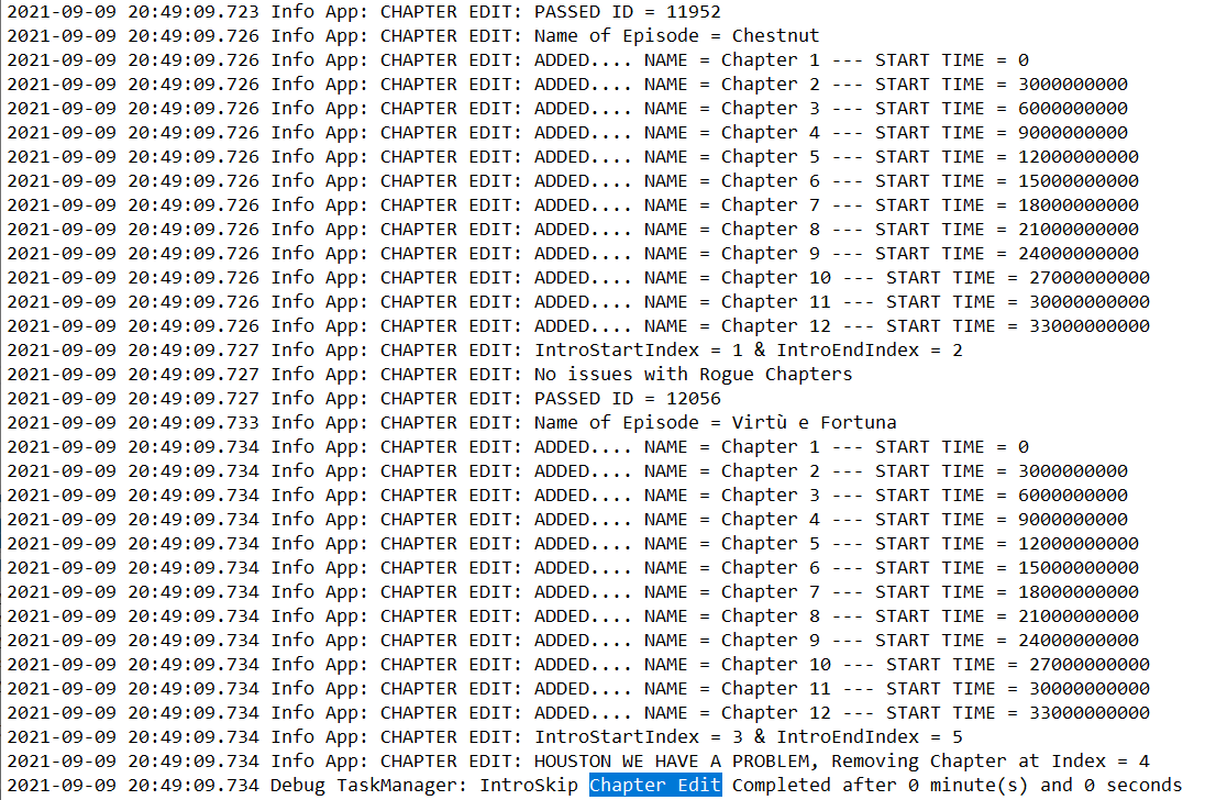

Micael456 45 Posted September 9, 2021 Posted September 9, 2021 4 minutes ago, Cheesegeezer said: So you can see below that the standard Emby 5min markers fall inbetween the start and end of the intro. I need to capture this and move chapter 4 outside to keep consistency, this will ensure that chapter fluidity is maintained. As I said earlier.... this is next on the list and i'll tackle it tomorrow as I've got a poker night to get ready for hehe Got it, that makes sense now. So just bump Chapter 4 to the other side and all good. Not sure if you were reading a while back, but we were discussing what happens if metadata was refreshed or the file is changed. Just something to bear in mind we may have to also remove those inserts ;). Anyway, thanks for explaining :). And enjoy your poker night!

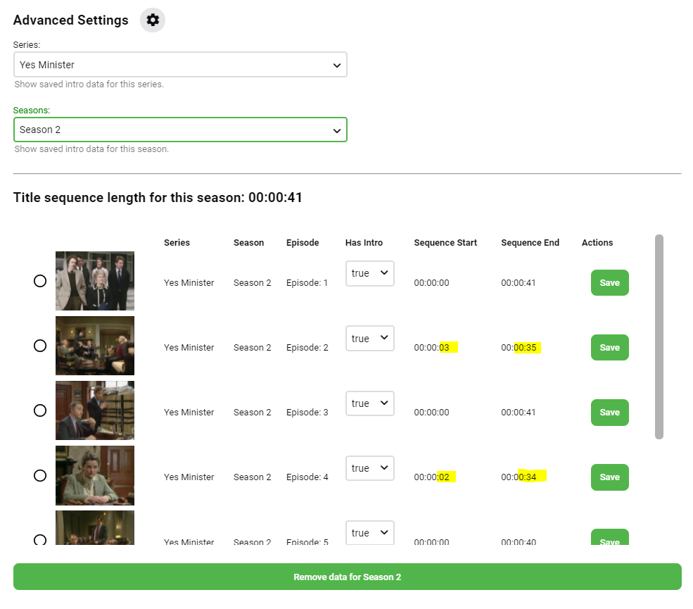

crusher11 1145 Posted September 9, 2021 Posted September 9, 2021 Episodes two and four of the second season of Yes, Minister have horribly miscalculated intro times. Nothing stands out as a potential reason if I watch them back. All intros should start at 00:00 and end at roughly 00:42. The two episodes in question have detected intros that start at 00:13 and 00:14, and end at 00:37 and 00:38.
rbjtech 5345 Posted September 9, 2021 Posted September 9, 2021 (edited) 20 minutes ago, crusher11 said: Episodes two and four of the second season of Yes, Minister have horribly miscalculated intro times. Nothing stands out as a potential reason if I watch them back. All intros should start at 00:00 and end at roughly 00:42. The two episodes in question have detected intros that start at 00:13 and 00:14, and end at 00:37 and 00:38. Thanks - let me see if I can recreate this one too - for the previous example, mine did not have the issues. brb. edit - so I can reproduce this one. Just looking into the possible reasons .. Edited September 9, 2021 by rbjtech

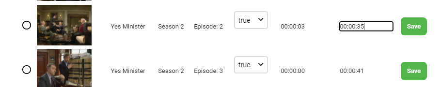

rbjtech 5345 Posted September 9, 2021 Posted September 9, 2021 @crusher11 - Hmm, very odd. I've wiped the data and tried again - same result. But listening to the Intro's from those episodes, they appear exactly the same. It's not obvious, but you can click on the time and edit it to what you want (00:00:41 in our case) but clearly you would not really want to be doing that for lots of episodes. @chef - is this just 'one of those things in the accuracy of the technology' or can the bin files be used to see what is going on here ? My filtered log is below, but I don't believe it will show us much.. yes.txt
crusher11 1145 Posted September 9, 2021 Posted September 9, 2021 I'm aware that they can be edited (although the delete and arrow keys don't work, so it's a pain in the ass to do so), but it does seem to indicate an issue with the detection.
crusher11 1145 Posted September 9, 2021 Posted September 9, 2021 @rbjtech Just saw your earlier edit. Those are out, but not by as much as mine. Not even close.
chef 3811 Posted September 9, 2021 Posted September 9, 2021 (edited) Does the intro start with any kind of strange audio? Maybe audio doesn't start in the sequence until 3 seconds into the intro? I fixed the delete button, I'll put it up when I get home. If you press delete, it does work, but the UI doesn't get updated, so you'd have to refresh the browser. Edited September 9, 2021 by chef
crusher11 1145 Posted September 9, 2021 Posted September 9, 2021 @chef I mean the delete key on the keyboard, when editing the time codes. It doesn't do anything, only backspace works to delete characters. Pressing the left or right arrow keys causes focus to be removed from the text entry completely. So you have to constantly click in exactly the right place if you want to tweak something.

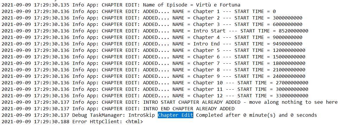

Cheesegeezer 3106 Posted September 9, 2021 Posted September 9, 2021 (edited) So Poker was cancelled tonight which is a shame, but it means i get a bit more time behind the laptop. I've done a little bit more work on the Chapters and it's working pretty good now. I don't know if we need to think of renaming the emby generated chapter numbers after removing the rogue one. We can see in the log below, I picked a good one and a bad one(a chapter was inbetween the introstart and introend) Episode: ChestNut Episode: Virtù e Fortuna Edited September 9, 2021 by Cheesegeezer 1

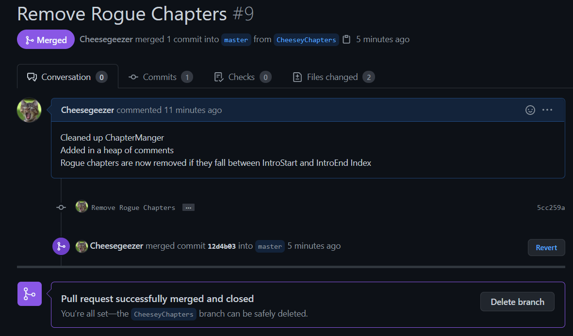

Cheesegeezer 3106 Posted September 9, 2021 Posted September 9, 2021 @chef I have just merged the latest to the master to remove Rogue chapters. 1

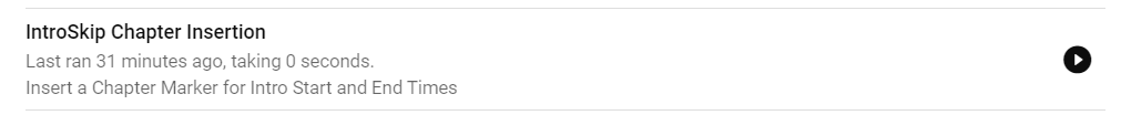

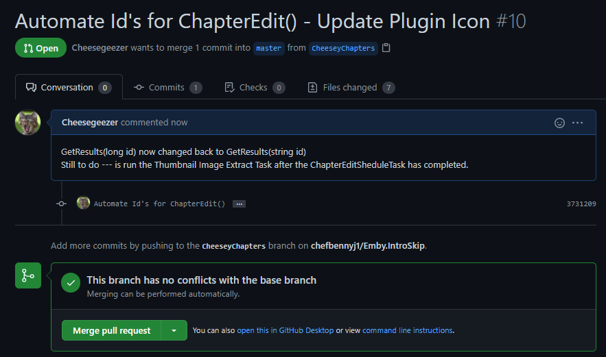

Cheesegeezer 3106 Posted September 10, 2021 Posted September 10, 2021 (edited) @chef @rbjtech @ebr @Luke Anyone know how to trigger another Scheduled Task in code. I can't seem to find the task in Emby for running the ThumbnailImageExtract Task. It used to be here... Emby/Emby.Server.Implementations/ScheduledTasks/ChapterImagesTask.cs / Chapters is pretty much complete. Chef I have switched the GetResult(string id) back now in my code and can pass the Episode Id to the ChapterEdit Method, so when running the Chapter Insertion Task, it will ONLY select your sequenced episodes to process. You will have to then run the thumbnailImageExtract task after running the chapter Insertion task I have just done a full test on my small Test library and everything is working as expected. Attached is 2.0.2.9 This build has been set as a pull request in Git, I'll let you check it and merge the request. You may also notice a new design for the Plugin Icon -- Sorry chef the old one just looked like it was from an 80's video game lol IntroSkip 2.0.2.9.zip Edited September 10, 2021 by Cheesegeezer 3
