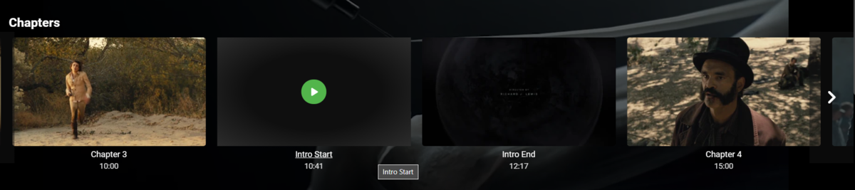

Cheesegeezer 3106 Posted September 9, 2021 Posted September 9, 2021 1 minute ago, chef said: Yeah, I wouldn't automatically assume anything when it comes to the data. We shouldn't automatically mess with peoples chapters. They need time to edit the results in the UI table. We'll have a button in the UI they can press if they are satisfied with the results we are producing, and that will edit chapters for them. Exactly but I'm just testing at the moment 1
Cheesegeezer 3106 Posted September 9, 2021 Posted September 9, 2021 1 minute ago, rbjtech said: Yep - because 12:13 takes it in-between Chapter 3 (10:00) and 4 (15:00) ... It's already a mine field at the moment. hahaha but progress none the less 1
chef 3811 Posted September 9, 2021 Posted September 9, 2021 (edited) 55 minutes ago, rbjtech said: Yep - because 12:13 takes it in-between Chapter 3 (10:00) and 4 (15:00) ... right, this is why I would push all chapters a head the sequence duration, until we hit runtime. Edited September 9, 2021 by chef
rbjtech 5345 Posted September 9, 2021 Posted September 9, 2021 2 minutes ago, chef said: Where is the actual intro start on that episode? Did we get any of it right? the end? For my system, everything is correct - all seasons all episodes. I was just trying to reproduce the issues @Cheesegeezer has with s1e2 and s1e6. 1
rbjtech 5345 Posted September 9, 2021 Posted September 9, 2021 1 minute ago, chef said: right, this is why I would push all chapter durations a head the sequence duration, until we hit runtime. Why ? We just use the logic previously listed - We insert Intro after Chapter 3. We need to extend chapter Chapter 3 to end at 12:13 (the Start of the Intro) and modify Chapter 4 to Start at the end of the Intro. (13:50) ? 1
Cheesegeezer 3106 Posted September 9, 2021 Posted September 9, 2021 2 minutes ago, rbjtech said: Why ? We just use the logic previously listed - We insert Intro after Chapter 3. We need to extend chapter Chapter 3 to end at 12:13 (the Start of the Intro) and modify Chapter 4 to Start at the end of the Intro. (13:50) ? exactly, the introstart and end times are the chapter entry points, so we just need to check if the next chapter starts before the end time and adjust accordingly. I made that sound really simple but coding it isn't gonna be that simple ahhahahaha 1
chef 3811 Posted September 9, 2021 Posted September 9, 2021 2 minutes ago, rbjtech said: Why ? We just use the logic previously listed - We insert Intro after Chapter 3. We need to extend chapter Chapter 3 to end at 12:13 (the Start of the Intro) and modify Chapter 4 to Start at the end of the Intro. (13:50) ? Right, but what if the devs say they want to the scanner to detect the end titles as well? We'll want to be prepared for that. They brought it up before. Just keep it in the back of your mind that we might be doing this again, backwards as well... in the future...
rbjtech 5345 Posted September 9, 2021 Posted September 9, 2021 1 minute ago, chef said: Right, but what if the devs say they want to the scanner to detect the end titles as well? We'll want to be prepared for that. They brought it up before. Just keep it in the back of your mind that we might be doing this again, backwards as well... in the future... lol - then they better chime in now - my crystal ball is a hit hazy at the moment .. But end credits can be treated just the same as an Intro but in reverse as you say - to note, we cannot assume the end of the credits is the end of the episode though (Monsters @ Work anybody..!?)
Cheesegeezer 3106 Posted September 9, 2021 Posted September 9, 2021 4 minutes ago, chef said: Right, but what if the devs say they want to the scanner to detect the end titles as well? We'll want to be prepared for that. They brought it up before. Just keep it in the back of your mind that we might be doing this again, backwards as well... in the future... How do you mean, is that function not already in? We are not moving any total episode run times we are just editing the chapters essentially
chef 3811 Posted September 9, 2021 Posted September 9, 2021 7 minutes ago, Cheesegeezer said: exactly, the introstart and end times are the chapter entry points, so we just need to check if the next chapter starts before the end time and adjust accordingly. I made that sound really simple but coding it isn't gonna be that simple ahhahahaha 1

rbjtech 5345 Posted September 9, 2021 Posted September 9, 2021 (edited) 5 minutes ago, chef said: The end title sequence might create a short chapter somewhere in the middle is all... I dunno. For those shows with real chapters, it's highly likely the last Chapter IS the start of the End Credits. But for Auto chapter items - we probably need to remove the last chapter(s)and insert with EndCredits. But lets focus on IntroSkip first - I'm not even going to put CreditSkip on the list ... Edited September 9, 2021 by rbjtech 1 1
Cheesegeezer 3106 Posted September 9, 2021 Posted September 9, 2021 1 minute ago, rbjtech said: But lets focus on IntroSkip first - I'm not even going to put CreditSkip on the list ... Yeah exactly!! Crawl..... Walk...... Run...... Sprint...... Fly...... 1
