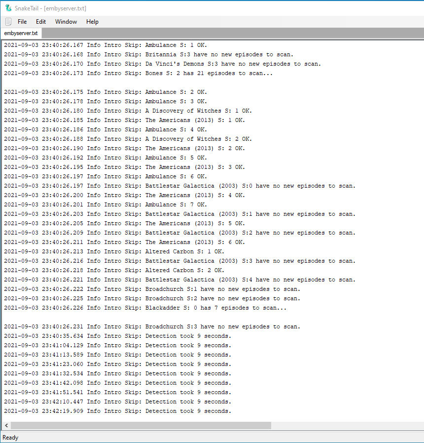

rbjtech 5345 Posted September 3, 2021 Posted September 3, 2021 It's looking good now - a live tail of the log is showing it skipping the episodes it has already done .. nice 1
chef 3811 Posted September 3, 2021 Posted September 3, 2021 2 minutes ago, rbjtech said: It's looking good now - a live tail of the log is showing it skipping the episodes it has already done .. nice
rbjtech 5345 Posted September 3, 2021 Posted September 3, 2021 btw - I'm not sure the 'Detection took X seconds' is adding much info to the log - maybe if you added which title it was referring to ? Or maybe remove it ?
chef 3811 Posted September 3, 2021 Posted September 3, 2021 1 minute ago, rbjtech said: btw - I'm not sure the 'Detection took X seconds' is adding much info to the log - maybe if you added which title it was referring to ? Or maybe remove it ? Will do. It was kinda to help know how long these fingerprint comparisons where taking. But, having more info there is much more helpful. 2 1
