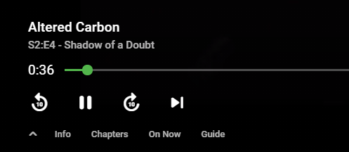

rbjtech 5345 Posted September 3, 2021 Posted September 3, 2021 1 minute ago, Cheesegeezer said: Gotchya... yep... so we need a identification marker for when Intro starts playing, which triggers that netflix style button, which appears in the player..... that says skip intro!! Either manually or Automatically, but of course that needs server and likely client code changes. Initial thoughts were to add it into the existing episode 'chapters' list - as now that is a function in most clients, it's only a couple of clicks away to jump to the 'IntroEnd' chapter point ..
Cheesegeezer 3106 Posted September 3, 2021 Posted September 3, 2021 (edited) 10 minutes ago, rbjtech said: Either manually or Automatically, but of course that needs server and likely client code changes. Initial thoughts were to add it into the existing episode 'chapters' list - as now that is a function in most clients, it's only a couple of clicks away to jump to the 'IntroEnd' chapter point .. All the clients are driven from one source now and passed thru electron depending on what device they are on. So this would be a fairly straightforward process to implement to all clients. The player just needs to watch for a Intro Start Chapter tag from chapters(as you suggest) and then show the button until the intro end chapter tag has passed. But if you plan on backing out then clicking the chapter for intro end, it's probably quicker to just hit skip on the remote 2 or 3 times and watch the last 10 secs of an intro. Really need the admins on board for this to work and be a polished feature. I mean @chef has done all the heavy lifting and hard work here for them. Edited September 3, 2021 by Cheesegeezer 1
chef 3811 Posted September 3, 2021 Posted September 3, 2021 30 minutes ago, rbjtech said: ok - so a quick run (yes I deleted the dB..) - Maybe I've got my wires crossed - but I though the new version was going to do the detection after each Season ? I still have the Detect schedule ... err... I'm confused .. (doesn't take much..) That might be difficult with the tasks split. Let me see what it would look like to have a master task. It probably wouldn't be much faster, but it would keep our file size in check for sure. I'll get back to you. 1
rbjtech 5345 Posted September 3, 2021 Posted September 3, 2021 (edited) 7 minutes ago, Cheesegeezer said: But if you plan on backing out then clicking the chapter for intro end, it's probably quicker to just hit skip on the remote 2 or 3 times and watch the last 10 secs of an intro. Really need the admins on board for this to work and be a polished feature. I mean @chef has done all the heavy lifting and hard work here for them. Playing hit the 'IntroEnd' is always fun on the remote. It would need to be a single click or two at most to be useful I agree entirely. Maybe add as a 'Skip Intro' on the new enhanced UI - that would be two button presses. Edited September 3, 2021 by rbjtech

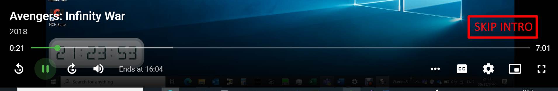

Cheesegeezer 3106 Posted September 3, 2021 Posted September 3, 2021 2 minutes ago, rbjtech said: Playing hit the 'IntroEnd' is always fun on the remote. It would need to be a single click or two at most to be useful I agree entirely. Maybe add as a 'Skip Intro' on the new enhanced UI - that would be two button presses. well you could have the button appear on the eUI and auto focus on it. Same as the play/pause button is the autofocus when pulling up the eUI. 1
Cheesegeezer 3106 Posted September 3, 2021 Posted September 3, 2021 (edited) Very crude mockup but not have any of the interface show, just the button by itself. (by the way before you get confused, it's a screen capture video i use for testing plugins on my work/code laptop, just have it set up as Avengers in the metadata) Edited September 3, 2021 by Cheesegeezer 1
