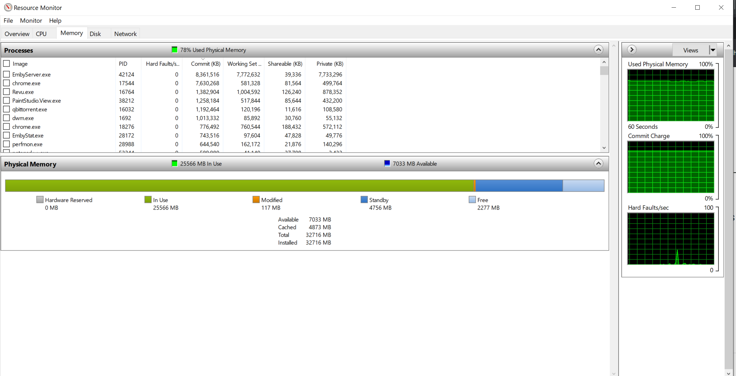

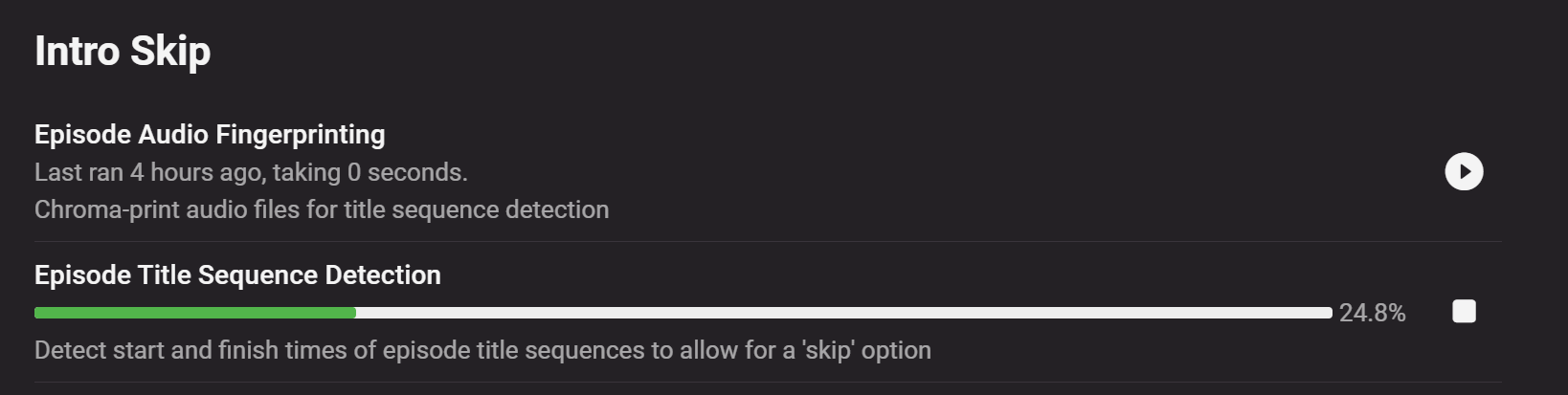

Sammy 791 Posted September 1, 2021 Posted September 1, 2021 @rbjtech @chef It seems that every time I check it is running again as the percent complete actually goes down. Memory Usage: 1
rbjtech 5345 Posted September 1, 2021 Posted September 1, 2021 (edited) Thanks Sammy - yea I think there are some issues with large data sets - yours is @ 8Gb Mem (same as mine with presumably the default 4 detection processes running), I doubled mine to 8 and it took 16Gb Mem .. Looking at perfmon, it's spending all it's time reading the db and little else. I'm going to start again (just shutdown and rename the FP db!) with a more controlled data set - maybe 10 shows - and see what the performance is like then - as with the current rate of progress, this task will take until 2022 ! @chef - Any thoughts here ? What size of data sets did you test on ? Edited September 1, 2021 by rbjtech

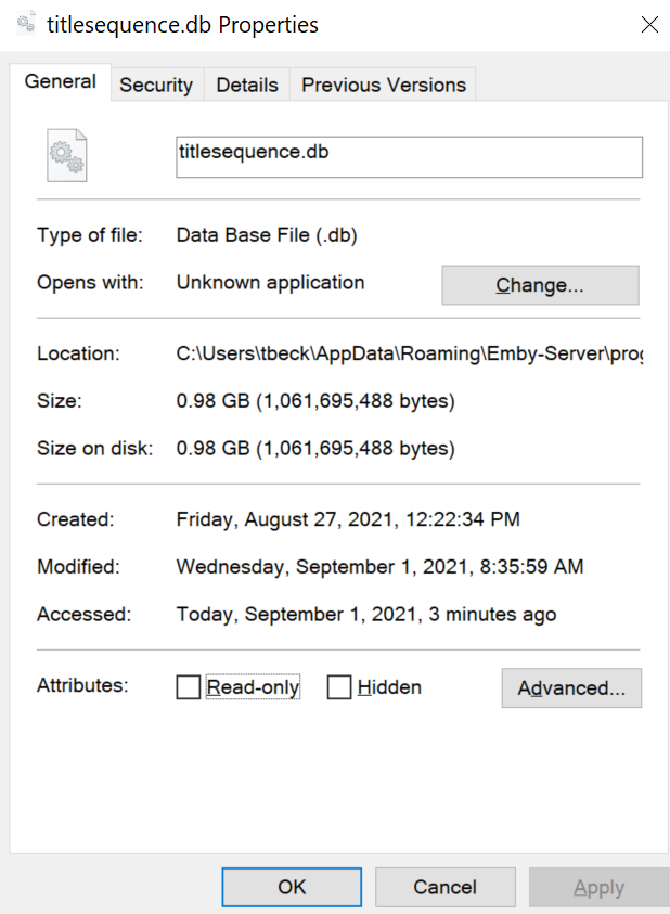

Sammy 791 Posted September 1, 2021 Posted September 1, 2021 @rbjtech @chef size of titlesequence.db currently 1
Sammy 791 Posted September 1, 2021 Posted September 1, 2021 I think Detect Title Sequence gets started again on schedule before it ever finishes so I'm going to delete the schedule and see what happens. 1
chef 3811 Posted September 1, 2021 Posted September 1, 2021 (edited) Yes, the db file has an index, but I also see it growing exponentially. The db file size seems to keep it's size even if items are removed. Then if items are added, the size grows. Apparently this is a thing with databases. The table data shouldn't ever be bigger then the library.db. It should actually be smaller, because we don't have as many columns as the library.db but we have the same amount of rows. I have to learn what is happening. Maybe we need to VACCUME the database? Edited September 1, 2021 by chef
rbjtech 5345 Posted September 1, 2021 Posted September 1, 2021 The table data shouldn't ever be bigger then the library.db. - the problem column is the FingerPrint data - it's a huge text field - this is the issue. The number of rows isn't the issue (I had 30K and could query in fractions of a second without the FP Data) - it's think it's the file size/memory usage. My titlesequence.db is now 2.2 Gb in size .. If I remove the FP data, it's 2Mb - and everything is super responsive again. I'm using symlinks to setup virtual libraries - testing on a set of 5 shows, then 10 etc but I *think* not trying to FP 'everything' and then Detect 'everything' is the key here to keeping the dB a manageable and thus workable size. Maybe even keeping a 'working' db for the FP only and a 'detect' dB for the actual results would also work - I think. I'll continue to experiment but please let me know how I can help !
rbjtech 5345 Posted September 1, 2021 Posted September 1, 2021 16 minutes ago, chef said: Maybe we need to VACCUME the database? This will remove the entries marked for deletion - and yes, this is how I removed the data in the 'FingerPrint' column (replaced all values with NULL and then vacumed). If you don't do this, the file size stays exactly the same even if the values are NULL. But for the way we are doing it now, you NEED all that data - so you can't remove it until after you have Detected the sequence on it - and only then if the Show is finished, otherwise you should probably keep it for when you add episodes, you'll need it again no ?
chef 3811 Posted September 1, 2021 Posted September 1, 2021 (edited) 37 minutes ago, rbjtech said: This will remove the entries marked for deletion - and yes, this is how I removed the data in the 'FingerPrint' column (replaced all values with NULL and then vacumed). If you don't do this, the file size stays exactly the same even if the values are NULL. But for the way we are doing it now, you NEED all that data - so you can't remove it until after you have Detected the sequence on it - and only then if the Show is finished, otherwise you should probably keep it for when you add episodes, you'll need it again no ? I've added the vacuum pragma to the db file. I see what you mean, the fingerprint arrays are huge, and we would need them to continue comparing in the future. What should we do? Let the file be huge? As for grabbing items from the database faster, I have created a query that will request only items from a specific season. That will speed things up a lot. Now we don't have to request the entire database every time, just what we need. Edited September 1, 2021 by chef
rbjtech 5345 Posted September 1, 2021 Posted September 1, 2021 3 minutes ago, chef said: I see what you mean, the fingerprint arrays are huge, and we would need them to continue comparing in the future. What should we do? Let the file be huge? My view is once the show has 'finished' and the Detection has been completed - then remove the FP Data - it is not of use anymore and will not be re-used ? This needs a little though if you are trying to backfill a 'finished' show (for example) but if you have a 100% completion rate (ie no missing episodes) than I see zero reason for keeping it post Detection. so 1. FP all data for Show A 2. Detect IntroSequence for Show A 3. Remove FP Data for Show A 4. Vacuum dB after X number of Shows 5. Re-start the process for Show B .. 9 minutes ago, chef said: That will speed things up a lot. Now we don't have to request the entire database all every time, just what we need. ok - this is cool - Currently I have to wait nearly 70 seconds to view any IntroSkip dB query (I just get a spinner for that time) - and I *think* this is also causing a major memory issue for the Detect processing as presumably, it has to do the same query ? 1
