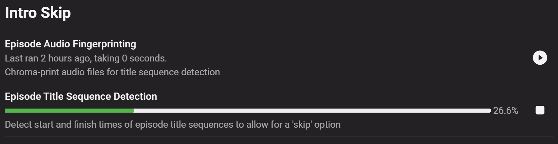

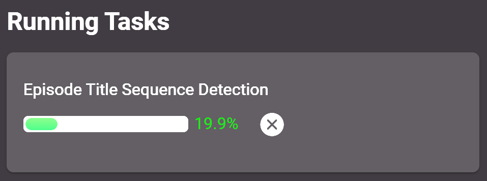

Sammy 791 Posted August 28, 2021 Posted August 28, 2021 rar not zip? BTW, I'm still waiting for the title sequence to finish from the last version! I'm 10 hours in now and it took nearly half a day to do the fingerprinting yesterday..
Sammy 791 Posted August 28, 2021 Posted August 28, 2021 If I do my math right, I've got 40 more hours to go, or more than 3 days?
chef 3811 Posted August 28, 2021 Posted August 28, 2021 52 minutes ago, Sammy said: If I do my math right, I've got 40 more hours to go, or more than 3 days? Oh boy. That is pretty long. I think there would be two log files in emby that would span the task time. One from yesterday, and one from this morning. Would I be able to see them? I know you have a large library, I'd love to make sure you're getting results.

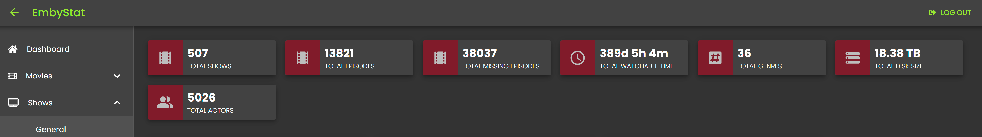

STR8 74 Posted August 28, 2021 Posted August 28, 2021 Don't feel bad @Sammy I'm at 51.7% and on my 3rd day... I know I have about 240 tv shows tho. So I'm thinking another 3 days and I'll be done lol!

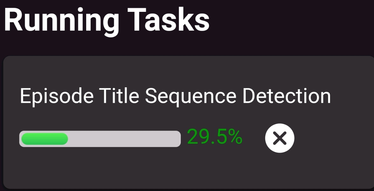

rbjtech 5345 Posted August 31, 2021 Posted August 31, 2021 (edited) Hi @chef - So I tried to run the latest Introskip on my main TV shows collection and a few issues cropped up and I was forced to abandon it. At about 30% through the FP - the dB size for titlessequence.db was just over 1Gb .. After a graceful 'stop' - any db search in the Plugin now takes 30 seconds - presumably as the db size is large. Does it have any form of index to help with the query ? I also then tried to get some actual Sequence Detection completed - as expected, the logs were filled with 'missing FP' but on those it could find, detection went ok - and those details are showing ok in the Plugin (after 30 seconds.) However, I also had to abandon this as memory usage started to grow fast - I'm not sure if this was because of the missing FP's ? Part of me is thinking why are we splitting these items into two sets of 'complete' tasks - was there a reason for this ? Would it be better to FP a 'season or show', then run detection on that season, once detection is complete, then remove the FP data for completed shows (ie Status=Ended) and then repeat ? You are then left with a much more manageable database, quicker to search as it now only contains the FP data for 'Continuing' shows plus of course the Intro Start/End for all shows, which is, after all, the important bit. I think my system would 'get there' eventually, but if @Sammy is struggling with a 16core/32thread system, this process is going to kill most systems, especially people that run on low powered NAS devices for example - so perhaps a 'per season or per show' approach is needed to make it more manageable ? To end on a positive note - every detection it did get to was almost perfect - so the core detection technology works extremely well - it's just managing the journey to the end result that I feel needs a little more analysis .. edit .. So I've had a quick play with the dB - by removing all the data from the Fingerprint column (NULL) - now response in the Plugin are instant again - this is on a 10K row database (30% of my collection). After a vacuum, dB size is also back to under 1Mb. I'm going to restore the file and continue the FP task, but it does sound like the dB needs some indexes or maybe offloading to an archive dB if you do want to/need to keep the FP data. edit2 .. I've also just realised why the FP was eating so much CPU - I did not exclude the new Beta instance ffmpeg from my real-time AV scanning - doh! - so it was scanning every file it was trying to process.. Now ffmpeg is excluded, I can now run 6-8 parallel streams - each taking about 10% cpu.. Edited August 31, 2021 by rbjtech 2 1
rbjtech 5345 Posted September 1, 2021 Posted September 1, 2021 Update #2 So the FP process has finished - resulting db file is 2.5Gb in size .. I tried to run the Detection on my main machine but it just killed it with 100% memory usage (the VM only has 4Gb) - so I abandoned that and moved the Emby instance to my local machine and ran it from there instead on the previously FP's dB That is running - but embyserver.exe is currently using between 8-10 Gb of memory () - cpu is @ 50% - and this is with the default 4 threads. The logs show it is getting though the episodes, but extremely slowly .. but if it's having to do a lookup for each one (taking minutes each time) then this probably explains this. Are there any logs I can provide to help you identify the cause of the slow lookup and huge memory usage ? @Sammy Did you notice your memory usage during the Detection ? What size is your titlesequence.db file ? Thanks.
