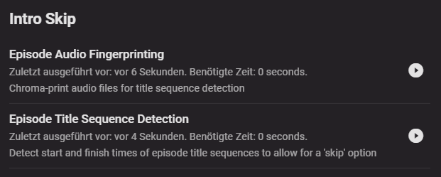

Skyfay 19 Posted August 25, 2021 Posted August 25, 2021 22 minutes ago, chef said: You should be okay on Ubuntu. Try the fingerprinting task first. Allow it to finish, then try the title sequence detection next. Not work for me... Im on version 4.6.4.0 is that fine?
chef 3811 Posted August 25, 2021 Posted August 25, 2021 9 minutes ago, Skyfay said: Not work for me... Im on version 4.6.4.0 is that fine? pkease darf ich eine Log-Datei haben. may I have a log?

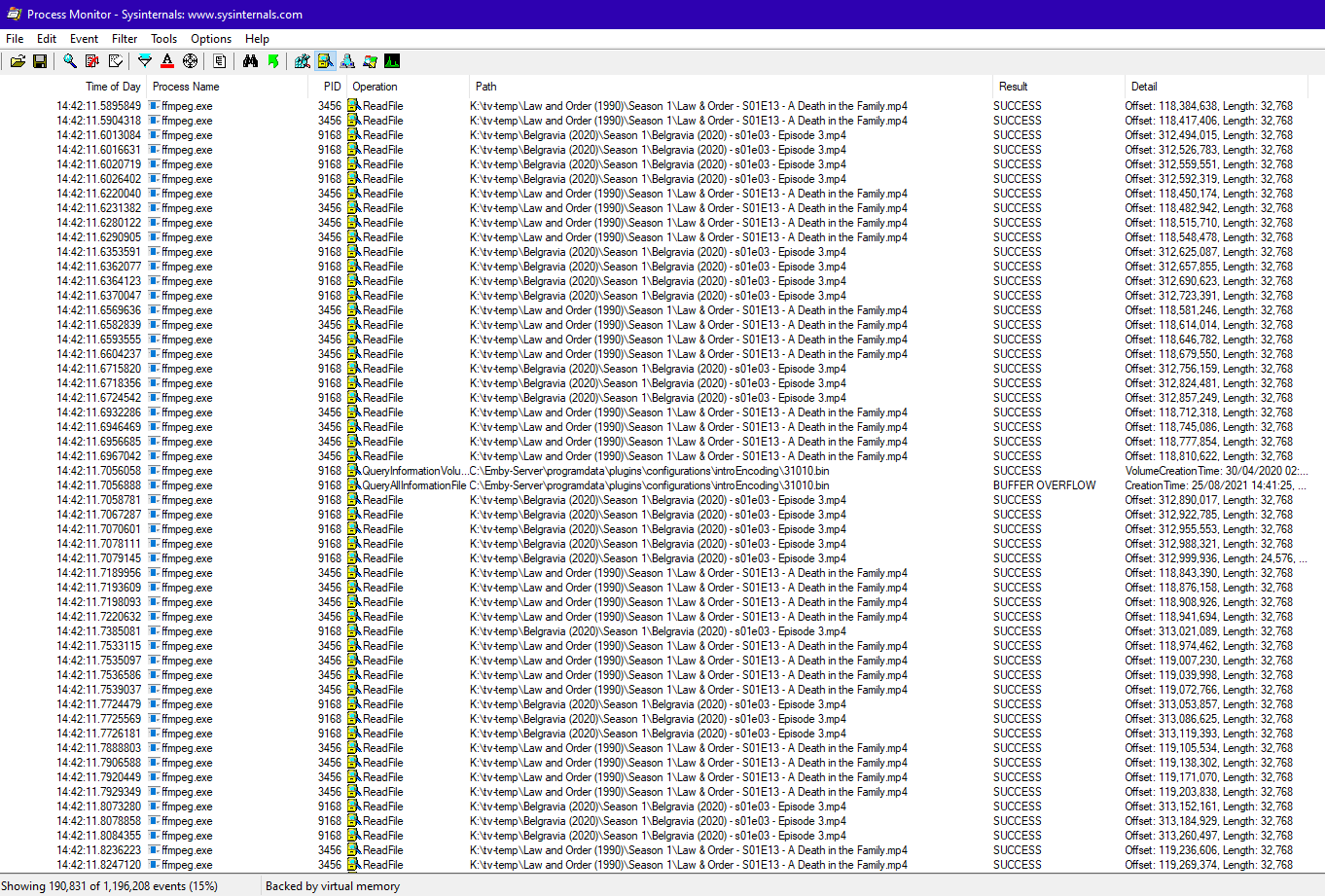

rbjtech 5345 Posted August 25, 2021 Posted August 25, 2021 So it's pretty easy to see why the I/O is getting hammered ! This was just running with 2 threads, and the reads are flipping between the two files with what looks to be 32K chunks ? Thus the HDD is seeking each time. Is there any way to read larger file chunks / increase the buffer size on the ffmpeg reads perhaps ? 1

chef 3811 Posted August 25, 2021 Posted August 25, 2021 (edited) 57 minutes ago, rbjtech said: So it's pretty easy to see why the I/O is getting hammered ! This was just running with 2 threads, and the reads are flipping between the two files with what looks to be 32K chunks ? Thus the HDD is seeking each time. Is there any way to read larger file chunks / increase the buffer size on the ffmpeg reads perhaps ? Instead of reading each bin after it has been processed and saved, we can wait and read a bunch of them at the end of the task. I believe this is possible. EDIT: plus we are opening and writing to the database each time. Edited August 25, 2021 by chef
rbjtech 5345 Posted August 25, 2021 Posted August 25, 2021 3 minutes ago, chef said: Instead of reading each bin after it has been processed and saved, we can wait and read a bunch of them at the end of the task. I believe this is possible. I don't believe it's the .bin that has the problem - that's saved on the SSD in my case, so separate I/O channel. I'm actually wondering if this is simply a case of the limitations of a mechanical HDD.. If I used 2 HDD's (two 'spindles') - half the shows one one, half on the other - I suspect, it would halve the fingerprinting time ... 1

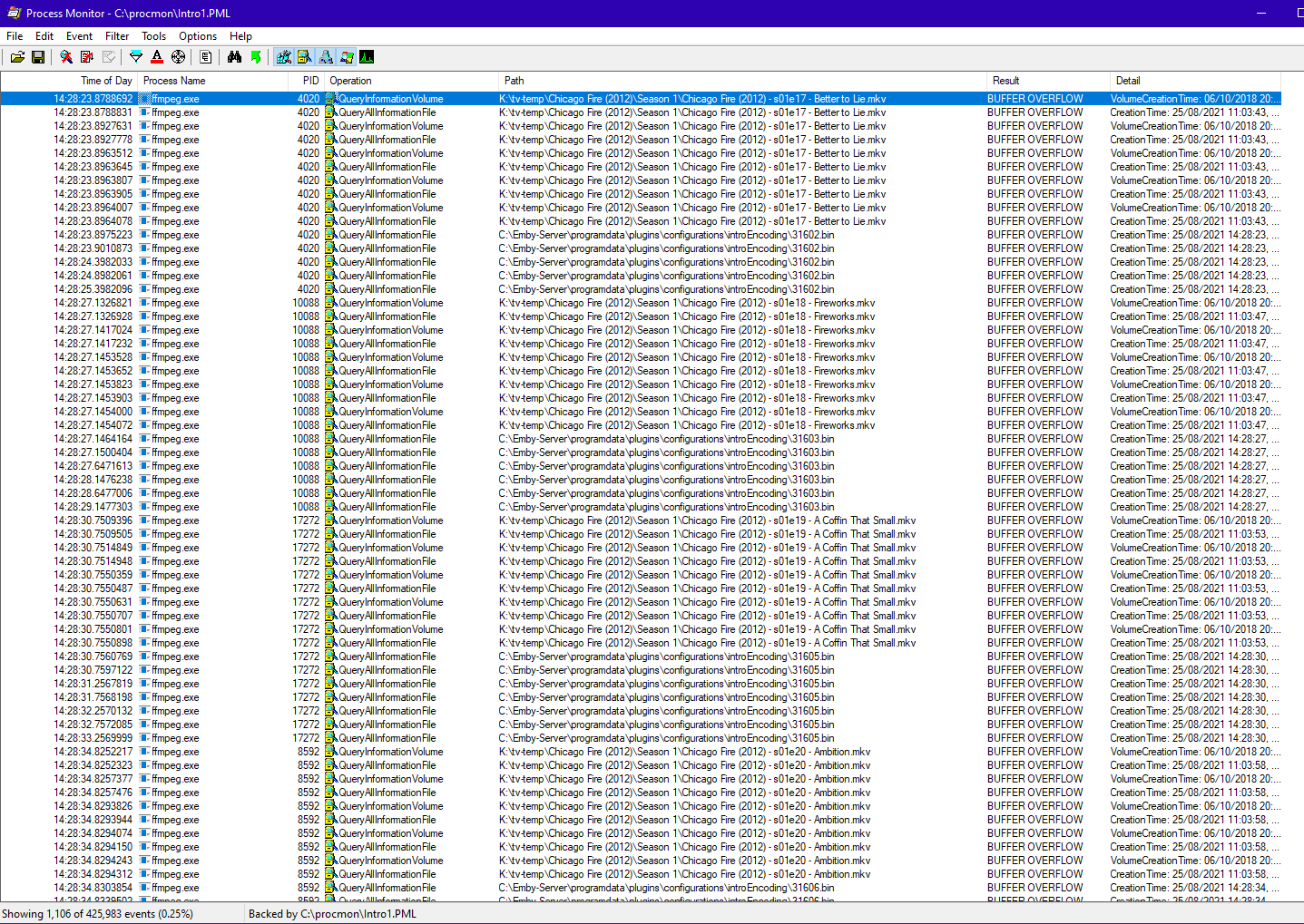

chef 3811 Posted August 25, 2021 Posted August 25, 2021 Oh there is something that might be concerning. What is that buffer overflow in the log? They are never a good thing, especially on a web facing services. That is were people can hide bad code in requests.
rbjtech 5345 Posted August 25, 2021 Posted August 25, 2021 10 minutes ago, chef said: Oh there is something that might be concerning. What is that buffer overflow in the log? They are never a good thing, especially on a web facing services. That is were people can hide bad code in requests. There were a lot of them (filtered) - and not just writing the .bin's - all from ffmpeg though...

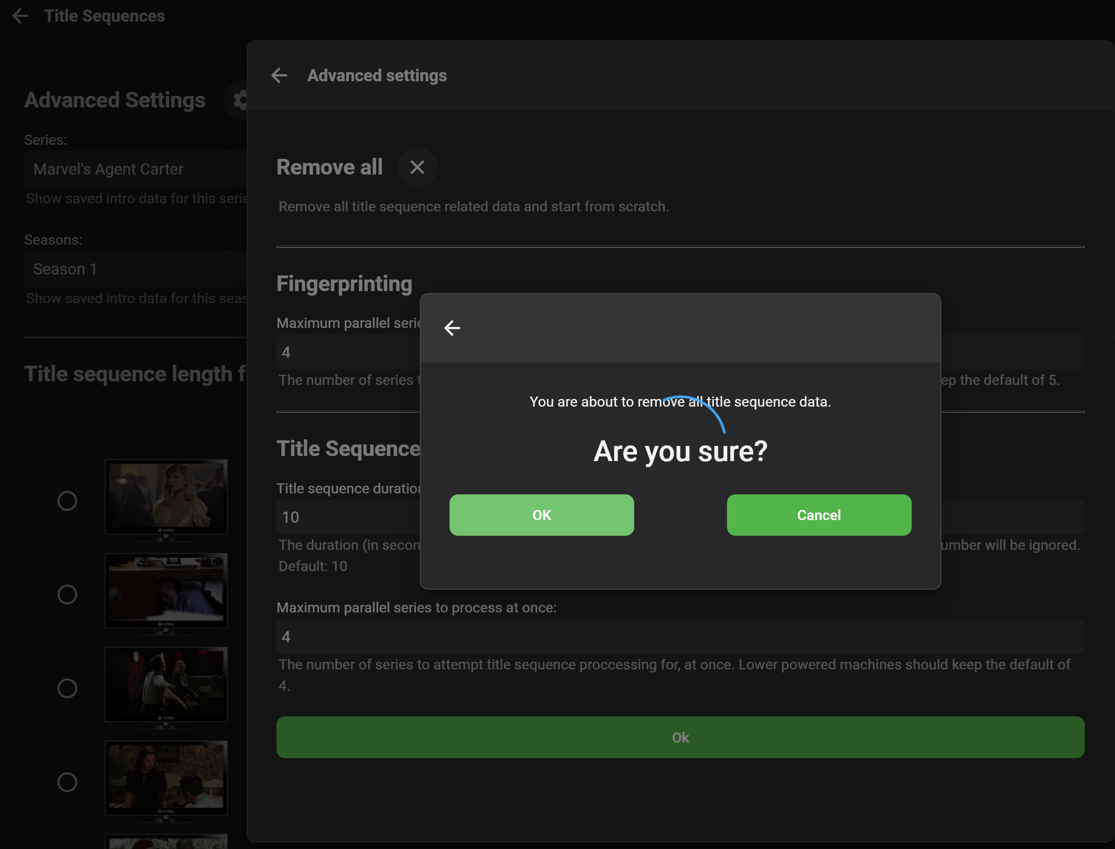

Sammy 791 Posted August 25, 2021 Posted August 25, 2021 This process seems lengthy and there's no real way to know if it properly completed or not: Spinner spins and spins then stops but this dialog screen still shows. 1
rbjtech 5345 Posted August 25, 2021 Posted August 25, 2021 4 minutes ago, Sammy said: This process seems lengthy and there's no real way to know if it properly completed or not: Spinner spins and spins then stops but this dialog screen still shows. Yea there are a few little issues with the GUI - the same if you use the 'Remove Data' for that show - unless you click another show, the data still shows (even though it's gone). But these are just minor refresh issues I'm sure - the key issue (for me anyway) at the moment is performance testing. @Sammy I see you have selected 4 threads for Fingerprinting (from the screen grab above) - what type of storage is this using and what levels of activity do you see when it's running ?
