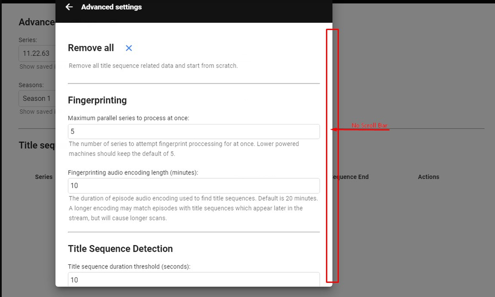

STR8 74 Posted August 23, 2021 Posted August 23, 2021 Not sure if this was done correctly @chef I stayed with the same plugin (didn't install any new version) Restarted the Emby server Where would I pull the required information that would be needed to compare? (out of the logs or ?) Also when I go into the plugin and advance setting it wont allow me to scroll down to see or access the other settings at the bottom of the page. (also I have tried opening the plugin in both Chrome and Microsoft edge and both are the same) Will run both the fingerprinting and detection again as I added new episodes for a couple of shows... thanks for your help in getting this done.
chef 3811 Posted August 23, 2021 Posted August 23, 2021 (edited) 1 hour ago, STR8 said: Not sure if this was done correctly @chef I stayed with the same plugin (didn't install any new version) Restarted the Emby server Where would I pull the required information that would be needed to compare? (out of the logs or ?) Also when I go into the plugin and advance setting it wont allow me to scroll down to see or access the other settings at the bottom of the page. (also I have tried opening the plugin in both Chrome and Microsoft edge and both are the same) Will run both the fingerprinting and detection again as I added new episodes for a couple of shows... thanks for your help in getting this done. I will fix the dialog. I must have left out the scrollY class. Nice catch! You would first run the fingerprinting task under scheduled tasks. I would install the most recent version of the plugin, because the database changed. Edited August 23, 2021 by chef

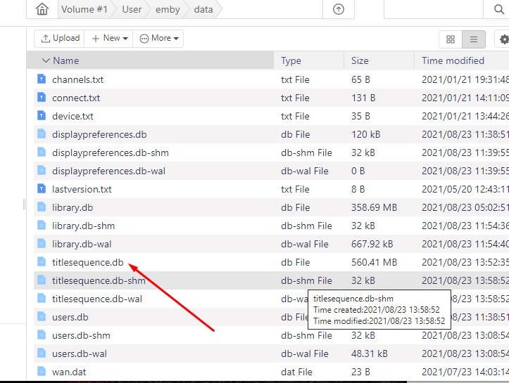

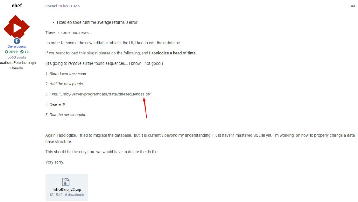

STR8 74 Posted August 23, 2021 Posted August 23, 2021 Chef I wanted to make sure I'm deleting the correct db. I downloaded the plugin off of page 27 and I was looking at the instructions and noticed that there was a (s) at the end of your posted path. On my nas the path I found was here So do we think this is the correct db so that I may continue?
chef 3811 Posted August 23, 2021 Posted August 23, 2021 23 minutes ago, STR8 said: Chef I wanted to make sure I'm deleting the correct db. I downloaded the plugin off of page 27 and I was looking at the instructions and noticed that there was a (s) at the end of your posted path. On my nas the path I found was here So do we think this is the correct db so that I may continue? Yes that is the file to remove. Sorry. You'll have to shut down the server, remove it, and then start the server back up.

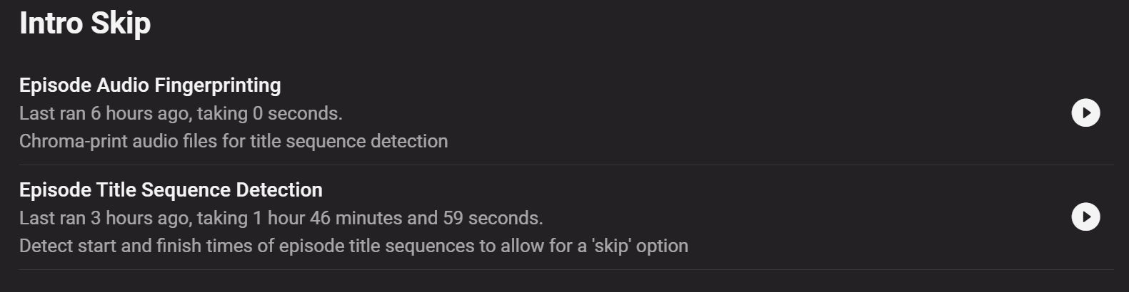

Sammy 791 Posted August 24, 2021 Posted August 24, 2021 BTW, since it took so long for the intro sequence detection the fingerprinting ran again on schedule but since there was nothing new it looks like it to 0 seconds to run.

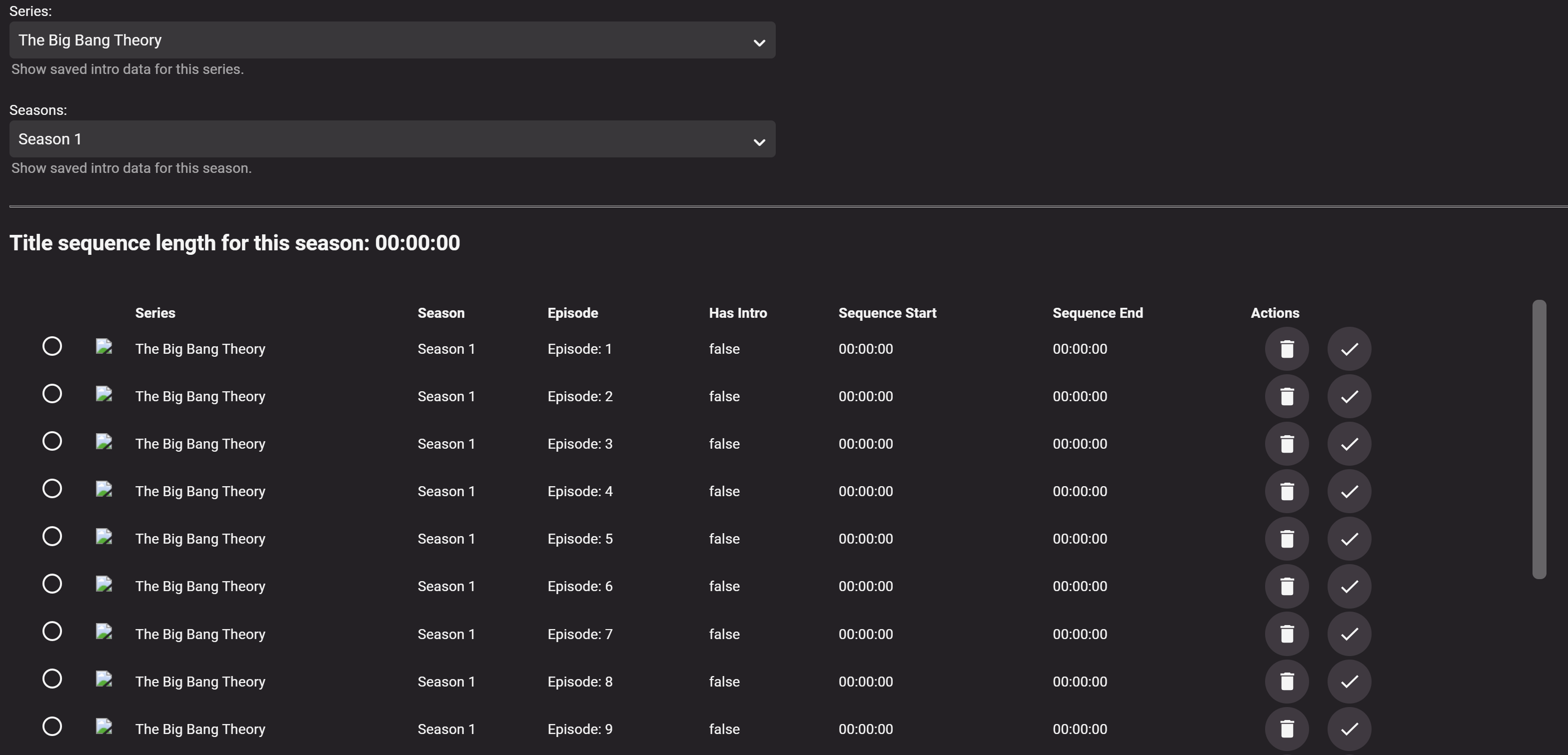

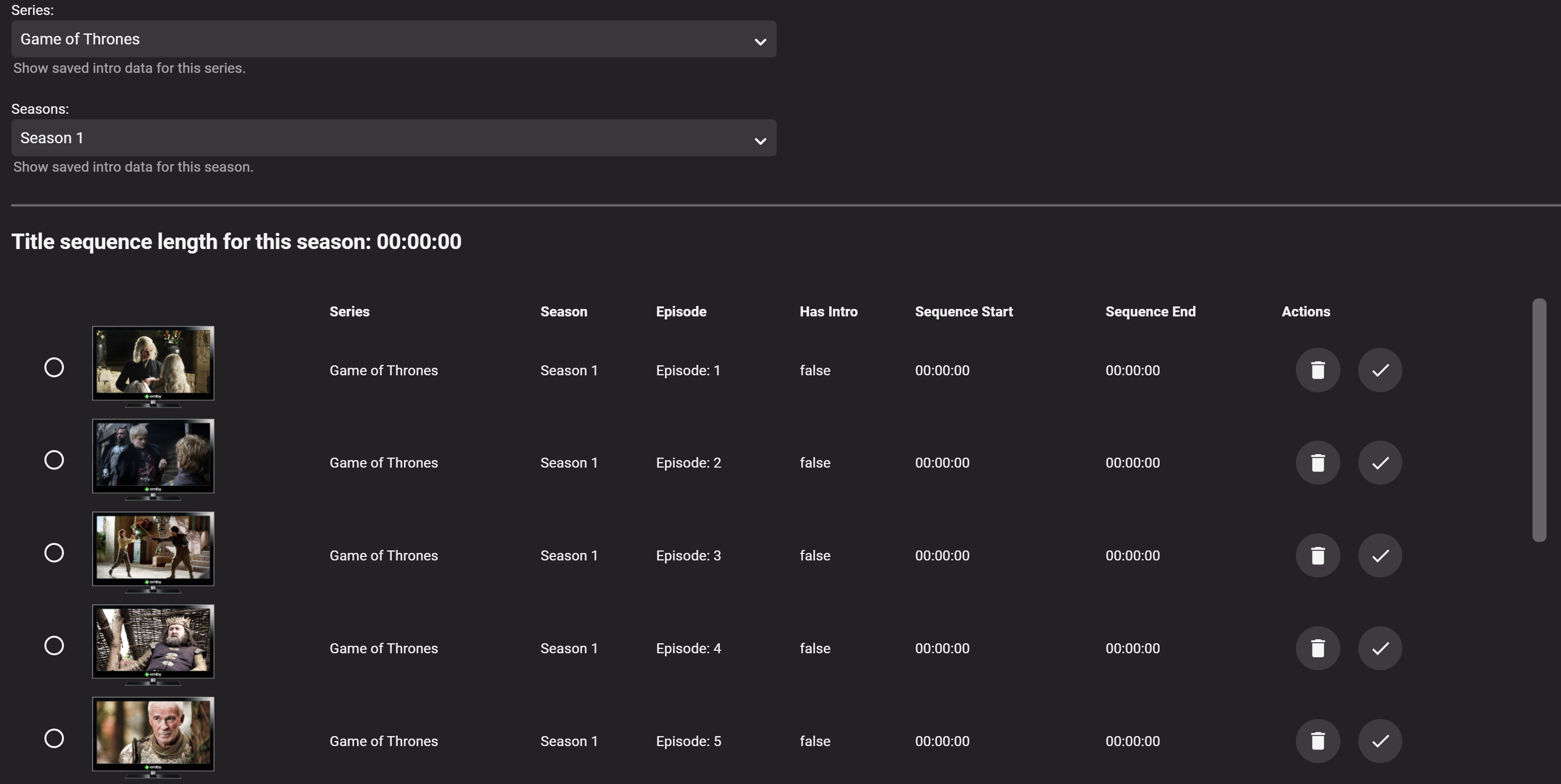

Sammy 791 Posted August 24, 2021 Posted August 24, 2021 But this doesn't look right. embyserver 24082021.txt
chef 3811 Posted August 25, 2021 Posted August 25, 2021 @Sammy can you run the fingerprinting task again. Don't remove anything, just run the task. Some episodes seem to have been missed during fingerprinting. Not sure why... yet.
