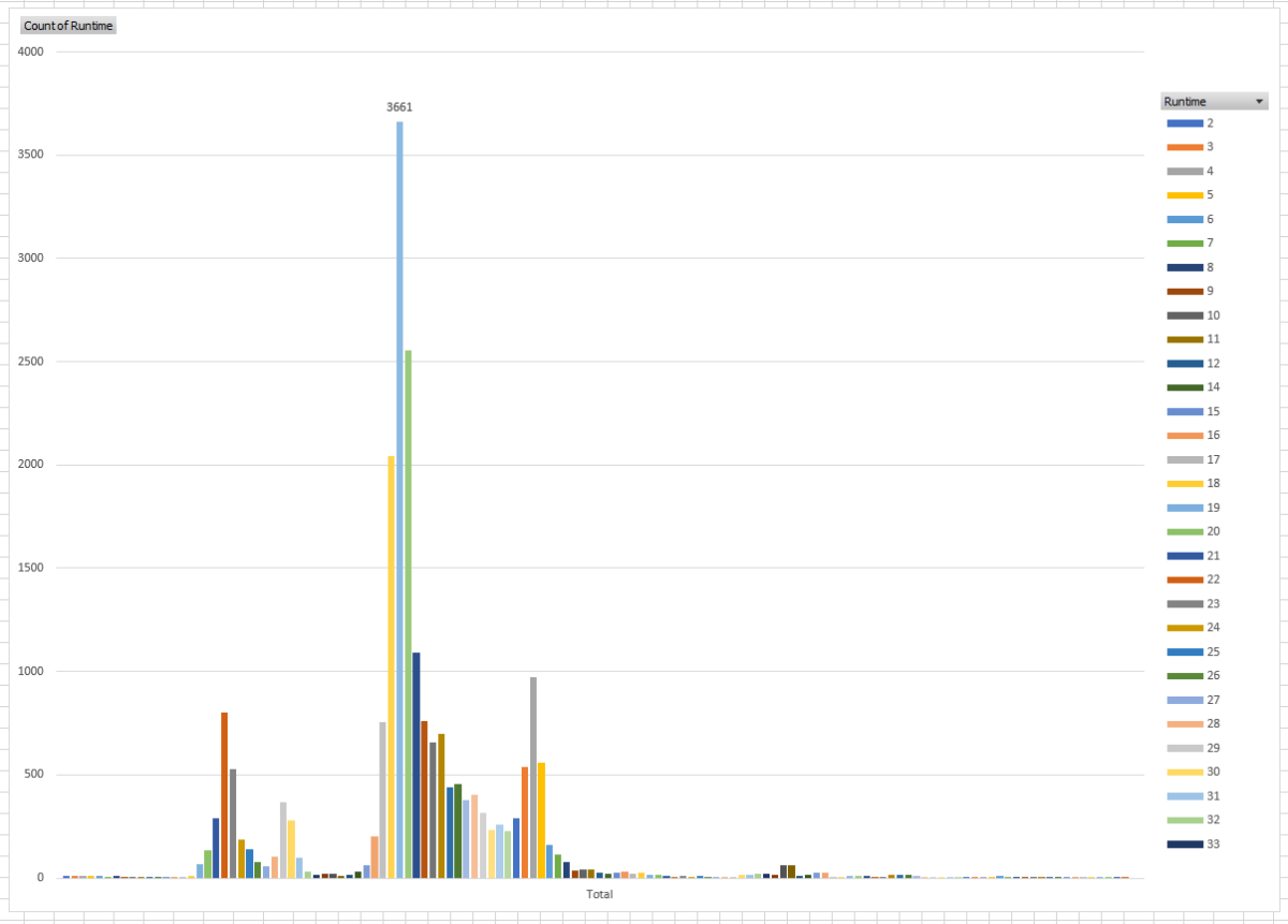

Sammy 791 Posted August 22, 2021 Posted August 22, 2021 On 8/21/2021 at 5:27 AM, rbjtech said: So based on my system, which has ~ 30,000 'Joe Average' episodes (No Anime) - the runtime breakdown via a quick export and pivot table is below - from that I can see 4 key groupings :- < 19 mins 20-39 mins 40-55 mins > 56 mins So based on the above - I believe (for me) a 40 minute cut off is too soon to 'return 20' and you would scanning a lot of 40-45 min shows with unnecessary scan time - imho. It would be good to get others runtime averages stats - as things like Anime etc would (I guess) totally change the view here. I finally got a chance to create the pivot table and cluster bar graph. Here are my results. I have no anime either and have basically two clusters. 1 1
rbjtech 5345 Posted August 22, 2021 Posted August 22, 2021 7 minutes ago, Sammy said: I finally got a chance to create the pivot table and cluster bar graph. Here are my results. I have no anime either and have basically two clusters. Cool - That's useful Info - Your results are very similar to mine 1 1
