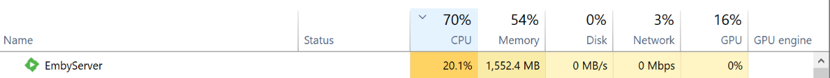

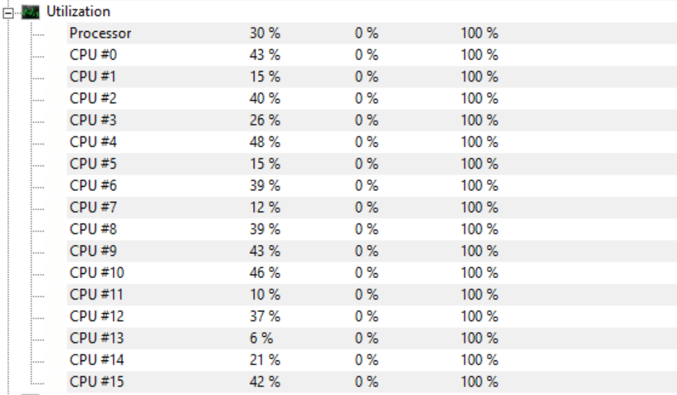

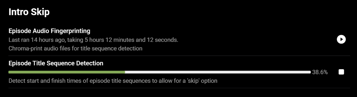

chef 3811 Posted August 20, 2021 Posted August 20, 2021 1 hour ago, Sammy said: It is taking for-eh-ver.. Yes,... say is your PC pinned at 99% right now?

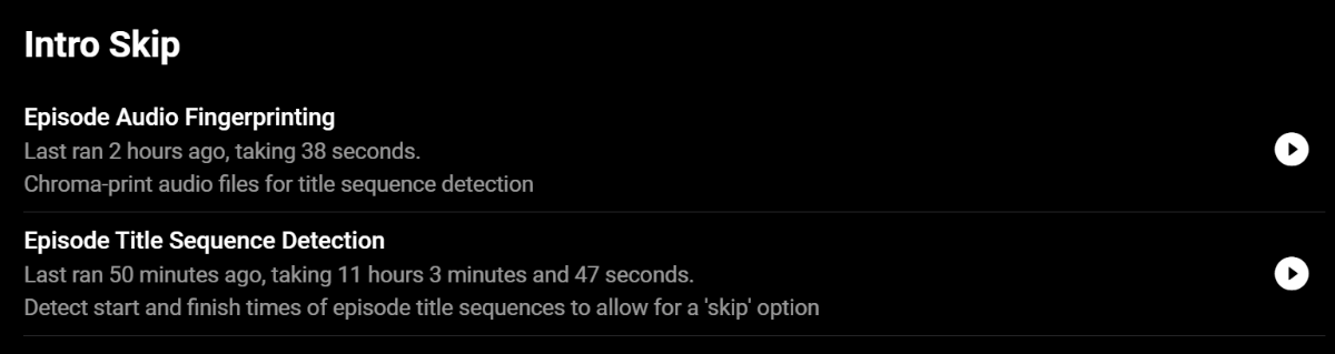

Sammy 791 Posted August 20, 2021 Posted August 20, 2021 (edited) Finally finished! I wonder if the scheduled run of Fingerprinting disrupted the creation of the Title Sequence Detection? Should there be a check to prevent this since it takes half a day to run the Episode Title Sequence Detection? Edited August 20, 2021 by Sammy 1

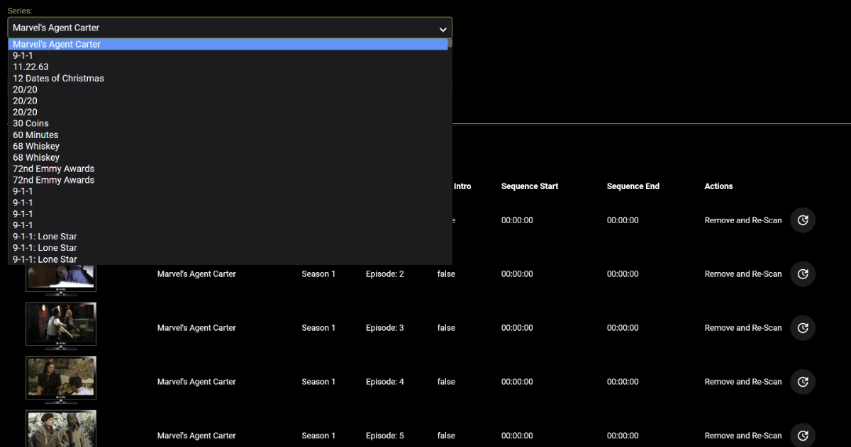

Sammy 791 Posted August 20, 2021 Posted August 20, 2021 (edited) Why is Agent Carter before the series starting with a numeral? Edited August 20, 2021 by Sammy

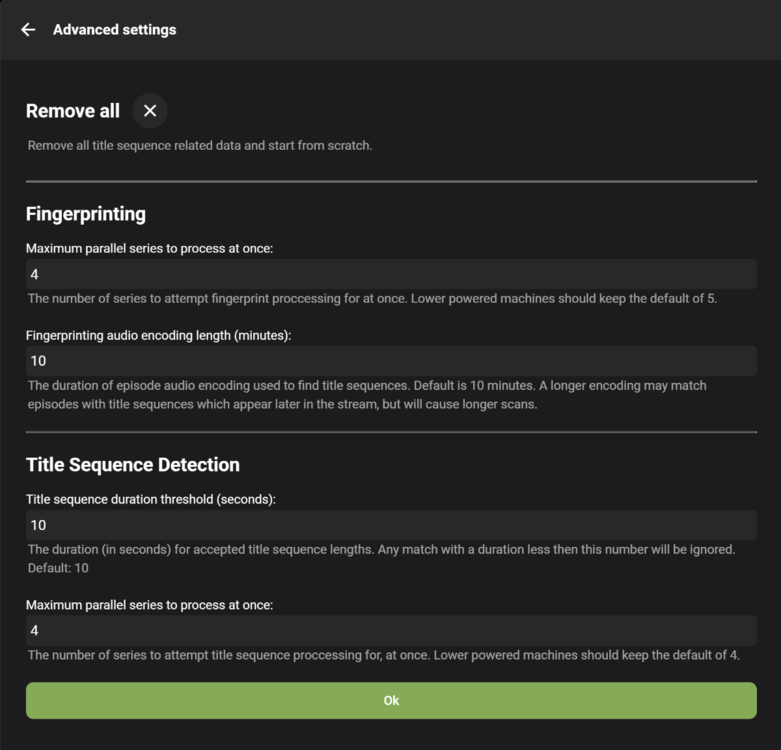

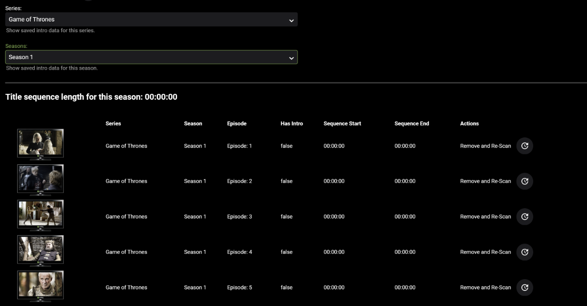

chef 3811 Posted August 20, 2021 Posted August 20, 2021 1 hour ago, Sammy said: Why is Agent Carter before the series starting with a numeral? I'm not sure why Agent Carter shows up at the top. But, I know that Agent Carter is a tv show that I don't seem to get results for either. As for Game of Thrones... what is the Fingerprint tasks duration set to in the advanced settings? May I have a log file? too
Sammy 791 Posted August 20, 2021 Posted August 20, 2021 This is the default I guess but I thought it was being increased to 15 or even 20 minutes?
chef 3811 Posted August 21, 2021 Posted August 21, 2021 50 minutes ago, Sammy said: This is the default I guess but I thought it was being increased to 15 or even 20 minutes? Yes, we did, but there are some tv shows that are only 15 minutes long, so we changed again surprise!! I bet the 15 or 20 minute encoding will pick up GOT. I think we should check the average runtime of a season, and automatically choose the best encoding length for fingerprints. Its probably something that needs adding right away. Im going to figure something out here.
