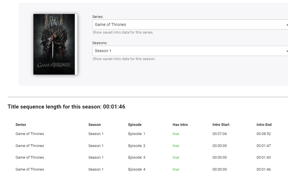

rbjtech 5345 Posted August 19, 2021 Posted August 19, 2021 I think GoT is an edge case - if new to the show, then watching the Intro 7 minutes in for s1e1 really isn't a problem - because all other episodes are picked up correctly - and your code did exactly as it should - it reported that s1e1 did not have an Intro (to match any other episode) - which is correct. That is all great for nicely authored shows - but in the case of another GoT source - where people have chopped off the recap, chopped off the HBO etc - then this is where your code understandably struggles because it is simply not being able to match like for like, but that is no fault of the code - the problem is the variable quality media. I've still been unable to properly edit s1e1 to add the Intro (incl the HBO) to after the 7 min mark - but removing it (see below) produces the correct results - so I'm confident it would behave in exactly the same way. I'm going to add a few more shows and see what happens - but I think we are good .. @chef 1
rbjtech 5345 Posted August 19, 2021 Posted August 19, 2021 (edited) Bingo ! So I managed to chop the 'HBO + Intro' out of another episode, and replace the Intro (without the HBO part) in s01e01. Now the Intro's for all are identical - and thus it picks them all up without issues - even after 7 minutes in. We were chasing a problem that didn't exist .. Edited August 19, 2021 by rbjtech

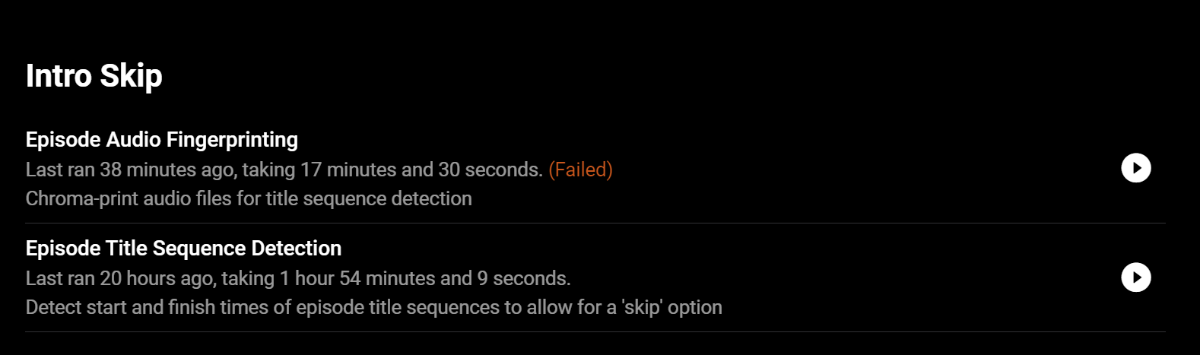

samuelqwe 317 Posted August 19, 2021 Posted August 19, 2021 @chef Ran the fingerprinting overnight, and eventually the task failed like @Sammy. This was the error: One or more errors occurred. (Could not find file '/config/plugins/configurations/introEncoding/426421.bin'.) at System.Threading.Tasks.TaskReplicator.Run[TState](ReplicatableUserAction`1 action, ParallelOptions options, Boolean stopOnFirstFailure) at System.Threading.Tasks.Parallel.ForWorker[TLocal](Int32 fromInclusive, Int32 toExclusive, ParallelOptions parallelOptions, Action`1 body, Action`2 bodyWithState, Func`4 bodyWithLocal, Func`1 localInit, Action`1 localFinally) --- End of stack trace from previous location where exception was thrown --- at System.Runtime.ExceptionServices.ExceptionDispatchInfo.Throw(Exception source) at System.Threading.Tasks.Parallel.ThrowSingleCancellationExceptionOrOtherException(ICollection exceptions, CancellationToken cancelToken, Exception otherException) at System.Threading.Tasks.Parallel.ForWorker[TLocal](Int32 fromInclusive, Int32 toExclusive, ParallelOptions parallelOptions, Action`1 body, Action`2 bodyWithState, Func`4 bodyWithLocal, Func`1 localInit, Action`1 localFinally) at System.Threading.Tasks.Parallel.ForEachWorker[TSource,TLocal](TSource[] array, ParallelOptions parallelOptions, Action`1 body, Action`2 bodyWithState, Action`3 bodyWithStateAndIndex, Func`4 bodyWithStateAndLocal, Func`5 bodyWithEverything, Func`1 localInit, Action`1 localFinally) at System.Threading.Tasks.Parallel.ForEachWorker[TSource,TLocal](IEnumerable`1 source, ParallelOptions parallelOptions, Action`1 body, Action`2 bodyWithState, Action`3 bodyWithStateAndIndex, Func`4 bodyWithStateAndLocal, Func`5 bodyWithEverything, Func`1 localInit, Action`1 localFinally) at System.Threading.Tasks.Parallel.ForEach[TSource](IEnumerable`1 source, ParallelOptions parallelOptions, Action`2 body) at IntroSkip.AudioFingerprinting.AudioFingerprintScheduledTask.Execute(CancellationToken cancellationToken, IProgress`1 progress) at Emby.Server.Implementations.ScheduledTasks.ScheduledTaskWorker.ExecuteInternal(TaskOptions options) I think I know why it occurred, and I was able to restart the task just fine, but you'll likely need to adjust it so it's not a problem. I think the issue happened because it was trying to fingerprint a file that doesn't exist anymore (deleted recording, etc.) and then the task fails when it tries to read a non-existent .bin file. 1
chef 3811 Posted August 19, 2021 Posted August 19, 2021 35 minutes ago, samuelqwe said: @chef Ran the fingerprinting overnight, and eventually the task failed like @Sammy. This was the error: One or more errors occurred. (Could not find file '/config/plugins/configurations/introEncoding/426421.bin'.) at System.Threading.Tasks.TaskReplicator.Run[TState](ReplicatableUserAction`1 action, ParallelOptions options, Boolean stopOnFirstFailure) at System.Threading.Tasks.Parallel.ForWorker[TLocal](Int32 fromInclusive, Int32 toExclusive, ParallelOptions parallelOptions, Action`1 body, Action`2 bodyWithState, Func`4 bodyWithLocal, Func`1 localInit, Action`1 localFinally) --- End of stack trace from previous location where exception was thrown --- at System.Runtime.ExceptionServices.ExceptionDispatchInfo.Throw(Exception source) at System.Threading.Tasks.Parallel.ThrowSingleCancellationExceptionOrOtherException(ICollection exceptions, CancellationToken cancelToken, Exception otherException) at System.Threading.Tasks.Parallel.ForWorker[TLocal](Int32 fromInclusive, Int32 toExclusive, ParallelOptions parallelOptions, Action`1 body, Action`2 bodyWithState, Func`4 bodyWithLocal, Func`1 localInit, Action`1 localFinally) at System.Threading.Tasks.Parallel.ForEachWorker[TSource,TLocal](TSource[] array, ParallelOptions parallelOptions, Action`1 body, Action`2 bodyWithState, Action`3 bodyWithStateAndIndex, Func`4 bodyWithStateAndLocal, Func`5 bodyWithEverything, Func`1 localInit, Action`1 localFinally) at System.Threading.Tasks.Parallel.ForEachWorker[TSource,TLocal](IEnumerable`1 source, ParallelOptions parallelOptions, Action`1 body, Action`2 bodyWithState, Action`3 bodyWithStateAndIndex, Func`4 bodyWithStateAndLocal, Func`5 bodyWithEverything, Func`1 localInit, Action`1 localFinally) at System.Threading.Tasks.Parallel.ForEach[TSource](IEnumerable`1 source, ParallelOptions parallelOptions, Action`2 body) at IntroSkip.AudioFingerprinting.AudioFingerprintScheduledTask.Execute(CancellationToken cancellationToken, IProgress`1 progress) at Emby.Server.Implementations.ScheduledTasks.ScheduledTaskWorker.ExecuteInternal(TaskOptions options) I think I know why it occurred, and I was able to restart the task just fine, but you'll likely need to adjust it so it's not a problem. I think the issue happened because it was trying to fingerprint a file that doesn't exist anymore (deleted recording, etc.) and then the task fails when it tries to read a non-existent .bin file. Yes. I'll have to find out why we deleted the bin file before it could be processed.
chef 3811 Posted August 19, 2021 Posted August 19, 2021 Okay I found the fingerprinting error. I made a bad calculation when processing episodes. It totally makes sense that the file wouldn't be there under the conditions I wrote. 2
chef 3811 Posted August 19, 2021 Posted August 19, 2021 This shouldn't try and remove, or read from .bin files that have already been processed. It also shouldn't cause any issues with a database file which has been already semi-processed. DOWNLOAD: IntroSkip_v2.zip 2

Sammy 791 Posted August 19, 2021 Posted August 19, 2021 It is still failing and this time it lasted less than a minute.. One or more errors occurred. (Could not find file '&programdata&\plugins\configurations\introEncoding\3179764.bin'.) at System.Threading.Tasks.TaskReplicator.Run[TState](ReplicatableUserAction`1 action, ParallelOptions options, Boolean stopOnFirstFailure) at System.Threading.Tasks.Parallel.ForWorker[TLocal](Int32 fromInclusive, Int32 toExclusive, ParallelOptions parallelOptions, Action`1 body, Action`2 bodyWithState, Func`4 bodyWithLocal, Func`1 localInit, Action`1 localFinally) --- End of stack trace from previous location where exception was thrown --- at System.Runtime.ExceptionServices.ExceptionDispatchInfo.Throw(Exception source) at System.Threading.Tasks.Parallel.ThrowSingleCancellationExceptionOrOtherException(ICollection exceptions, CancellationToken cancelToken, Exception otherException) at System.Threading.Tasks.Parallel.ForWorker[TLocal](Int32 fromInclusive, Int32 toExclusive, ParallelOptions parallelOptions, Action`1 body, Action`2 bodyWithState, Func`4 bodyWithLocal, Func`1 localInit, Action`1 localFinally) at System.Threading.Tasks.Parallel.ForEachWorker[TSource,TLocal](TSource[] array, ParallelOptions parallelOptions, Action`1 body, Action`2 bodyWithState, Action`3 bodyWithStateAndIndex, Func`4 bodyWithStateAndLocal, Func`5 bodyWithEverything, Func`1 localInit, Action`1 localFinally) at System.Threading.Tasks.Parallel.ForEachWorker[TSource,TLocal](IEnumerable`1 source, ParallelOptions parallelOptions, Action`1 body, Action`2 bodyWithState, Action`3 bodyWithStateAndIndex, Func`4 bodyWithStateAndLocal, Func`5 bodyWithEverything, Func`1 localInit, Action`1 localFinally) at System.Threading.Tasks.Parallel.ForEach[TSource](IEnumerable`1 source, ParallelOptions parallelOptions, Action`2 body) at IntroSkip.AudioFingerprinting.AudioFingerprintScheduledTask.Execute(CancellationToken cancellationToken, IProgress`1 progress) at Emby.Server.Implementations.ScheduledTasks.ScheduledTaskWorker.ExecuteInternal(TaskOptions options)
samuelqwe 317 Posted August 19, 2021 Posted August 19, 2021 24 minutes ago, Sammy said: It is still failing and this time it lasted less than a minute.. One or more errors occurred. (Could not find file '&programdata&\plugins\configurations\introEncoding\3179764.bin'.) at System.Threading.Tasks.TaskReplicator.Run[TState](ReplicatableUserAction`1 action, ParallelOptions options, Boolean stopOnFirstFailure) at System.Threading.Tasks.Parallel.ForWorker[TLocal](Int32 fromInclusive, Int32 toExclusive, ParallelOptions parallelOptions, Action`1 body, Action`2 bodyWithState, Func`4 bodyWithLocal, Func`1 localInit, Action`1 localFinally) --- End of stack trace from previous location where exception was thrown --- at System.Runtime.ExceptionServices.ExceptionDispatchInfo.Throw(Exception source) at System.Threading.Tasks.Parallel.ThrowSingleCancellationExceptionOrOtherException(ICollection exceptions, CancellationToken cancelToken, Exception otherException) at System.Threading.Tasks.Parallel.ForWorker[TLocal](Int32 fromInclusive, Int32 toExclusive, ParallelOptions parallelOptions, Action`1 body, Action`2 bodyWithState, Func`4 bodyWithLocal, Func`1 localInit, Action`1 localFinally) at System.Threading.Tasks.Parallel.ForEachWorker[TSource,TLocal](TSource[] array, ParallelOptions parallelOptions, Action`1 body, Action`2 bodyWithState, Action`3 bodyWithStateAndIndex, Func`4 bodyWithStateAndLocal, Func`5 bodyWithEverything, Func`1 localInit, Action`1 localFinally) at System.Threading.Tasks.Parallel.ForEachWorker[TSource,TLocal](IEnumerable`1 source, ParallelOptions parallelOptions, Action`1 body, Action`2 bodyWithState, Action`3 bodyWithStateAndIndex, Func`4 bodyWithStateAndLocal, Func`5 bodyWithEverything, Func`1 localInit, Action`1 localFinally) at System.Threading.Tasks.Parallel.ForEach[TSource](IEnumerable`1 source, ParallelOptions parallelOptions, Action`2 body) at IntroSkip.AudioFingerprinting.AudioFingerprintScheduledTask.Execute(CancellationToken cancellationToken, IProgress`1 progress) at Emby.Server.Implementations.ScheduledTasks.ScheduledTaskWorker.ExecuteInternal(TaskOptions options) I am not seeing the error anymore myself, in fact, it worked fine after I restarted the task with the first build. The short duration is expected, though. The task fingerprints only missing episodes, so it will skip any that are already done.

chef 3811 Posted August 19, 2021 Posted August 19, 2021 @Sammy can you PM me an entire log. The plugin touches the .bin file three time, once when we make it once when we chunk the binary data into an array, and once when we remove it.

chef 3811 Posted August 19, 2021 Posted August 19, 2021 1 hour ago, samuelqwe said: I’m trying it now with a duration of 10 minutes. I believe that is what I was using before with the older plugin, so it should be fine with that. Obviously, there are some expected issues following the switch to the built-in chromaprint, but they should be fixable in some way. I added a lot more error handling, and logging. I also added a bit of a delay between ffmpeg writing the .bin file and the plugin attempting to read it. I think that is where Sammy is experiencing the error. I also wrapped the entire task in a Task Canceled exception handler, so hopefully it will cancel silently now. I'll just try it out here, and see what happens.
chef 3811 Posted August 19, 2021 Posted August 19, 2021 (edited) Added more logging Try and kill the ffmpeg process with the cancelationToken if the task is canceled. Why won't it die! Added error handling to the writing and reading of the .bin file added a small delay before attempting to read the .bin file, after ffmpeg has releases it to the file system. fixed task cancelled error Only try and remove the .bin file if it has been read by the binaryReader Default encoding time is 10minutes. You can now increase the encoding time up to 20 minutes. IntroSkip_v2.zip @Sammy if something goes wrong we'll know about it in the logs. There is one small issue I am seeing... rogue ffmpeg instances existing after cancelled tasks. I've tried to stop them, but I get at least two out of four idling in the windows task manager. This may be fixed by giving a slight delay before attempting to kill the process, or let them run... Edited August 19, 2021 by chef

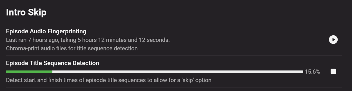

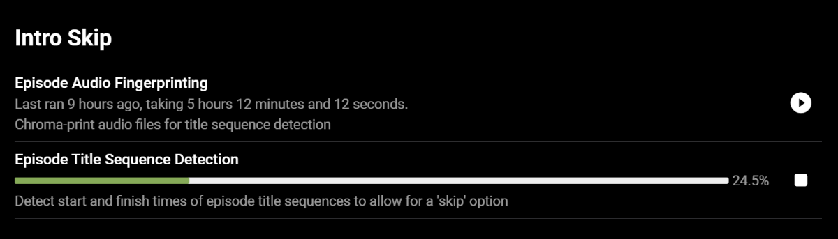

Sammy 791 Posted August 20, 2021 Posted August 20, 2021 (edited) Love you long time.. Fingerprinting kicked off about 12 hours ago. Title Sequence Detection kicked off about 2 hours ago. Edited August 20, 2021 by Sammy 1 1
