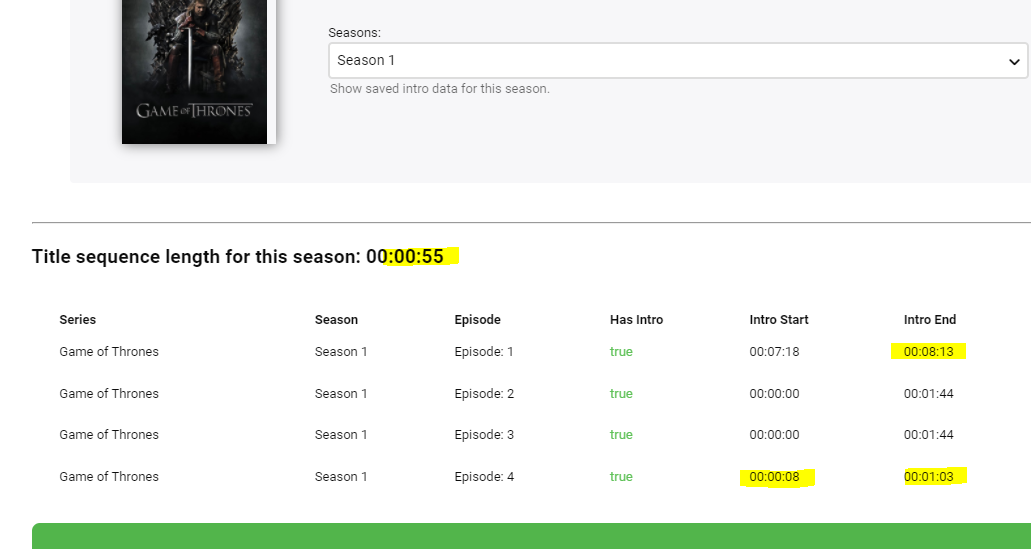

chef 3811 Posted August 18, 2021 Posted August 18, 2021 1 hour ago, samuelqwe said: Start times seem to be fine, so it would be interesting to see why it’s going wrong at the end. If possible, could you send me the .bin fingerprint files for season 1? I’d like to perform some tests to find out why it isn’t working. Here are 20 minute .bin files for GOT ep1 and GOT ep2 GOT.ep1.bin GOT.ep2.bin 1
chef 3811 Posted August 18, 2021 Posted August 18, 2021 (edited) I've been randomly auditing episodes in random series, and most of them seem to spot on, to close enough (with in a second). I'm not sure what is wrong with GOT. You'd think with a massive title sequence like that, would be one of the easier series to calculate. Edited August 18, 2021 by chef
samuelqwe 317 Posted August 18, 2021 Posted August 18, 2021 1 minute ago, chef said: I've been randomly auditing episodes in random series, and most of them seem to spot on, to close enough (with in a second). I'm not sure what is wrong with GOT. You'd think with a massive title sequence like that, would be one of the easier series to calculate. There must be something that's interrupting it just long enough to trick the system into thinking that's the end of the intro. I am looking into it.
chef 3811 Posted August 18, 2021 Posted August 18, 2021 Just now, samuelqwe said: There must be something that's interrupting it just long enough to trick the system into thinking that's the end of the intro. I am looking into it. Like using a secondary server on a different machine, and requesting data from drives over a network connection... Type of interruptions?
samuelqwe 317 Posted August 18, 2021 Posted August 18, 2021 1 minute ago, chef said: Like using a secondary server on a different machine, and requesting data from drives over a network connection... Type of interruptions? Sorry I wasn’t clear, I meant in the comparison between the two episodes there must be a slight difference in the intros that is just different for long enough to cause the algorithm to think the intro ended.
rbjtech 5345 Posted August 18, 2021 Posted August 18, 2021 (edited) It does seem odd - the 'HBO' bit is very short (and should be ignored?), but the GoT theme is constant - there are no sound breaks in it .. My test is on a local machine - Season 2 is ok, so it's 'something' about those Season 1 files. I have a different source (4K) from the UHD's - it will take a while to copy them over, but I'm going to see if the same thing happens with those .. they also don't have recaps .. Edited August 18, 2021 by rbjtech

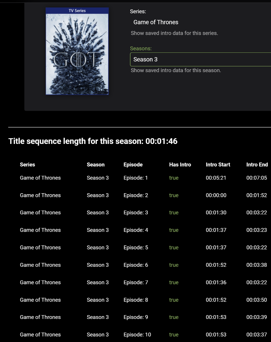

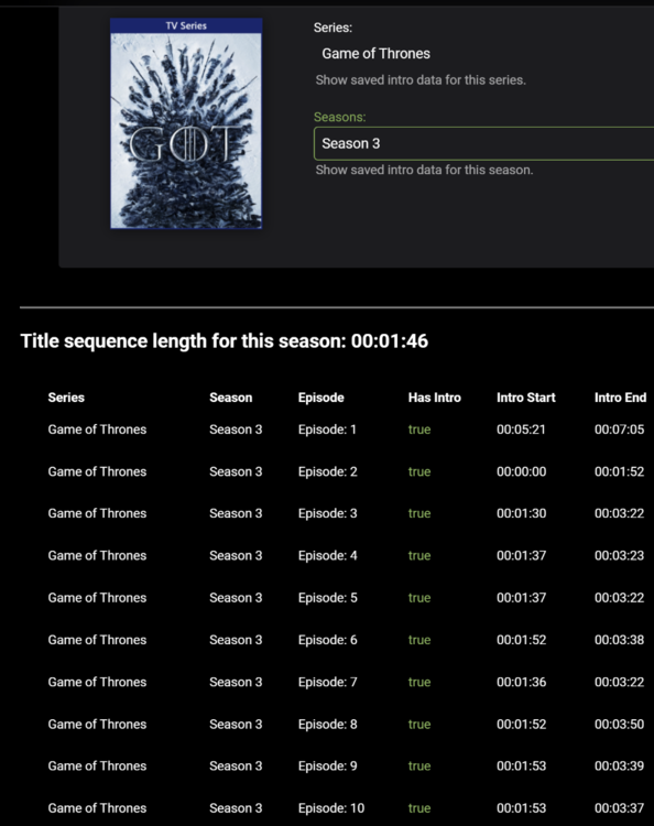

Sammy 791 Posted August 18, 2021 Posted August 18, 2021 For whatever reason I don't have Seasons 1 or 2 and I need to fix that but here's my results for Season 3. Do you need anything other than this graphic?
rbjtech 5345 Posted August 18, 2021 Posted August 18, 2021 (edited) 3 minutes ago, Sammy said: For whatever reason I don't have Seasons 1 or 2 and I need to fix that but here's my results for Season 3. Do you need anything other than this graphic? Do you have a screen grab of Season 1 and what is the source, disk or OTA/Cable (with 'recaps') ? sorry - just re-read your post - ignore me ! Edited August 18, 2021 by rbjtech
Sammy 791 Posted August 18, 2021 Posted August 18, 2021 Source is Sonarr.. IIR most of mine had recaps but it has been a while since I watched this series.

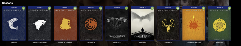

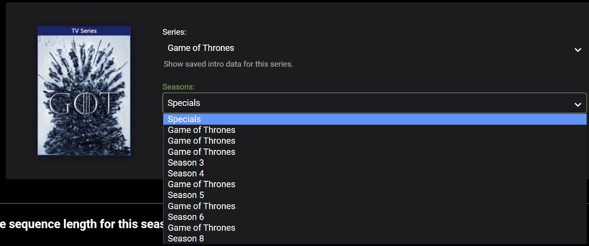

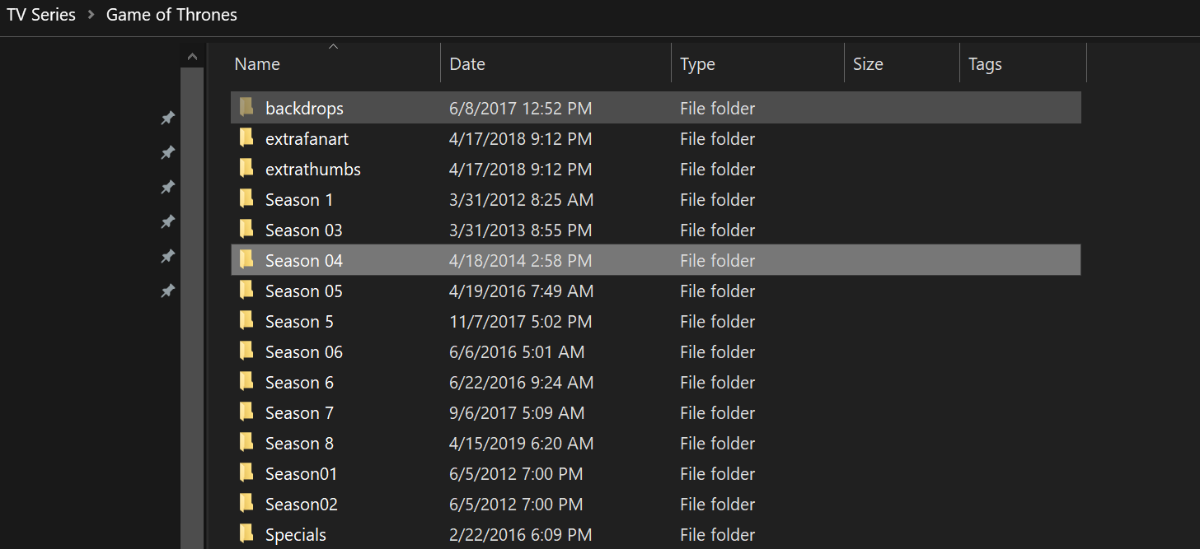

Sammy 791 Posted August 18, 2021 Posted August 18, 2021 (edited) I have all of them it seems.. My library is a bit of a mess but Emby seems to get it right.. Whereas the plugin shows this: Edited August 18, 2021 by Sammy 1
samuelqwe 317 Posted August 18, 2021 Posted August 18, 2021 (edited) 19 minutes ago, Sammy said: I have all of them it seems.. My library is a bit of a mess but Emby seems to get it right.. Whereas the plugin shows this: They’re both showing the same thing. If you look closely, Emby is also naming those seasons "Game of Thrones". Also, you seem to have doubles of many seasons, so that might be confusing Emby. @chef I’m still testing with the fingerprints, but I believe my hypothesis is correct. It seems there are bits in the intro that are just different for long enough to cut off the detection early. I don’t know why that’s the case, but it’s what I’m seeing. Edited August 18, 2021 by samuelqwe

Sammy 791 Posted August 18, 2021 Posted August 18, 2021 3 hours ago, samuelqwe said: They’re both showing the same thing. If you look closely, Emby is also naming those seasons "Game of Thrones". Also, you seem to have doubles of many seasons, so that might be confusing Emby. Well! I only looked at the top, not the bottom..

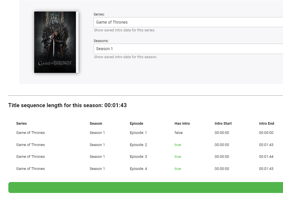

rbjtech 5345 Posted August 19, 2021 Posted August 19, 2021 Thanks guys - will try this out today. Your results are similar to mine when using the 4K 'clean' source (remux). Post All is well with Season 1 with the exception of Episode 1, which then throws a spanner in the works if you re-add it. I'm going to experiment today (copying Ep1 as Ep2, 3, 4 etc to see if it then picks it up properly.) Also - which Audio track is it using (presumably the default one) and is it doing a channel 'mix' and then analysis a mono track ? In other words, does the Audio track type make any difference to what is being analysed ?
rbjtech 5345 Posted August 19, 2021 Posted August 19, 2021 (edited) So I think I see what is going on - I've created my own S1 episodes from the 4K Remux (very low Video quality, but Stereo AAC from the THD Atmos Track) - I did to ensure I have a solid baseline and also to speed up the process. I believe the HBO part IS important - as Ep1 - You get the HBO at the start (8 seconds), then you get the Intro ~7 minutes in but with no extra HBO. All the other episodes have HBO as part of the Intro, so Ep1 is NOT the same as all the other episodes.. I'm going to edit Ep1 to put the HBO back in just before the real Intro - and I'm betting it then picks it back up and with the correct timings like Ep2,3,4 etc Edited August 19, 2021 by rbjtech
chef 3811 Posted August 19, 2021 Posted August 19, 2021 I'm testing some new code. If the seasons episode count is big enough, try comparing the episode (with no sequence data) with more then one other episode, and check the results against each other to see if there is a large discrepancy in the result. It will cause longer scan times, but is worth getting the best data possible.
rbjtech 5345 Posted August 19, 2021 Posted August 19, 2021 I don't think the code is the problem - it is doing exactly as it was designed to do. In summary Ep1 is not being picked up as having an Intro - which is 'correct' as it's intro does not match the other episodes. I'm just proving the point by inserting the full Intro into Ep1 - but having trouble with matching the I-frames as it didn't like my previous attempt - so I assume it has to be bit-perfect (ie not an 'insert' ) 1
