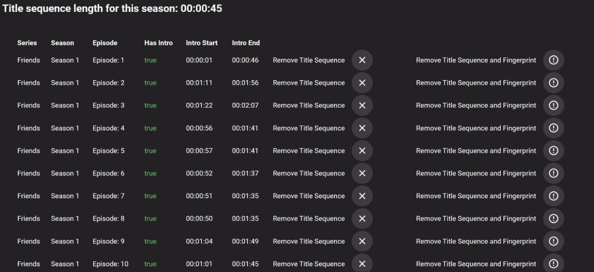

Sammy 791 Posted August 14, 2021 Posted August 14, 2021 (edited) Just for reference. As expected, the title sequence for Friends is a bit more than a 30 second skip... Edited August 14, 2021 by Sammy 1
