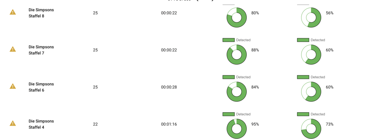

samuelqwe 317 Posted March 24, 2022 Posted March 24, 2022 (edited) 25 minutes ago, chef said: Do you think it is the length of the encoding we are grabbing in this instance? Simpsons is a 30 minutes show. Unlikely, since Simpsons episodes seem to be around 20 to 25 minutes, and we’ve had great success with episodes of that length. Knowing if it affects all seasons or just a few would be useful information to help diagnose this further. On a more technical note, I’ve noticed FFmpeg offers us a few different versions of the chromaprint algorithm. We’ve always just used the default option, but I’m wondering if perhaps one of the other versions might give us a better result? Might be a good idea to test on a small subset of shows to see if there are any differences with detection accuracy. Just something to think about. Edited March 24, 2022 by samuelqwe 1
slevin7 86 Posted March 24, 2022 Posted March 24, 2022 25 minutes ago, chef said: Hmm... Is it all the seasons? It is 25 minutes ago, chef said: @slevin7 it has been a while since I have watched an episode. Do the intros always happen at the very beginning of the episode? Mostly yes. 2 minutes ago, samuelqwe said: Knowing if it affects all seasons or just a few would be useful information to help diagnose this further. Some are worse But older seasons are better. Is it possible that only the first episode is scanned? especially with the Simpsons, a lot has changed, also in terms of the intro and the famous Maggie cash beep.
samuelqwe 317 Posted March 24, 2022 Posted March 24, 2022 7 minutes ago, slevin7 said: Is it possible that only the first episode is scanned? especially with the Simpsons, a lot has changed, also in terms of the intro and the famous Maggie cash beep. Every episode within a season is compared to every other one within that same season. We do this so we can look at all the possible matches and get a better idea of if the results are correct or not. Looks like we’ll have to do some further testing to figure out why this might be happening, because I would’ve expected Simpsons to have a better result. 1
slevin7 86 Posted March 24, 2022 Posted March 24, 2022 I see let me know if I can help you in any way
Cheesegeezer 3106 Posted March 24, 2022 Posted March 24, 2022 1 hour ago, chef said: Hmm... Is it all the seasons? @samuelqwe@rbjtech@Cheesegeezer Do you think it is the length of the encoding we are grabbing in this instance? Simpsons is a 30 minutes show. @slevin7 it has been a while since I have watched an episode. Do the intros always happen at the very beginning of the episode? Always happen right at the start.and 20mins is plenty of time. Are you thinking for 30min we only look at first 10mins. 1 that would improve the scan times and 2 possible higher chance of success

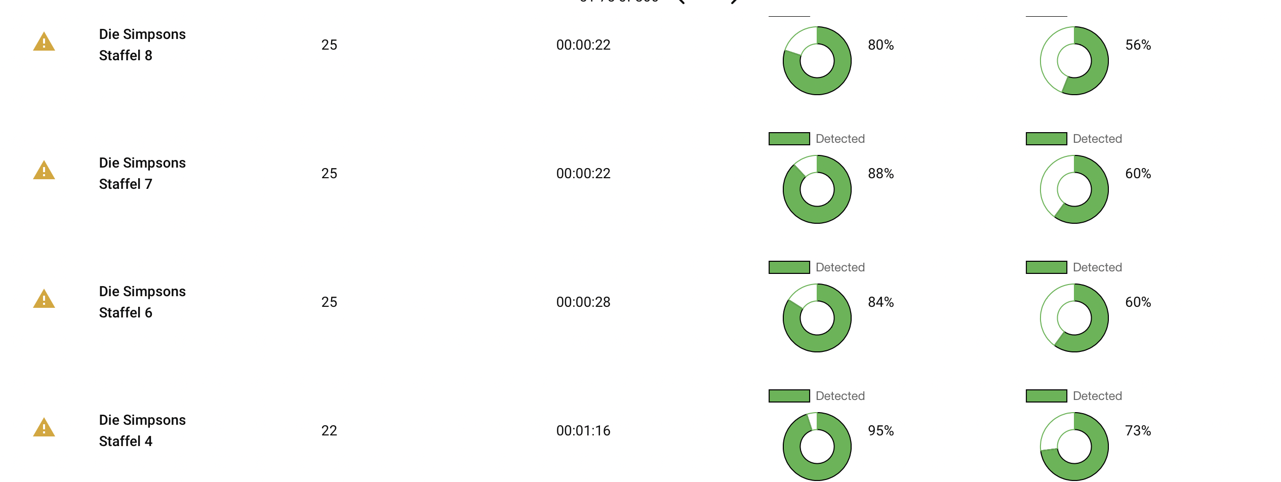

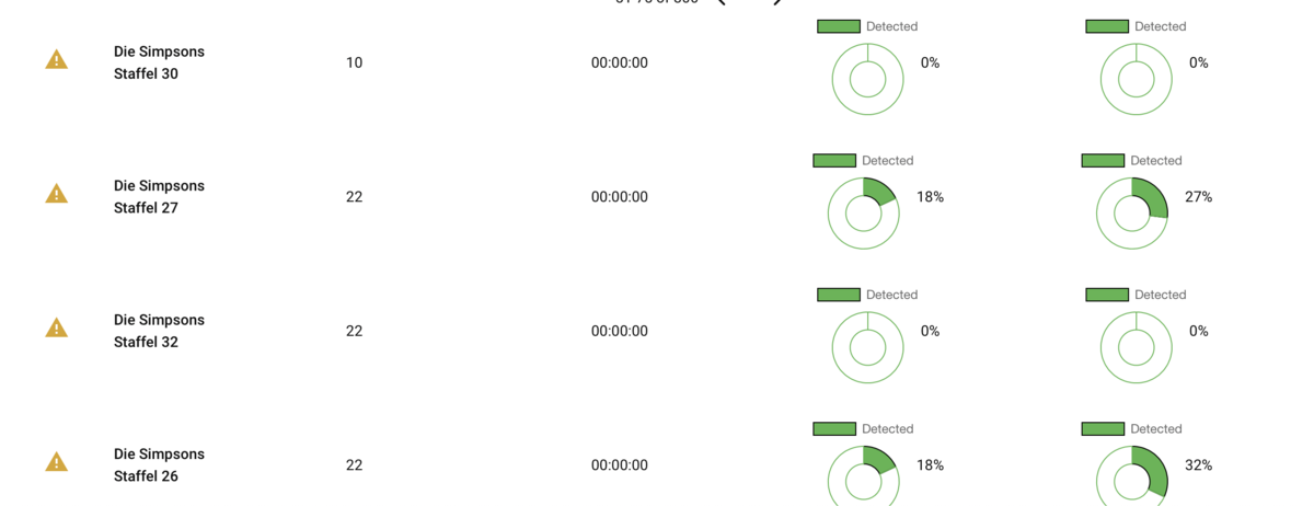

Painkiller88 250 Posted March 24, 2022 Posted March 24, 2022 yes i can confirm this, simpsons was one of the most problematic show i have. I had to manually do almost every season and they have 33 now, so a lot of work intros are 95% almost at the very beginning and the intros are all the same till it comes to the couch scene, here it is different for every episode, also to mention halloween and xmas are very different from all the rest of the seasons 1 1
chef 3811 Posted March 24, 2022 Posted March 24, 2022 1 hour ago, Cheesegeezer said: Always happen right at the start.and 20mins is plenty of time. Are you thinking for 30min we only look at first 10mins. 1 that would improve the scan times and 2 possible higher chance of success Unless it is another GOT type of problem, where for whatever reason it is undetectable. If we took a shorter encoding we might miss the intros on shows that have recaps/story line in the beginning. Really weird that we wouldn't be able to hamm that audio though. At some point between all those episodes we should eventually get a match.

slevin7 86 Posted March 28, 2022 Posted March 28, 2022 On 3/24/2022 at 10:09 PM, Painkiller8818 said: ntros are 95% almost at the very beginning and the intros are all the same till it comes to the couch scene, here it is different for every episode, also to mention halloween and xmas are very different from all the rest of the seasons oh, what i had forgotten is the Blackboardjoke, which is always read out in german. Yes now I think why the Simpsons are so hard.

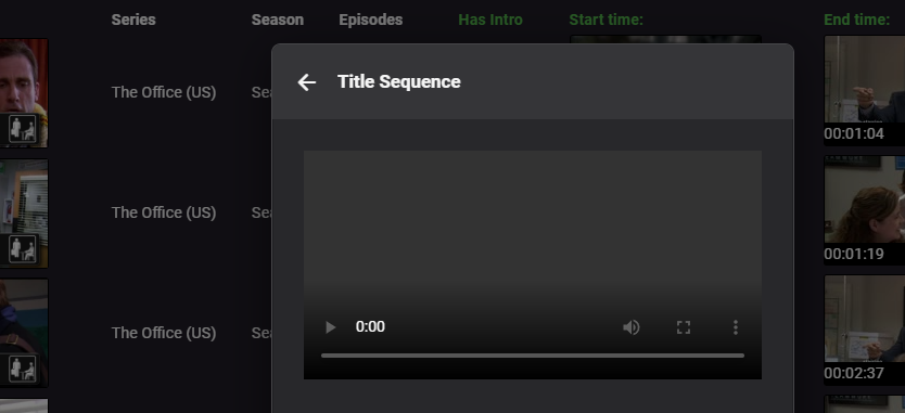

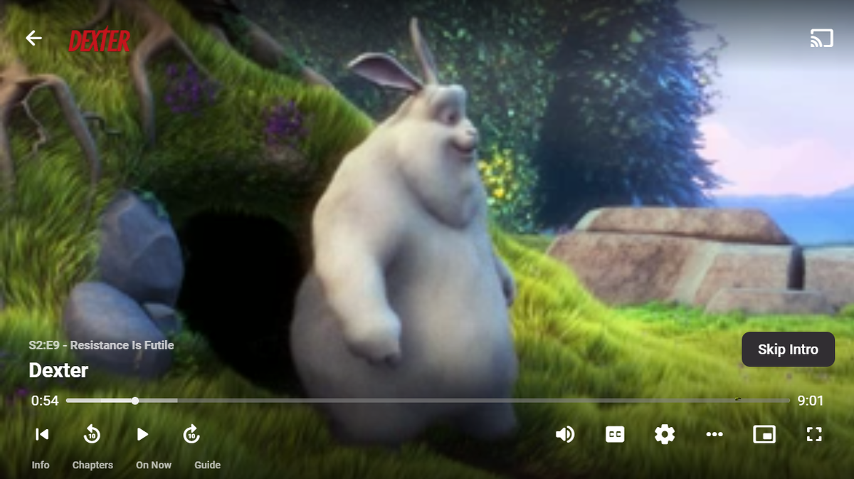

seanbuff 1356 Posted April 2, 2022 Posted April 2, 2022 @chef so I finally tried clicking on the 'Preview' button on the episode thumbnail (which is a clever feature btw) However, nothing seemed to happen: Here's the error in my log for reference: 2022-04-02 12:47:29.496 Info Server: http/1.1 GET http://host1/emby/Videos/489435/stream.mp4?StartTimeTicks=621355968460000000&VideoCodec=h264&AudioCodec=mp3,aac&VideoBitrate=139616000&AudioBitrate=384000&AudioStreamIndex=1&SubtitleStreamIndex=12&SubtitleMethod=Hls&TranscodingMaxAudioChannels=2&SegmentContainer=m4s,ts&MinSegments=1&BreakOnNonKeyFrames=True&ManifestSubtitles=vtt&h264-profile=high,main,baseline,constrainedbaseline,high10&h264-level=52&TranscodeReasons=AudioCodecNotSupported,DirectPlayError&allowVideoStreamCopy=false&n=1648864049477. Accept=*/*, Host=mb.leandroid.cloud, User-Agent=Mozilla/5.0 (Windows NT 10.0; Win64; x64) AppleWebKit/537.36 (KHTML, like Gecko) Chrome/101.0.4951.15 Safari/537.36, Accept-Encoding=identity;q=1, *;q=0, Accept-Language=en-AU,en-US;q=0.9,en;q=0.8, Range=bytes=0-, Referer=https://mb.leandroid.cloud/emby/web/index.html, DNT=1, Sec-Ch-Ua=" Not A;Brand";v="99", "Chromium";v="101", "Google Chrome";v="101", Sec-Ch-Ua-Mobile=?0, Sec-Ch-Ua-Platform="Windows", Sec-Fetch-Dest=video, Sec-Fetch-Mode=cors, Sec-Fetch-Site=same-origin, X-Forwarded-For=10.1.1.1, X-Forwarded-Proto=https 2022-04-02 12:47:29.502 Error Server: Error processing request *** Error Report *** Version: 4.7.0.32 Command line: C:\Users\<username_obfuscated>\AppData\Roaming\Emby-Server\system\EmbyServer.dll -noautorunwebapp Operating system: Microsoft Windows 10.0.19044 Framework: .NET 6.0.2 OS/Process: x64/x64 Runtime: C:/Users/<username_obfuscated>/AppData/Roaming/Emby-Server/system/System.Private.CoreLib.dll Processor count: 16 Data path: C:\Users\<username_obfuscated>\AppData\Roaming\Emby-Server\programdata Application path: C:\Users\<username_obfuscated>\AppData\Roaming\Emby-Server\system System.ArgumentException: System.ArgumentException: An item with the same key has already been added. Key: 2 at System.Collections.Generic.Dictionary`2.TryInsert(TKey key, TValue value, InsertionBehavior behavior) at System.Collections.Generic.Dictionary`2.Add(TKey key, TValue value) at Emby.Server.MediaEncoding.Encoder.Demands.DemandsBuilder.BuildDemands(EncodingJobInfo state, EncodingDiagnosticOptions diagnosticOptions) at Emby.Server.MediaEncoding.Encoder.TranscodingCommandBuilder.BuildDemands(EncodingJobInfo state) at Emby.Server.MediaEncoding.Encoder.TranscodingCommandBuilder.GetProgressiveVideoFullCommandLine(EncodingJobInfo state, String outputPath) at Emby.Server.MediaEncoding.Api.Progressive.VideoService.GetCommandLineArguments(String outputPath, StreamState state) at Emby.Server.MediaEncoding.Api.BaseStreamingService.StartFfMpeg(StreamState state, String outputPath, CancellationToken cancellationToken, Boolean acquireResources) at Emby.Server.MediaEncoding.Api.BaseStreamingService.StartFfMpeg(StreamState state, String outputPath, CancellationToken cancellationToken, Boolean acquireResources) at Emby.Server.MediaEncoding.Api.Progressive.BaseProgressiveStreamingService.GetStreamResult(StreamState state, IDictionary`2 responseHeaders, Boolean isHeadRequest, CancellationToken cancellationToken) at Emby.Server.MediaEncoding.Api.Progressive.BaseProgressiveStreamingService.ProcessRequest(StreamRequest request, Boolean isHeadRequest) at Emby.Server.Implementations.Services.ServiceController.GetTaskResult(Task task) at Emby.Server.Implementations.Services.ServiceHandler.ProcessRequestAsync(HttpListenerHost appHost, IRequest httpReq, IResponse httpRes, RestPath restPath, String responseContentType, CancellationToken cancellationToken) at Emby.Server.Implementations.HttpServer.HttpListenerHost.RequestHandler(IRequest httpReq, ReadOnlyMemory`1 urlString, ReadOnlyMemory`1 localPath, CancellationToken cancellationToken) Source: System.Private.CoreLib TargetSite: Void ThrowAddingDuplicateWithKeyArgumentException[T](T) 2022-04-02 12:47:29.502 Info Server: http/1.1 Response 400 to 10.1.1.1. Time: 6ms. http://host1/emby/Videos/489435/stream.mp4?StartTimeTicks=621355968460000000&VideoCodec=h264&AudioCodec=mp3,aac&VideoBitrate=139616000&AudioBitrate=384000&AudioStreamIndex=1&SubtitleStreamIndex=12&SubtitleMethod=Hls&TranscodingMaxAudioChannels=2&SegmentContainer=m4s,ts&MinSegments=1&BreakOnNonKeyFrames=True&ManifestSubtitles=vtt&h264-profile=high,main,baseline,constrainedbaseline,high10&h264-level=52&TranscodeReasons=AudioCodecNotSupported,DirectPlayError&allowVideoStreamCopy=false&n=1648864049477 Using latest Beta Server (4.7.0.32) + IntroSkip 0.0.1.96 Let me know if you need the full log. 1
chef 3811 Posted April 2, 2022 Posted April 2, 2022 Hmmm... I wonder if I'm supposed to do this... I maybe breaking some top secret stuff here... I hope everyone is sitting down for this... 9
seanbuff 1356 Posted April 2, 2022 Posted April 2, 2022 20 minutes ago, chef said: I hope everyone is sitting down for this... Amazing! 3

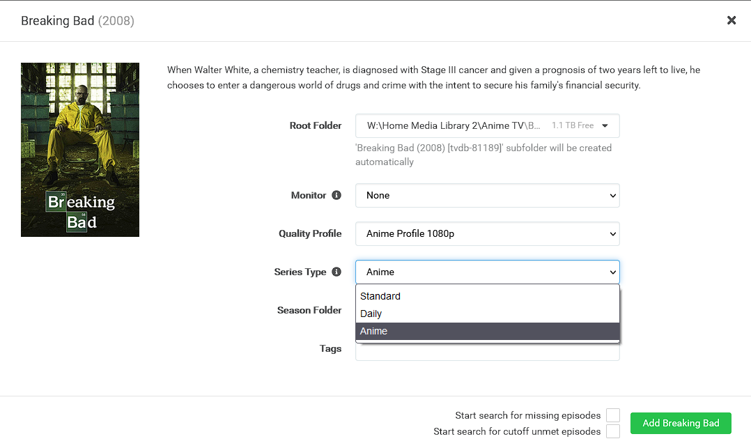

Weevillo 30 Posted April 2, 2022 Posted April 2, 2022 Hi, So was wondering: Would it be possible to add the option to set the minimum length for an intro on a general, show or seasonal level? I've got a library that consist of only anime and it would probably eliminate close to all of the false positives (since anime intros are always either 1:30 or they just don't put one in then for that episode) if I just set the minimum intro length to 1 minute or something like that. Either that or do something like Sonarr with a drop-down option with a fixated minimum, but I would prefer the first option if possible. P.S: That skip button turned out great! Blends in super well.

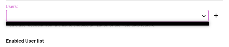

FrogMaster 27 Posted April 3, 2022 Posted April 3, 2022 (edited) Currently running into an issue where I am unable to select dropdown options for the following menus: Users: OR TV Shows to exclude from scans: They both will appear with a partial dropdown and no actual information or options to choose from. This is preventing me from choosing users I want to Enable/Disable the feature for. It also seems to be preventing me from using IntroSkip as when I go to a TV Show that an intro has been detected for, the intro is not skipped automatically even though the settings to auto skip are enabled. IntroSkip: 0.0.1.96 Emby Version: 4.7.0.32 beta Any thoughts on how I could correct this to get the plugin working? Edited April 3, 2022 by FrogMaster
rbjtech 5345 Posted April 3, 2022 Posted April 3, 2022 (edited) 8 minutes ago, FrogMaster said: Currently running into an issue where I am unable to select dropdown options for the following menus: Users: OR TV Shows to exclude from scans: They both will appear with a partial dropdown and no actual information or options to choose from. This is preventing me from choosing users I want to Enable/Disable the feature for. It also seems to be preventing me from using IntroSkip as when I go to a TV Show that an intro has been detected for, the intro is not skipped automatically even though the settings to auto skip are enabled. IntroSkip: 0.0.1.96 Emby Version: Version 4.7.0.32 beta Any thoughts on how I could correct this to get the plugin working? Did this work ok in a previous Emby (beta) version ? Also please turn on Debug logging, let an episode try and Auto-Skip and send the embyserver.txt log file as this contains the verbose logging for Introskip and we can easily see if the skip is being attempted. Thanks. Edited April 3, 2022 by rbjtech
FrogMaster 27 Posted April 3, 2022 Posted April 3, 2022 2 minutes ago, rbjtech said: Did this work ok in a previous Emby version ? I was only just recently made aware of Intro Skip so unfortunately I cannot say, I never had the opportunity to use it in an older release.
FrogMaster 27 Posted April 3, 2022 Posted April 3, 2022 Oddly, rebooting the entire Jail for a second time seems to have resolved this and I can now select users/tv shows. I had done a full reboot on the initial install of the plugin, but I guess it needed another one. ¯\_(ツ)_/¯
