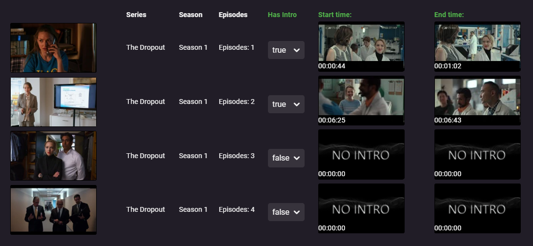

seanbuff 1356 Posted March 15, 2022 Posted March 15, 2022 1 hour ago, rbjtech said: Do you have any examples ? (names of shows) I've got an example of a false positive. The new series 'The Dropout' - the first two eps get detected with an "intro" during two key dialog scenes. The series doesn't actually have an intro, but while the same music makes an appearance during these two scenes - the dialog over the top makes them unique which i thought would have changed the audio fingerprint just enough. I realise that 4 episodes may not be enough, but I figured I'd raise it anyway. Thanks.

rbjtech 5345 Posted March 15, 2022 Posted March 15, 2022 7 hours ago, seanbuff said: I've got an example of a false positive. The new series 'The Dropout' - the first two eps get detected with an "intro" during two key dialog scenes. The series doesn't actually have an intro, but while the same music makes an appearance during these two scenes - the dialog over the top makes them unique which i thought would have changed the audio fingerprint just enough. I realise that 4 episodes may not be enough, but I figured I'd raise it anyway. Thanks. Thanks. I have the same show but no Intro Detected (correctly). The two reasons for the difference could be 1) Different sources files or 2) I have modified my IntroSkip.xml detection settings as per below but I think the HammingDistance will likely be the same as Default. <TitleSequenceLengthThreshold>5</TitleSequenceLengthThreshold> <HammingDistanceThreshold>8</HammingDistanceThreshold> <DetectionConfidence>0.6</DetectionConfidence> <BlackDetectionPixelThreshold>0</BlackDetectionPixelThreshold> <BlackDetectionSecondIntervals>0.05</BlackDetectionSecondIntervals>

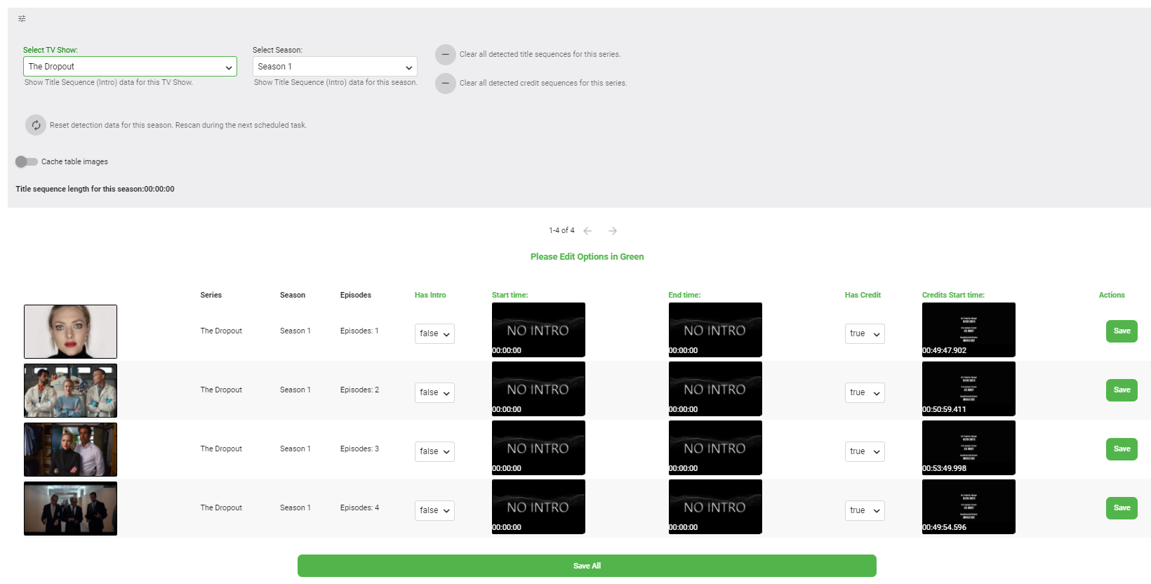

chef 3811 Posted March 15, 2022 Posted March 15, 2022 1 minute ago, rbjtech said: Thanks. I have the same show but no Intro Detected (correctly). The two reasons for the difference could be 1) Different sources files or 2) I have modified my IntroSkip.xml detection settings as per below but I think the HammingDistance will likely be the same as Default. <TitleSequenceLengthThreshold>5</TitleSequenceLengthThreshold> <HammingDistanceThreshold>8</HammingDistanceThreshold> <DetectionConfidence>0.6</DetectionConfidence> <BlackDetectionPixelThreshold>0</BlackDetectionPixelThreshold> <BlackDetectionSecondIntervals>0.05</BlackDetectionSecondIntervals> The hamming distance offset value of 8 is actually hard coded, the node in the xml is just a left over from testing. I'm going to get Dropout and do some testing. I wouldn't have thought that the offset would be large enough to allow for dialogue over common theme music to pass the hamming distance comparisons. But I suppose anything could happen. One mis detection out of a seasons worth of episodes is still fine with me though. That hits the 80% reliability, as far as I'm concerned. That is why we have the editor.

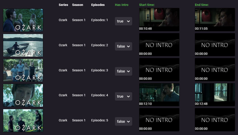

diogee 17 Posted March 16, 2022 Posted March 16, 2022 On 15/03/2022 at 09:47, chef said: Indeed, a list of a couple tv show that didn't get their intros detected would be great. Ozark is one show that I have found generates intros across each season but it doesn't actually have an Intro I'm also noticing that new episodes are not being automatically scanned, the option is definitely enabled but it's acting like the hook to trigger on a new episode doesn't exist? I'd share logs but, well, it doesn't generate any. Not even debug logs. Tailing the logs I can clearly see new eps getting added and processed and having their related Scripter-X addon tasks triggered but the IntroSkip tasks just sit there twiddling their little digital thumbs waiting for something to do and I have to run the task manually. I've just scheduled it for every hour as a workaround but having the tasks work correctly would be awesome. It's possible my search-fu is lacking today but I wasn't able to find anything on this particular matter except a couple stray comments from last year/much older version of IntroSkip so not sure if they are even relevant

chef 3811 Posted March 16, 2022 Posted March 16, 2022 10 minutes ago, Goggleboxer said: @rbjtech @chef Yes, please see screenshots attached for a few recent examples of failed detections. Thanks for the explanation regarding skipping recaps. Can't blame me for dreaming. Cheers. How long is the intro for Ozarks? If an intro is under ten seconds we ignore it. Thank you for taking the time to take part in the testing.
seanbuff 1356 Posted March 16, 2022 Posted March 16, 2022 2 hours ago, chef said: How long is the intro for Ozarks? Ozark is troublesome for me also. I get a random 38 sec sequence detected for Season 01 And another 17 sec sequence detected for Season 03

Cheesegeezer 3106 Posted March 16, 2022 Posted March 16, 2022 5 hours ago, chef said: How long is the intro for Ozarks? If an intro is under ten seconds we ignore it. Thank you for taking the time to take part in the testing. Hi Chef, The intros are very short ranging from about 15 - 20 max. the music is often different. Here is an example of all the intros from season 2.
rbjtech 5345 Posted March 16, 2022 Posted March 16, 2022 Having a listen to the actual 'Intro's picked up in Ozark myself - On a couple that I listened to - some episodes DO have a similar undertone music in those sequences and that is what I believe Introskip is picking up on (but agree 100% they are not Intros..) but it's not true for all the episodes in that season - it's a bit odd I agree. This is actually what the 'Clear All Detected Title Sequences' button is there for as I noticed this phenomenon during the development and testing a few months ago - the same for Credit's if that is the issue. Use cautiously though, as it clears ALL Intros's from ALL Seasons for that show - not just the Selected Season. Also worthy of note which many do not realise, is you can actually play the 'Intro' part directly from the Plugin GUI if Intro = True - just click on the Green 'Play' Icon on the left hand thumbnail image. I should probably put that in the Wiki as well .. 2
diogee 17 Posted March 16, 2022 Posted March 16, 2022 2 minutes ago, rbjtech said: This is actually what the 'Clear All Detected Title Sequences' button is there for as I noticed this phenomenon during the development and testing a few months ago - the same for Credit's if that is the issue. Use cautiously though, as it clears ALL Intros's from ALL Seasons for that show - not just the Selected Season. Heh, yeahhhh, I'm still avoiding configuration pages wherever possible at the moment given my long load times on them still Having said that though, I did actually remove the intros manually from Ozark like an idiot the other day cause I both completely forgot that button existed and also totally didn't notice it to remind myself of it's existence. I think I was just having one of those kind of days at the time haha. Oh and the rest of my previous post wasn't specifically related to Ozark either in case that gets mixed up! 7 hours ago, diogee said: I'm also noticing that new episodes are not being automatically scanned, the option is definitely enabled but it's acting like the hook to trigger on a new episode doesn't exist? This is true of any and all new content that gets added to my libraries
