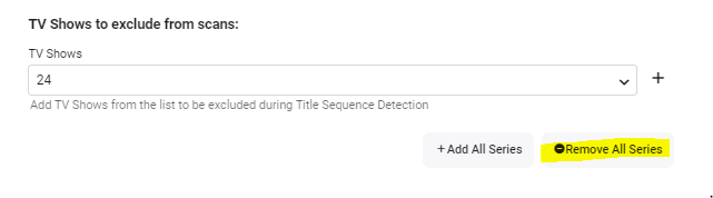

rbjtech 5345 Posted March 12, 2022 Posted March 12, 2022 (edited) 16 hours ago, samuelqwe said: If you’re using Docker, Emby should already have what you need in the stable version. So give it a try and let us know how it goes I would suggest trialling with a subset of the 104Tb of data though You can either setup another instance of emby to test or you can exclude all shows using the Plugin Advanced options - and then remove a couple of shows (ie now INCLUDED) to test. Let us know how it goes. Edited March 12, 2022 by rbjtech 1
