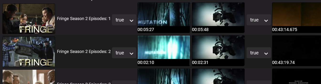

DarKni8 41 Posted March 7, 2022 Posted March 7, 2022 Ok guys i got the markers. Shoutout to chef and rbjtech, I think you people nailed this functionality completely, almost. I hope now luke also gets many thing right for next release. Also now what would be my next step? I will get button on my android tv or something to skip them or i should enable auto skip as of now?
