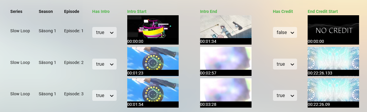

Weevillo 30 Posted January 26, 2022 Posted January 26, 2022 1 hour ago, rbjtech said: then it makes no difference as every episode will be compared to all other episodes in that season. Hmm, yet there's a tendency by the plugin to fail detecting the first episode correctly. I'll attach some pictures to give a sample. Here's a show airing right now, the first episode should not have intro time stamps, the other two episodes are correctly detected. Another show airing, where I manually turned of the intro detection since it was also a false positive. A show that's aired in two parts with two different intros, the second intro of the second part's first episode was detected correctly, but here the first episode's a false positive (episode 3 as well for some reason). Here's a show that aired back in 2017 and comes from a blue-ray source, in contrast to the 3 aforementioned shows that have a TV source. Same issue on the first episode, and to boot it also got episode 5 wrong by 1:10 mins. You've obviously designed the plugin to be able to deal with different intros in a show, but could this be a consequence of how you programmed that behavior? In other words: Does the plugin think that episode 1 and 5 here have similar intros and therefore said "Well, I found two audio signatures that matches, they must be intros"? It would make sense in this case, since this show has a philosophical quote at the beginning of every episode accompanied by a distinct church bell sound, but that's not the case in any other show I posses. I don't know how much these SS helps, I was hoping to paint a clearer picture at least. 1 hour ago, rbjtech said: I'll take the chapters conversation offline with the introskip team - for 99.9% of the shows I have (non of them Anime) they do not use any form of bespoke Chapters, yet alone Intro and Credit - but if Anime does, then I think we may be able to utilise that to our advantage as you say. Thanks! You'll see chapters in anime more often than you won't, especially intro/outro ones since that's a huge part of the "anime experience". 1 hour ago, rbjtech said: The Auto-Skip control is server side - ie the client position has nothing to do with the trigger points. So if the playback on the server hits a trigger point, then it should in that microsecond send a 'new position' to the client. We have found that as the Introskip is extremely accurate, the skip can be seamless and other than the 'message' (if you opt to have that) you may not actually know it has been skipped at all... I can't report the same, for me it seems that the client and server is heavily out of sync (heavily as in <5 seconds, but that's still significant). Did you test the plugin with a beta version running on your respective clients? FYI I've tested this with the latest server beta and the official Shield/Android TV release. When I check the control panel it reports the timestamps something like "...2:40...2:42...2:43...2:46...2:47...". I can't make out if this is the client or server lagging after, though. All in all this result in the plugin skipping the intro about 5 seconds in. 1 hour ago, rbjtech said: The Manual button is on the horizon, but as this requires Core development work (non-Plugin), we don't have any confirmed or committed dates but we do have very positive engagement with the Core Dev team to get it added. Does it look like it''ll be added to the next stable release of the server? As always thanks for the engagement with the community

rbjtech 5345 Posted January 26, 2022 Posted January 26, 2022 1 hour ago, Weevillo said: Hmm, yet there's a tendency by the plugin to fail detecting the first episode correctly. I'll attach some pictures to give a sample. Here's a show airing right now, the first episode should not have intro time stamps, the other two episodes are correctly detected. Another show airing, where I manually turned of the intro detection since it was also a false positive. A show that's aired in two parts with two different intros, the second intro of the second part's first episode was detected correctly, but here the first episode's a false positive (episode 3 as well for some reason). Here's a show that aired back in 2017 and comes from a blue-ray source, in contrast to the 3 aforementioned shows that have a TV source. Same issue on the first episode, and to boot it also got episode 5 wrong by 1:10 mins. You've obviously designed the plugin to be able to deal with different intros in a show, but could this be a consequence of how you programmed that behavior? In other words: Does the plugin think that episode 1 and 5 here have similar intros and therefore said "Well, I found two audio signatures that matches, they must be intros"? It would make sense in this case, since this show has a philosophical quote at the beginning of every episode accompanied by a distinct church bell sound, but that's not the case in any other show I posses. I don't know how much these SS helps, I was hoping to paint a clearer picture at least. Thanks! You'll see chapters in anime more often than you won't, especially intro/outro ones since that's a huge part of the "anime experience". I can't report the same, for me it seems that the client and server is heavily out of sync (heavily as in <5 seconds, but that's still significant). Did you test the plugin with a beta version running on your respective clients? FYI I've tested this with the latest server beta and the official Shield/Android TV release. When I check the control panel it reports the timestamps something like "...2:40...2:42...2:43...2:46...2:47...". I can't make out if this is the client or server lagging after, though. All in all this result in the plugin skipping the intro about 5 seconds in. Does it look like it''ll be added to the next stable release of the server? As always thanks for the engagement with the community It would be interesting to match a Debug log to one of the above examples. For each Episode 'analysed' - it will show exactly what it did and what episodes it compared against - finishing with a summary of the results. For you - It does seem like Episode 1 is not playing by the 'rules' of the other episodes - and tbh I'm not sure why - a log will certainly help us find out
Weevillo 30 Posted January 26, 2022 Posted January 26, 2022 16 minutes ago, rbjtech said: It would be interesting to match a Debug log to one of the above examples. For each Episode 'analysed' - it will show exactly what it did and what episodes it compared against - finishing with a summary of the results. For you - It does seem like Episode 1 is not playing by the 'rules' of the other episodes - and tbh I'm not sure why - a log will certainly help us find out Should I clear one of the seasons I showcased, rerun the thing while dubug is enabled and then come back with the log (if I've understood it correctly)? If it doesn't yield the same results it'd certainly be interesting
rbjtech 5345 Posted January 26, 2022 Posted January 26, 2022 6 minutes ago, Weevillo said: Should I clear one of the seasons I showcased, rerun the thing while dubug is enabled and then come back with the log (if I've understood it correctly)? If it doesn't yield the same results it'd certainly be interesting Exactly - that would be useful. At the moment, the .bin files are not removed - so it is actually going to re-calculate exactly the same as it did before (or should !) thanks ! 1

Weevillo 30 Posted January 26, 2022 Posted January 26, 2022 @rbjtechAlright, hope this helps. I've added one show or so since I last ran the plugin so it did the intros for those ones as well. But the one you should be looking for is "Classroom of the Elite", that's the one I reset (yielded the same results as expected). IntroSkipServerLog.txt 1
rbjtech 5345 Posted January 26, 2022 Posted January 26, 2022 8 minutes ago, Weevillo said: @rbjtechAlright, hope this helps. I've added one show or so since I last ran the plugin so it did the intros for those ones as well. But the one you should be looking for is "Classroom of the Elite", that's the one I reset (yielded the same results as expected). ok - so I've filtered the log so it just shows everything to do with 'Classroom of the Elite' classroom-filter.txt As you say, S1E1 is showing the exact same IntroStart/End as the other episode but you are saying that is not the case - it has no Intro at all - have I understood you correctly ?
Weevillo 30 Posted January 26, 2022 Posted January 26, 2022 6 minutes ago, rbjtech said: it has no Intro at all - have I understood you correctly ? Right, for this particular show the first episode lacks an intro, as do all the shows in the screenshots I sent earlier which suffer from the same "problem".
