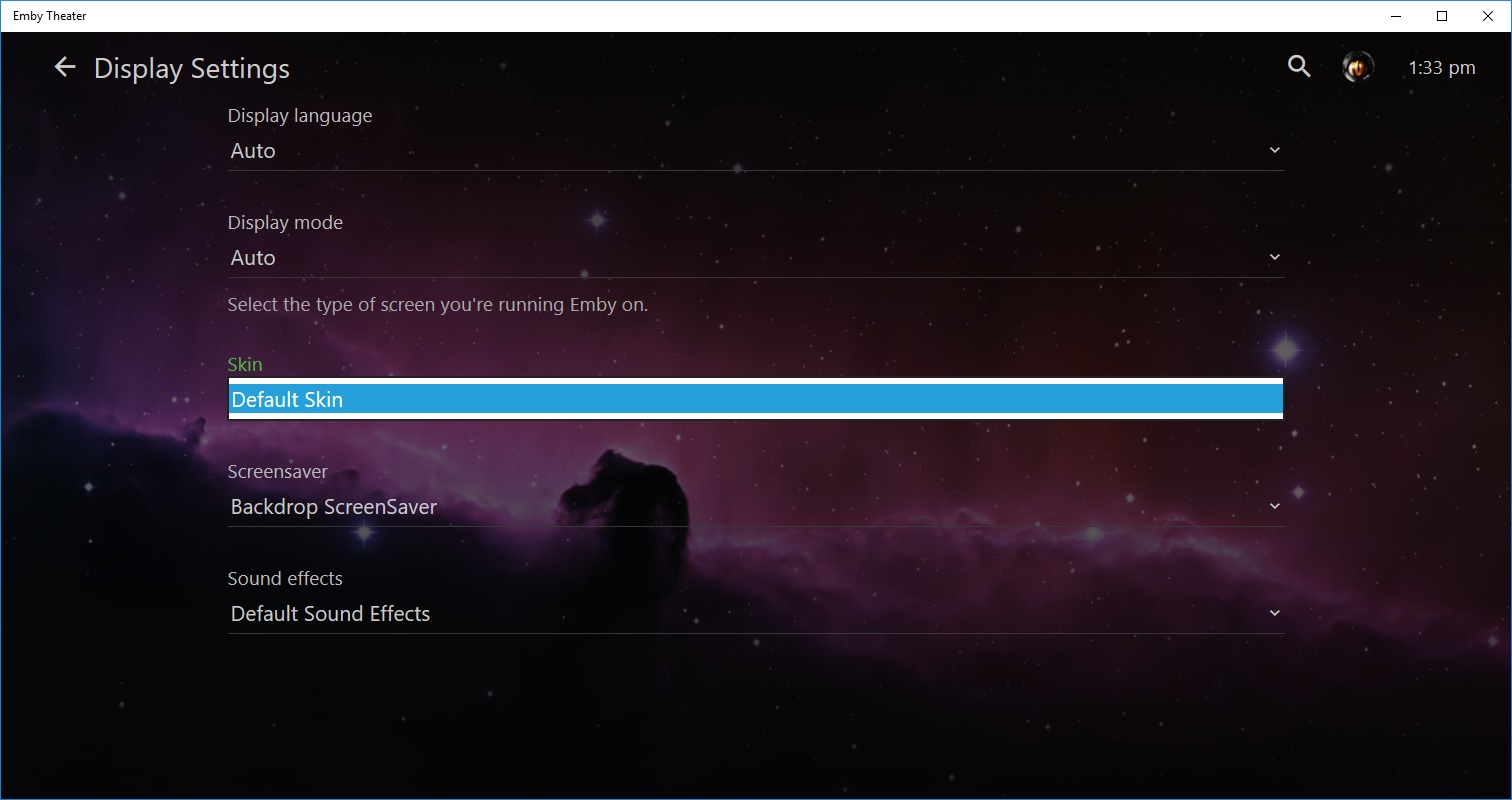

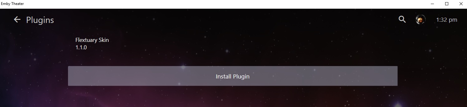

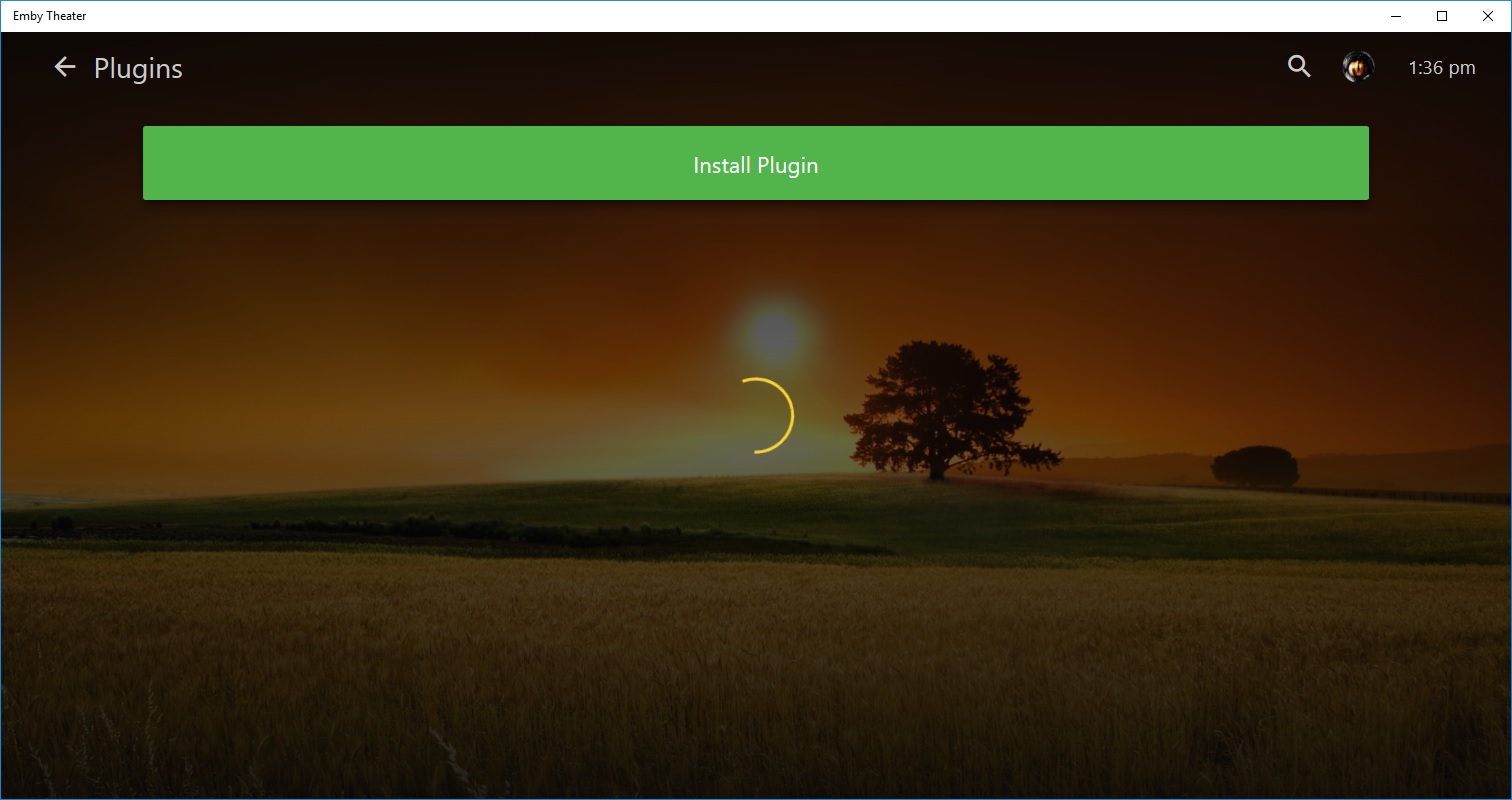

Happy2Play 9812 Posted June 10, 2017 Posted June 10, 2017 (edited) Figured this needed its own topic. Why do Skins only work on "ET for Windows" (desktop version)? Is it the different settings/menu options between the version?Win 10 app and tv.emby.mediaYou get spinning circle but if you back out and re-enter Install plugin you see plugin is supposedly installed.But no way to select it and if you close and reopen app it is no long shown as installed.Where are the logs for the app located? Edited June 10, 2017 by Happy2Play
Happy2Play 9812 Posted June 10, 2017 Author Posted June 10, 2017 (edited) Edit tv.emby.media requires https https://flexage.github.io/emby-web-flextuary/package.json http gives me Install Failure. http://flexage.github.io/emby-web-flextuary/package.json So only having issue on ET Window 10 app/UWP Edited June 10, 2017 by Happy2Play
Luke 42243 Posted June 10, 2017 Posted June 10, 2017 It's possible that uwp isn't allowing external script execution, so at some point we'll need a workaround for that. We will probably need to host the plugins ourselves so that we can whitelist the domain in the app. 1
