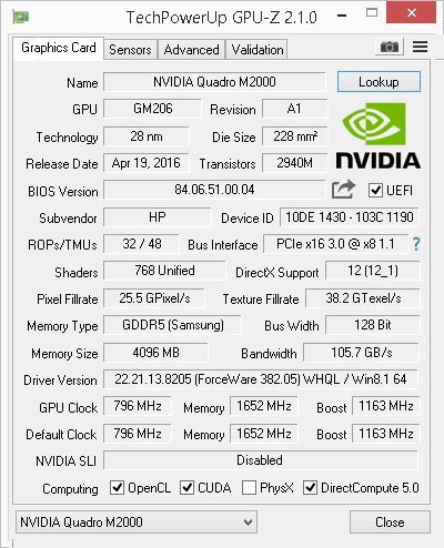

wsramahi 7 Posted June 30, 2017 Posted June 30, 2017 (edited) Hello , im having same issue, its happening on emby for android and emby theater on MS Surface Pro 4, movies with blue-ray avc format needs transcending, i have an nvidia hardware transcending and its working fine on web streaming from emby and any IOS device including emby for IOS. i tried all the options i know on the emby for android TV, can you help plz! server: win 8.1 emby server: 3.2.20.0 nvidia: quadro M2000 nividia Driver: 22.21.13.8205 CUDA: 5.2 CPU: Intel i7 6700 RAM: 16Gb DDR3 HDD: 2xSSD Evo 850 raid 0 Emby for Android TV: 1.4.17g FFmpeg: 20170613 here is the logs: movie play back time exactly at 2017-06-30 17:53:00.0178 ffmpeg-transcode-80963b35-70a6-4d7b-bfa3-fffc9c02b1d5.txt server-63634377600.txt Edited June 30, 2017 by wsramahi
Luke 42245 Posted June 30, 2017 Posted June 30, 2017 Hi there @@wsramahi, please check your in-app quality setting. In this example it appears to be set to 5mbps, therefore it is trancoding because the media bitrate is higher than that. Please let us know if this helps. thanks !
