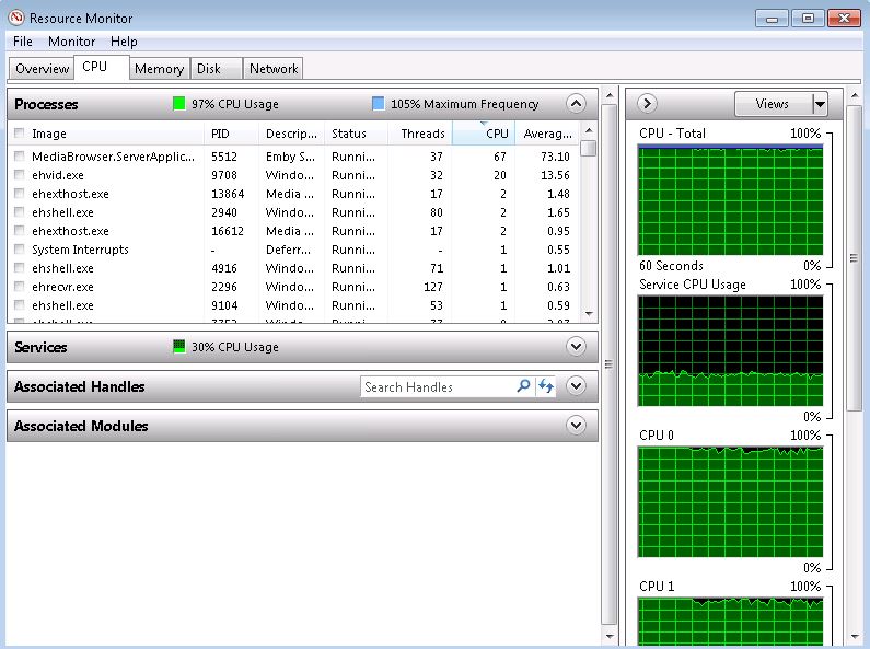

Sammy 790 Posted May 26, 2017 Posted May 26, 2017 Lately I've been hearing my cooling fans doing double duty on my HTPC so i checked resource monitor and found that Emby Server has a high CPU Utilization. What gives? Do you need anything else from me? TIA Emby Server Log.txt

Sammy 790 Posted May 26, 2017 Author Posted May 26, 2017 I did that. CPU usage dropped to about 25%. I re-installed my plugins and it is back at 75%. I supposed the next thing to do would be to uninstall them again and then install them one at a time to see which one spikes CPU usage? Any educated guesses as to which one it might be? Also, this HTPC runs 6 (not all at once but maybe 3 at a time sometimes) extenders (5 ceton echos and one xBox 360) so I need a bit of reserve on the CPU. This could explain why my extenders have started disconnecting when not in use, so Windows can reserve resources for Emby Server even though nothing is using the server for playback.

legallink 187 Posted May 26, 2017 Posted May 26, 2017 @@Sammy that still sounds very high. I don't know what your hardware is, but while Emby server is just running (some tasks obviously make the machine take more, but it idle's at 2 - 5% utilization and Emby is at 0%. Are you doing some conversions? creating roku thumbnails? something that requires a lot of cpu time? And yes, I would totally install the plugins one at a time to see what causes the spike.
Sammy 790 Posted May 26, 2017 Author Posted May 26, 2017 (edited) @@Sammy that still sounds very high. I don't know what your hardware is, but while Emby server is just running (some tasks obviously make the machine take more, but it idle's at 2 - 5% utilization and Emby is at 0%. Are you doing some conversions? creating roku thumbnails? something that requires a lot of cpu time? And yes, I would totally install the plugins one at a time to see what causes the spike. It is a Haswell Devil's Canyon 4690k i5 on a Gigabyte Z97 Gaming MoBo with 12Gb low latency DDR3, HD7850 GPU and a 250Gb Samsung PRO 850 SSD. It is no slacker. I don't think there's any processes running on Emby Server, nothing is being converted for upload to a client and I don't use Roku Thumbs but that sounds like a nice plugin to check out after this is resolved. Sent from my SM-G930P using Tapatalk Edited May 26, 2017 by Sammy

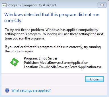

Sammy 790 Posted May 26, 2017 Author Posted May 26, 2017 (edited) Okay. I started doing that and after uninstalling Auto Box Sets the Server crashed and I got this error. I reloaded the server and utilization is still at 25% but I'm still removing the plugins. Edited May 26, 2017 by Sammy
