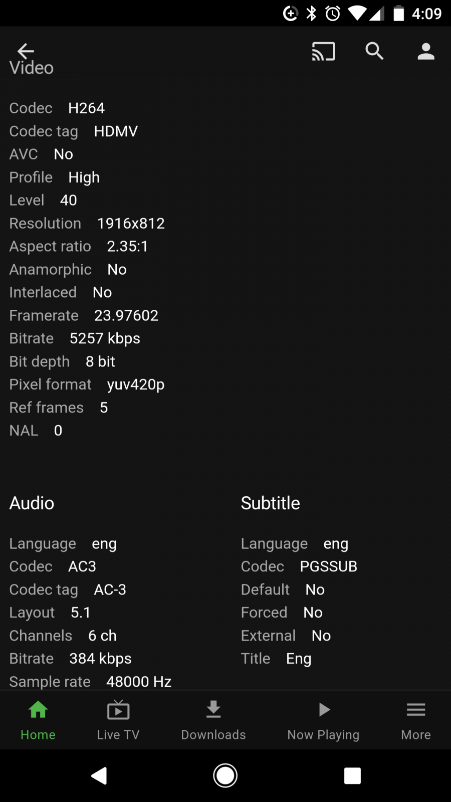

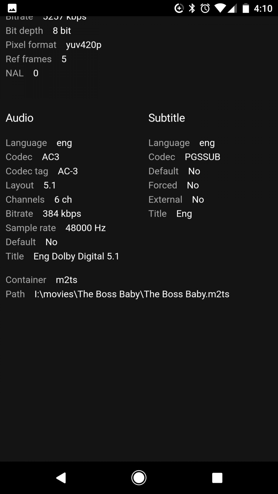

Luke 42243 Posted May 25, 2017 Posted May 25, 2017 @@DrJekle, what is the media info of something this is happening with? Can you provide a copy of that from the web app detail screen? thanks !
DrJekle 4 Posted May 25, 2017 Author Posted May 25, 2017 I attached a screen shot of the media info from the most recent movie that had the issue.
DrJekle 4 Posted May 26, 2017 Author Posted May 26, 2017 All my movie files are in mt2s format. Sometimes it acts up and sometimes it doesn't. Live TV playback is buggy sometimes as well. File playback never froze while madVR was an option for comparison but I do not believe that is the culprit.
