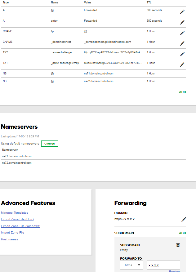

well you will need to post how your go daddy is setup...  I bet your doing some kind of forwarding rather than actually pointing your A and AAAA records to your internet IP.
SilentStrike
I'm afraid.. That's maybe what I'm doing..? See the screenshot bellow (I didn't add the www.domain.ca yet, as I was merely focusing on emby.domain.ca)
But for some reason, I have a feeling I have to delete those forwards and clean up some records up top and add some there for everything to work?
pir8radio

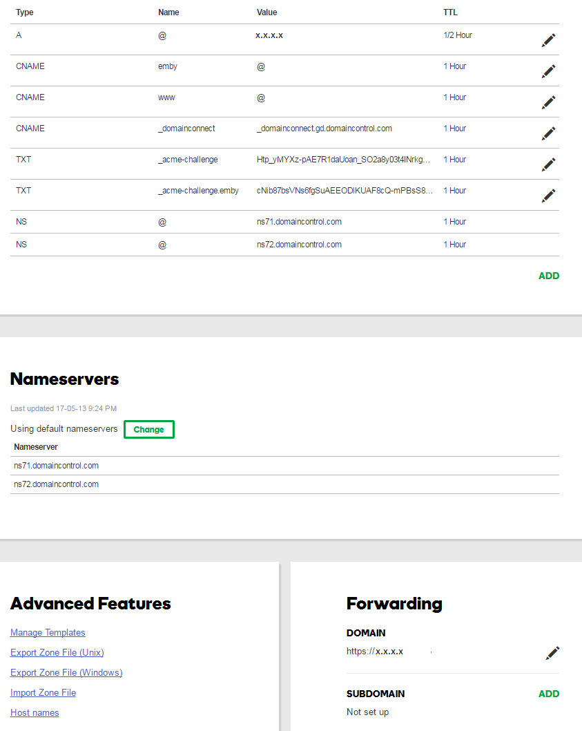

you should only have one A record (unless you have a more complicated setup with multiple server locations) anything else should be a CNAME as Swynol said in an earlier post.  Your A record should reference your IP address.   Then the CNAMES are prefixes of your domain name, that point to your A record..   So you have one cname "ftp" which was probably default?  You can delete it if you dont have an ftp server setup..   Try to create a CNAME emby that points to @ and see how things work.
SilentStrike
my cname record should point to the name of my A record if I understand correctly? What does the @ define here? And yes, it was default. I'll get rid of it.
Edited by SilentStrike
pir8radio
You will need to fix your A record too, to point to your IP address and not be "forwarded".   Unless thats a godaddy thing.
godaddy uses @ to reference your domain name.
SilentStrike
This is what I got.
So far, it just says that the DNS address can't be found. I'm thinking it just taking time to take into effect? Do the records look good?

ok to work on the emby block.
can you ping emby.domain.ca and see if it responds with your WAN IP address.
Also i noticed on the screen shot above that under the forwarding rule there is a subdomain section. i wonder if that needs to be set as emby.domain.ca
Edited by Swynol

Alright, so... There's some positive stuff going on! Ha. But also some confusing stuff!
Looks like things are starting to work out. emby.domain.ca, www.domain.ca, or even radarr.domain.ca all seem to work and go to their respective server blocks. I'm on my computer at work, and everything works fine.
The thing is.. It's only working on my work computer. I asked a friend of mine to test it, and I also tried from my cellphone, and it says ERR_ADDRESS_UNREACHABLE.
Now you asked me to ping domain.ca and see if it responds properly. Well the ping doesn't go through, but it resolves my IP Address. Is this what was intended?
Another factor that might be playing into account here, is my computer's firewall. I've deactivated my Windows Firewall, but I use Eset Smart Security which has an integrated firewall. Technically it interacts with me every single time someone tries to communicate with my computer. That being said, I openned and allowed access to port 443 and 80.
Edit: Alright, so I figured I could actually try and disable my firewall to test out to see if anything changed. Nothing changed. So I think that might rule out the fact that the firewall is interfering in some way?
Swynol
Now you asked me to ping domain.ca and see if it responds properly. Well the ping doesn't go through, but it resolves my IP Address. Is this what was intended? - yes this is intended, just wanted to make sure the CNAMEs were working correctly.
The thing is.. It's only working on my work computer. I asked a friend of mine to test it, and I also tried from my cellphone, and it says ERR_ADDRESS_UNREACHABLE. - This could be a DNS issue or a cache issue. if you can ask your friend to do the ping test to emby.domain.ca and see if it resolved the IP. Same on your phone. DNS propagation can take up to 24hrs. usually i would expect it to take no more than 2 hours.I dont think its your firewall as ERR_ADDRESS_UNREACHABLE usually means that the domain name cant resolve an IP or its resolving the wrong IP. if it was a firewall it would be something like ERR_CONNECTION_REFUSED
