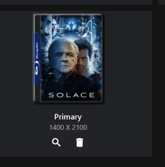

Okay, just to add - this DOES seem to be the same problem we had a number of months back. When I take the primary "poster" image open it in paint and save it to my desktop, then replace the primary image with the "edited" version, refresh the browser and the size is fixed and back to normal.
I had to do that so all the films I added when we have this before, then you guys found and fixed the problem... I'd have to search for the old posts, but this may be that same issue again? It was something like the dimensions wasn't showing or something like in the web clients - and that is the same now. The primary image has no dimensions, but when I save the file, edit in paint, save and upload then the dimension are showing... does this help track the problem down?

here are the before I edit in paint and after...
Is there a difference between those two screenshots?
barrettuk
post-1339-0-99549600-1496111785_thumb.pngpost-1339-0-92318100-1496111796_thumb.pngIs there a difference between those two screenshots?
Yes, take a look right under the cover picture and you see before I edit the image, it doesn't have the size - but after (and normally) it shows the size such as 1400x2100 in this case. This was a problem a while back but I can't find the old thread.

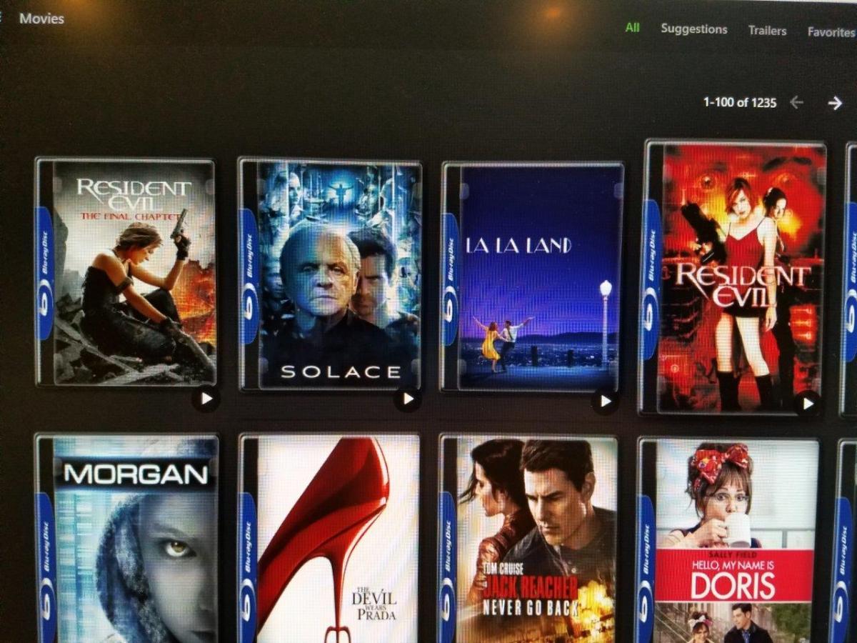

Just did my own testing and came to the conclusion that in my case using the sidebar treatment distorts the poster image itself more then other treatments, on top of it also creating the incorrect size of any new posters, Because of this issue I decided to change to the case treatment. No matter what I did to correct it, I always had to switch to ignore treatment and then back to sidebar treatment to correct the really bad size difference. However with the latest Cover Art version newly added images are now no longer the same height even after that procedure. Below are 4 screen shots demonstrating this and again this is in the Fire Fox browser.
Totally wrong image size of the newly added Lion poster but note the proper round "O" in Lion itself.
After correction an elongated "O" in Lion and notice LA LA Land and Lion are now no longer the same height as other posters.
With No treatment proper poster size.
Finally using Case treatment all posters are proper size

I believe that is simply because the treatments with the information on the side change the aspect ratio more than the ones with it on the top and the web app is making decisions on how to display these based on how close their aspect ratio is to a known constant.
We've seen that CA is actually creating images of consistent size/shape and that these images all show consistently in other apps so it seems it has to be this decision logic in the web app together with the lack of size information that shows for a given image that is causing the anomaly.

Added a new movie since my last turn it off and on again procedure.
The image is small in, server web interface, ET 2.7.8, beta android and the Windows store version. Strangely it is the correct size in Emby WMC and Ember for Emby, which I forgot I even had installed.

The ones that show correctly have the image size and the ones that show small do not have the image size as highlighted in these two examples?
La La Land is small and RE final chapter is big (normal)
