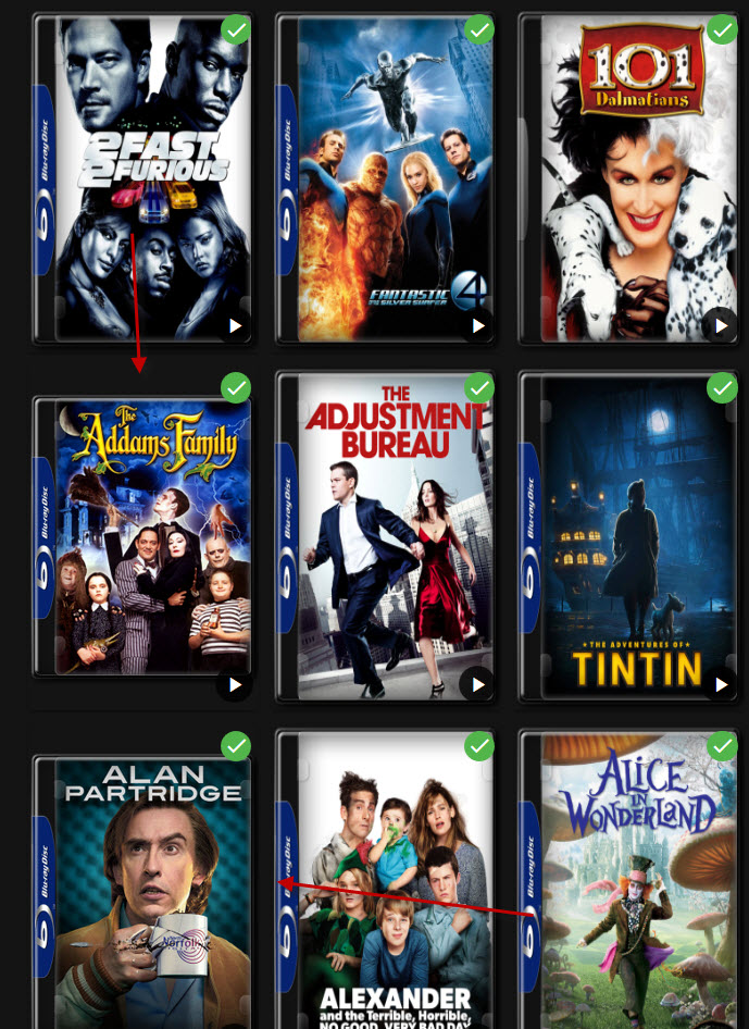

Crestj 68 Posted May 15, 2017 Posted May 15, 2017 There was actually a fix made in the server core related to poster aspect calculation and it turns out it was incorrect before. That's why new posters look slightly different. If you want them all regenerated you can delete the server's cache/images folder, as well as individual emby app caches. In the case of the web app that would mean clearing browsing data. Thanks. The logo is a different matter that I'm aware of. Just to be clear, it's this folder's contents that we should delete all files and folders from? C:\Users\<username>\AppData\Roaming\Emby-Server\cache\images
JohnnyM 40 Posted May 15, 2017 Author Posted May 15, 2017 (edited) That's the one I did. JohnnyM PS Restart the server after you do that. Edited May 15, 2017 by JohnnyM 1

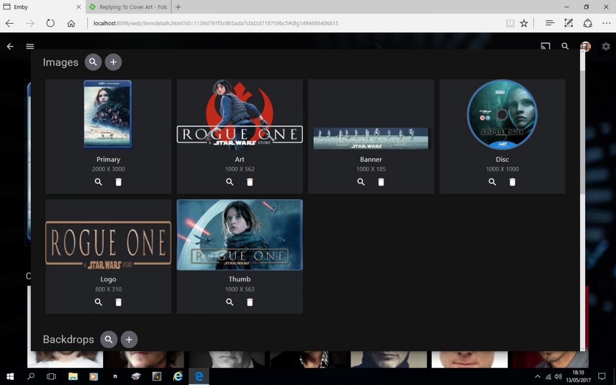

Crestj 68 Posted May 16, 2017 Posted May 16, 2017 (edited) Hmmm, I stop Emby server and cleared that folder out as well as clearing the browser cache. Restarted Emby and let it settle down but I still see some movies with smaller images (small images.jpg) I have the CoverArt plugin configured to make all these images the same size. I've also tried ticking it and letting it refresh the images then unticking it again. ****************************************************************************************************** EDIT: I have just changed the CoverArt treatment from Clearcase to Case and they still show the incorrect sizes. I seem to be stuck at the issue above where the size doesn't show in the "edit images" page. Edited May 16, 2017 by Crestj

Crestj 68 Posted May 17, 2017 Posted May 17, 2017 Scratch that Whilst the first 2 pages of films (about 200) seem to have readjusted their Primary image to be the same size, lots of other films still show their Primary image as much smaller. All show no image size in the "edit images" screen. If I delete the primary image using this screen and add the same back in the size is still too small. If I pick a new picture it resizes successfully about a quarter of the time. I've uninstalled the plugin, cleared the emby image cache, reinstalled the plugin but still no luck.
Luke 42200 Posted May 17, 2017 Posted May 17, 2017 In post #12, the small poster in your screenshot is actually the correct one. cover art adjusts the aspect ratio. you can stop this by enabling the cover art setting to preserve original art aspect ratio.
Crestj 68 Posted May 17, 2017 Posted May 17, 2017 (edited) My understanding is that by default Coverart will adjust your image to fit into the clearcase overlay which remains the same size. I have now ticked this box and after the artwork regenerates I see this still: Interestingly, if I uninstall CoverArt all the Primary images show the same size so I guess Coverart is doing something it's not supposed to do. Edited May 17, 2017 by Crestj
ebr 16309 Posted May 17, 2017 Posted May 17, 2017 My understanding is that by default Coverart will adjust your image to fit into the clearcase overlay which remains the same size. I have now ticked this box and after the artwork regenerates I see this still: Interestingly, if I uninstall CoverArt all the Primary images show the same size so I guess Coverart is doing something it's not supposed to do. No, in this situation, I think it is doing what you told it to. If you checked the box to "Use Original Art Aspect Ratio" then CA will re-shape its treatments to fit the shape of your actual posters. This is so that people who like the fact that BD covers are short and squatty can keep them that way. If you uncheck that box, then CA will force your art into the shape of the particular treatment. So, checking that box should get you what you saw above assuming those posters are actually different shapes. Can you see the actual posters and what shape they are?
