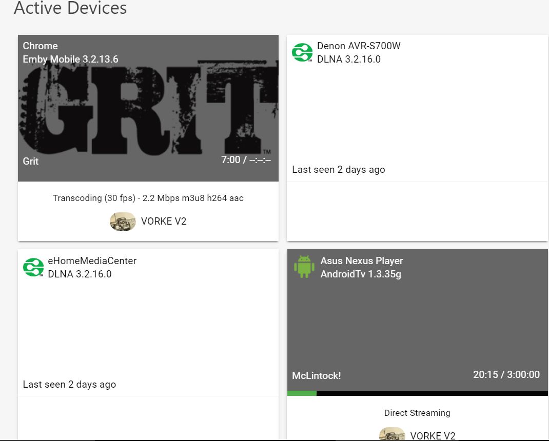

clarkss12 304 Posted May 14, 2017 Posted May 14, 2017 (edited) I am comparing the Live TV playing on my newly built Windows 10 desktop computer and my older Nexus player connected to my Samsung TV. Edit: I was using Chrome browser for playback. My server is on my Vorke V2 (Windows 10), and all my connections are via Gigbit Ethernet. The live TV (SD quality) is transcoding on my desktop computer, but "Direct Streaming" on my Nexus Player. What am I missing on my computer?? Edit, on the same desktop computer, I opened Emby Theater and it is playing the same channel with "Direct Playing" logs attached. Thanks ffmpeg 1 log.txt ffmpeg 2 log.txt server log.txt Edit 3: What is the difference between "Direct Playing" and "Direct Streaming"?? Edited May 14, 2017 by clarkss12
Luke 43461 Posted May 14, 2017 Posted May 14, 2017 Chrome does not support mpeg2video, therefore it has to transcode when playing in the browser.

Solution Guest asrequested Posted May 14, 2017 Solution Posted May 14, 2017 What is the difference between "Direct Playing" and "Direct Streaming"?? Direct Playing = File unchanged. The server just hands off to the player. No server involvement. Direct Streaming = This usually occurs when the audio is changed in some way. Sometimes a full audio transcode or a minor adjustment. So the file is demuxed, the audio is adjusted, then it's remuxed and streamed through the server, with no change to the video. 2
