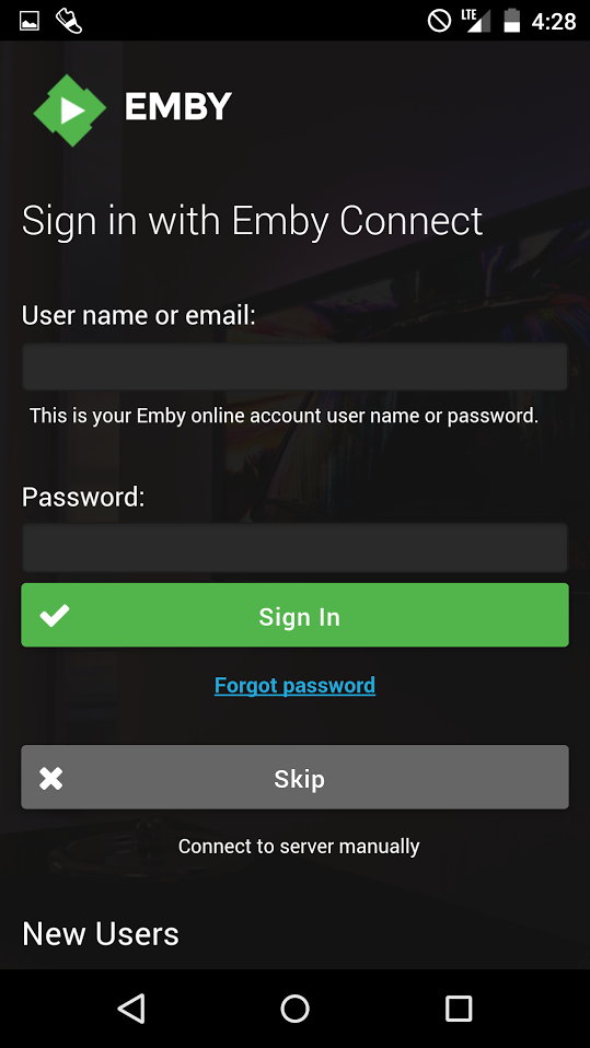

JERRY1 17 Posted May 14, 2017 Author Posted May 14, 2017 t says it after this black n green login screen, then it go's back to this blue n black login screen

JERRY1 17 Posted May 14, 2017 Author Posted May 14, 2017 Same thing , i am trying to log in with my forum user name & password is that the correct way to emby connect ?
Luke 42200 Posted May 14, 2017 Posted May 14, 2017 Yes that is correct. You're saying you can sign in successfully to Emby Connect, but then the next step of connecting to server is the issue? Is that right? After changing that https setting in Emby Server, I would also try restarting Emby Server. Thanks.
JERRY1 17 Posted May 14, 2017 Author Posted May 14, 2017 Sorry for the confusion, still cannot log in with emby connect
