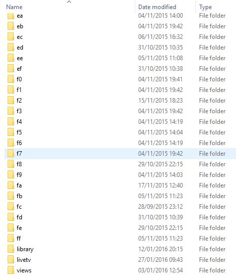

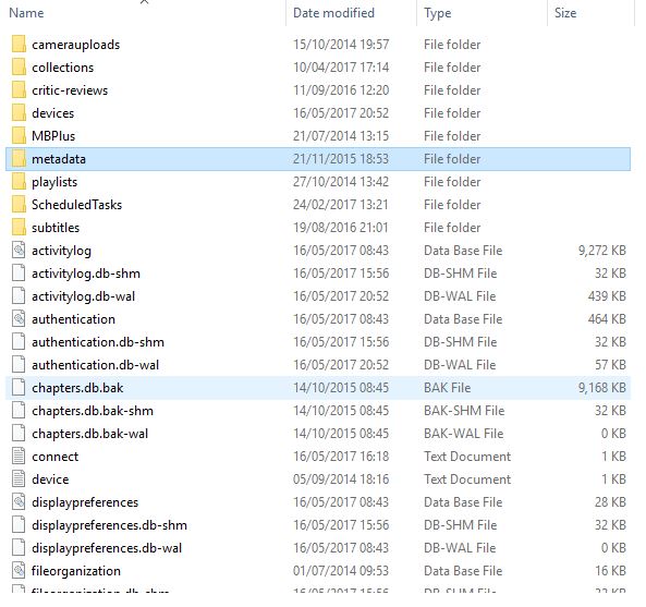

arrbee99 1836 Posted May 16, 2017 Posted May 16, 2017 Is there any way to maybe just move Metadata and Data to a different drive from the install location ? I only have a 120GB SSD as my C drive and as far as I can see Emby is taking up 20.5GB. Of this Metadata is taking up 7.6GB and Data 10.1GB. Would be nice to avoid fiddling with portable installations. Using it as an excuse for a new SSD would be nice but preferably not.
Happy2Play 9802 Posted May 16, 2017 Posted May 16, 2017 (edited) Is there any way to maybe just move Metadata and Data to a different drive from the install location ? I only have a 120GB SSD as my C drive and as far as I can see Emby is taking up 20.5GB. Of this Metadata is taking up 7.6GB and Data 10.1GB. Would be nice to avoid fiddling with portable installations. Using it as an excuse for a new SSD would be nice but preferably not. You have always been able to set the Metadata path, but you have to manually move the existing one or allow it to regenerate at the new path. Dashboard-Library-Advanced-Metadata path As for "Data" I would have to ask what files/folders are large in that folder? Maybe really old stuff from when things were moved around (I believe there use to be a metadata folder there). If you can let us know we can probably tell you what is safe to just delete. As all of my Emby-Server\data folders are under 1GB. I guess there is the CameraUpload folder if you use that, but that is customizable also. Edited May 16, 2017 by Happy2Play
arrbee99 1836 Posted May 16, 2017 Posted May 16, 2017 Thanks Happy2Play, didn't think of looking under Library. It says 'Specify a custom location for downloaded artwork and metadata' - what goes there if I say to store my stuff in the relevant movie / tv folders ? chapter images, actor images... The Metadata folder inside the Data folder shown below is 9GB Inside the Metadata folder is stuff like this The Library folder above is 6.4GB. Maybe its all essential. No idea.
Happy2Play 9802 Posted May 16, 2017 Posted May 16, 2017 (edited) Thanks Happy2Play, didn't think of looking under Library. It says 'Specify a custom location for downloaded artwork and metadata' - what goes there if I say to store my stuff in the relevant movie / tv folders ? chapter images, actor images... The Metadata folder inside the Data folder shown below is 9GB Inside the Metadata folder is stuff like this The Library folder above is 6.4GB. Maybe its all essential. No idea. That is a old metadata location that can be deleted, all the information in it is obsolete and already been duplicated in new/current metadata folder \Emby-Server\Metadata It says 'Specify a custom location for downloaded artwork and metadata' - what goes there if I say to store my stuff in the relevant movie / tv folders ? chapter images, actor images... Well chapter images currently only store in Metadata\Library folder, actors in the Metadata\People folder (usually the largest folder). Only artwork (poster, banner, logo, backdrop, ect) and metadata get stored with media with that option. Edited May 16, 2017 by Happy2Play
