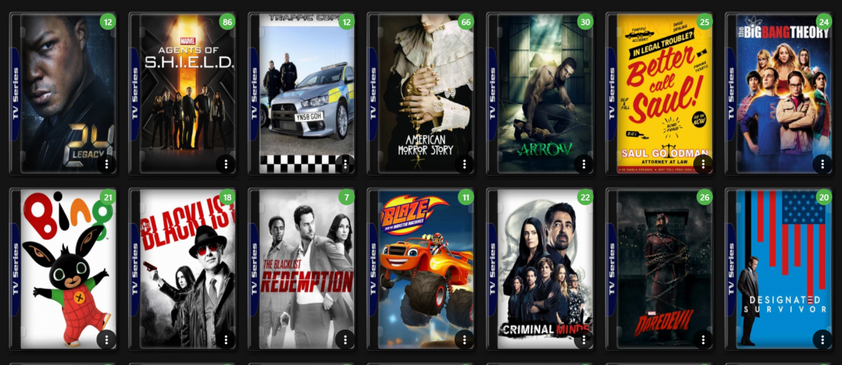

Crestj 68 Posted May 12, 2017 Author Posted May 12, 2017 (edited) After emby restarts I go into my account and select tv shows.All tv shows show unmatched with the number of unwatched episodes in the corner of the image. Edited May 12, 2017 by Crestj
