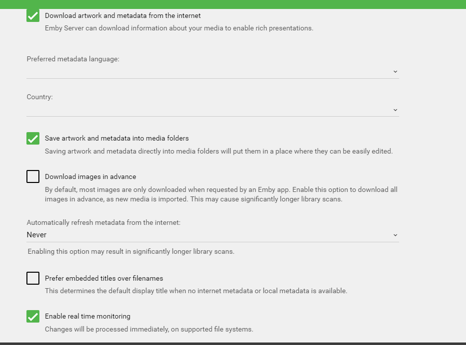

BenDover 3 Posted May 8, 2017 Posted May 8, 2017 It seems like ever since the last update.. My metadata isnt being put in the folders correctly. Let me give an example. Previously the TV show Archer would put all the metadata for the episodes of season 1 into the metadata folder. It would be xml files but now instead, it puts only the jpg for the episode and the xml and other files appear to be going into the appdata\emby-server\metadata folder with random folder names. Below is my settings for the metadata: Attached are the two screenshots showing my settings. Could someone help please.

Luke 42200 Posted May 8, 2017 Posted May 8, 2017 In your series and season folders, just not in a metadata sub-folder. Check your server metadata settings to make sure you haven't turned nfo off.
BenDover 3 Posted May 8, 2017 Author Posted May 8, 2017 In your series and season folders, just not in a metadata sub-folder. Check your server metadata settings to make sure you haven't turned nfo off. ah it is off. if it is off, what does it do for metadata? Only reason i asked is because its been off for a while and when i look at Emby theater all the metadata appears to be there, just not in a format for us OCD metadata people.
Luke 42200 Posted May 8, 2017 Posted May 8, 2017 It saves nfo to your media folders, just like xml but using nfo conventions. that way if you customize changes they will be in a better place for safe keeping.
BenDover 3 Posted May 8, 2017 Author Posted May 8, 2017 It saves nfo to your media folders, just like xml but using nfo conventions. that way if you customize changes they will be in a better place for safe keeping. OK and just to confirm if i have the NFO settings off, its only going to save the jpg for episodes in the metadata folder? or does it save other metadata in the appdata folder?

BenDover 3 Posted May 8, 2017 Author Posted May 8, 2017 Can you describe your issue in more detail? thanks ! Sure. I don't have NFO option selected. It doesnt appear that the metadata folder is being created for new tv shows any longer. Older tv shows which already have metadata in there put the JPG's for the episodes in the metadata folder. Is the metadata folder been phased out? I'm thinking there should be more files for the episodes than just the JPGs.

Luke 42200 Posted May 8, 2017 Posted May 8, 2017 The metadata folder underneath the season folder is an old media browser 2 convention that we dropped a couple years ago. We still recognize metadata inside that folder to read it, but we don't save metadata there.
Luke 42200 Posted May 8, 2017 Posted May 8, 2017 Where we do save is directly inside the series and season folders.
BenDover 3 Posted May 8, 2017 Author Posted May 8, 2017 The metadata folder underneath the season folder is an old media browser 2 convention that we dropped a couple years ago. We still recognize metadata inside that folder to read it, but we don't save metadata there. ah.. Makes sense. If you don't have the NFO option selected, it appears that only the jpg's are being downloaded and there is no other files.. is that correct or where would the other files be saved?

BenDover 3 Posted May 8, 2017 Author Posted May 8, 2017 Correct. Is the rest of the metadata saved in the DB?
