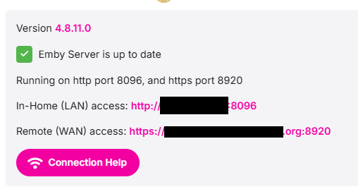

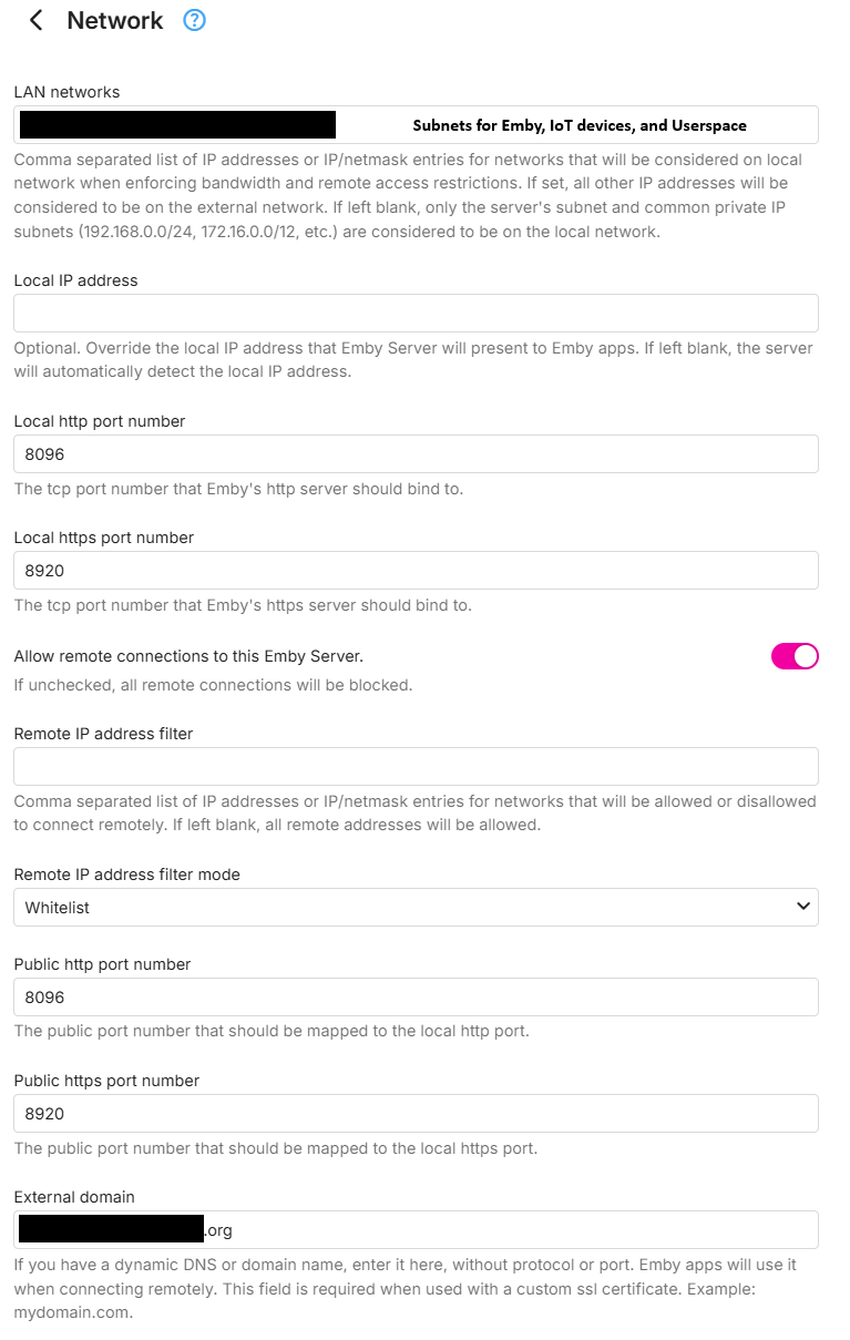

Q-Droid 1011 Posted June 15, 2025 Posted June 15, 2025 The log doesn't have any slow response entries so once connected it appears to be good. Is the LAN IP in the dashboard correct? Are the subnets in the LAN network settings correct and cover all of your vlans? If you have multiple local DNS servers they should resolve the local name to same IP or forward the query to one that does. I think you said this is consistent. The thing is once the clients connect to your server for the first time they should use the connect details that match the dashboard for subsequent connections. The clients fetch and save the connect info. I wonder if the vlan is making the client (not server) behave like it's on a separate/remote network. Are phone apps doing the same thing for the same user? Do they work differently on LAN vs. WAN?
EarlyOnsetPooka 1 Posted June 15, 2025 Posted June 15, 2025 1 hour ago, Q-Droid said: The log doesn't have any slow response entries so once connected it appears to be good. Is the LAN IP in the dashboard correct? Are the subnets in the LAN network settings correct and cover all of your vlans? If you have multiple local DNS servers they should resolve the local name to same IP or forward the query to one that does. I think you said this is consistent. The thing is once the clients connect to your server for the first time they should use the connect details that match the dashboard for subsequent connections. The clients fetch and save the connect info. I wonder if the vlan is making the client (not server) behave like it's on a separate/remote network. Are phone apps doing the same thing for the same user? Do they work differently on LAN vs. WAN? I don't use the phone apps, because I can't stand watching movies and TV on my phone, but I'll download and try it out, since my phone can actually show me what an incoming WAN app attempt looks like. For science

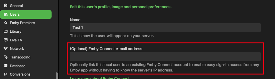

Neminem 1623 Posted June 15, 2025 Posted June 15, 2025 28 minutes ago, EarlyOnsetPooka said: I would honestly just prefer it if Connect never was used You could delete the email on you user, then is should not use connect.
EarlyOnsetPooka 1 Posted June 15, 2025 Posted June 15, 2025 (edited) 43 minutes ago, Neminem said: You could delete the email on you user, then is should not use connect. None of my users have anything in that email field, my own included. Perhaps an uninstall and reinstall of the app will help with that, because I can't find the "clear storage" and "clear cache" on my Google TV streamer Edited June 15, 2025 by EarlyOnsetPooka Typo
