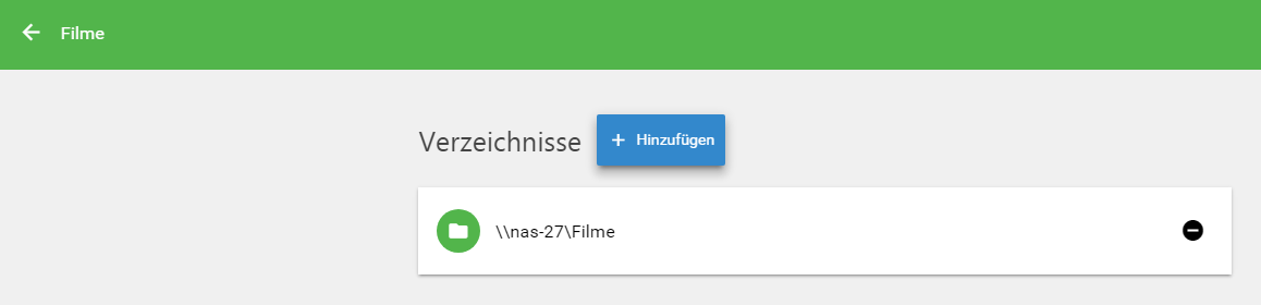

Commerzpunk 5 Posted May 3, 2017 Author Posted May 3, 2017 Hi Luke. No, its not. But its not what i have written and can review in the library path section. See: There is only "\\nas-27\Filme". I guess i have to know what kind of permissions i have to create on my shared folder on the NAS to make it availible for emby. Because when i start a library scan i can hear the NAS drive make some sound like there is at least the try to access it. Any more information you need?
Luke 42200 Posted May 4, 2017 Posted May 4, 2017 hi @@Commerzpunk, this is resolved for the next release of emby server. thanks !

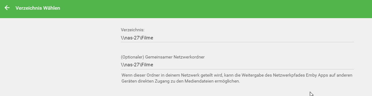

Commerzpunk 5 Posted May 10, 2017 Author Posted May 10, 2017 Hello Luke, i am sure you are right. Look at my librarysetup, the directory: As you see, i never use smb, simply the UNC path to the shared folder. I guess the error is somewhere in the software.

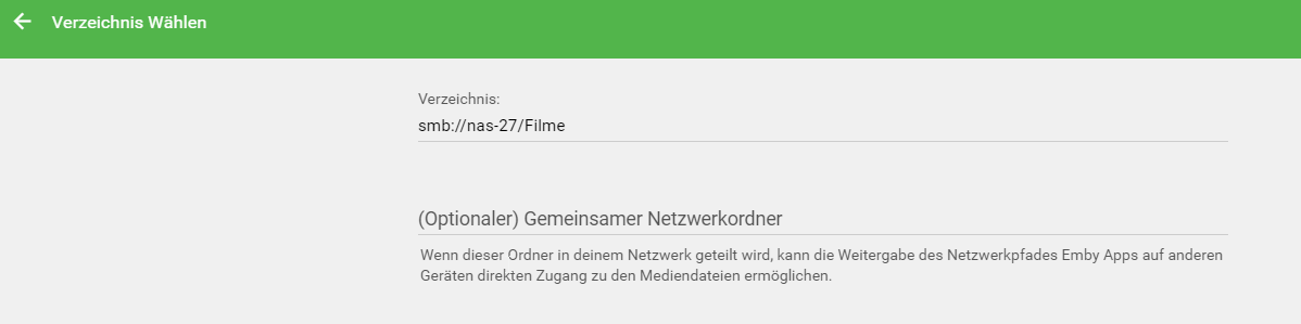

Commerzpunk 5 Posted May 10, 2017 Author Posted May 10, 2017 I manually changed the path to smb:// But there is no effect, see the attached log. It starts today when the server waked up, i deleted the library and set it up new with smb:// embylog2.txt
Luke 42200 Posted May 10, 2017 Posted May 10, 2017 Ok, I see the issue. It's resolved for the next release, thanks.
