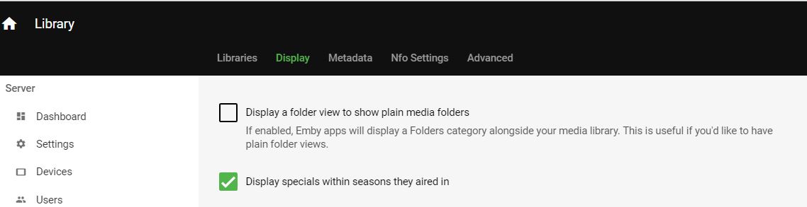

jordy 284 Posted April 21, 2017 Posted April 21, 2017 @@Strudo76, make sure you have this box checked in the Library / Display tab. It enables playback of Specials at the correct point in the season they are aired in.
Strudo76 7 Posted April 21, 2017 Author Posted April 21, 2017 Hey there Jordy, thanks for the reply. I am aware of that setting, and I do have that set. It has the same issue that the specials folder is still the first item in the series, so the feature to automatically select the next episode will pick an unplayed special if one is available, rather than the next episode in order. For example if there are episodes ep1, ep2, special1, ep3, ep4, special2, ep5, in the series screen, the specials will be the first item (00), followed by season 1 (01). If I watch up to episodes 1, 2, special1, 3, then as the specials are the first item, special2 will be selected aas the next unplayed episode, rather than episode 4. Indeed, having that setting enabled makes an even stronger case for having the specials at the end, as all the specials will be naturally played in their correct position in the series in the due course of watching the series.

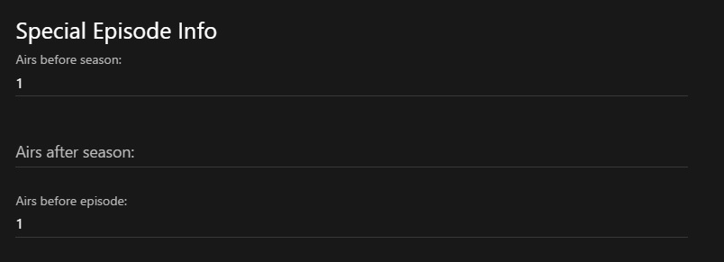

Happy2Play 9802 Posted April 21, 2017 Posted April 21, 2017 Specials need additional metadata to say when to play the special.
Strudo76 7 Posted April 21, 2017 Author Posted April 21, 2017 Hey there Happy2Play, I'm aware of the metadata requirements, but having the specials inserted into the seasons where they are supposed to be isn't a problem, and works as intended. I'll try and reword my previous example to give a different perspective. Let's say there is series that has one season and a couple of specials. When I enter the series display, I see two items. The first is specials, the other is season 1. The metadata for the episodes specifies that they should be watched in the order of: episode 1 episode 2 special 1 episode 3 episode 4 special 2 episode 5 At this point, the highlighted item is the specials folder, as that is first on the screen and has an unplayed episode (special 1). To be in the correct order, episode 1 should be watched before any of the specials, so the season 1 folder should be highlighted. If I then watch episode 1, episode 2, and special 1, then next episode that I would need to watch is episode 3. If I go into the series screen, the highlighted item will again be the specials folder, as that is the first item on the screen and has an unplayed episode (special 2). By having the specials folder as the last item on the page, in combination with the option to insert specials in their correct order, every time I enter the series screen, the highlighted item will always be the next episode I want to watch as specified by the metadata. Hope that explains what I'm talking about it a little better. I use the WMP plugin without the smart home page (or whatever it's called), so I don't make use of features like the "next episode". This is when I go to the TV shows library and select a show I want to watch. This is going into the library, not directly into the folders. The option to show plain media folders is disabled.
