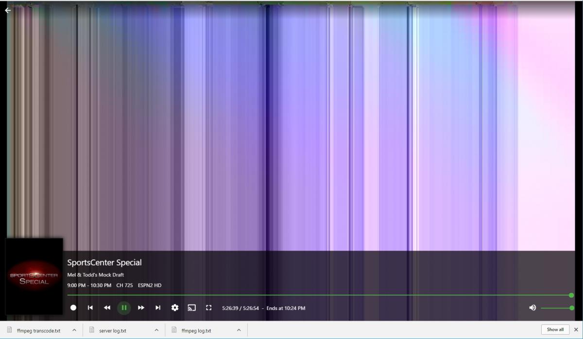

bardmaster 17 Posted April 21, 2017 Author Posted April 21, 2017 Thanks, happy to help. Also note the purple rain on the Chrome video that I had running for 4+ hours - the video was still going, audio was fine, but every 3 seconds or so the screen washed out with color.

ebr 16335 Posted April 21, 2017 Posted April 21, 2017 Thanks, happy to help. Also note the purple rain on the Chrome video that I had running for 4+ hours - the video was still going, audio was fine, but every 3 seconds or so the screen washed out with color. Please put this in the other thread I created for you. Thanks.
