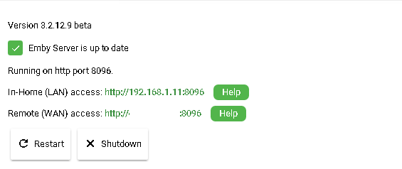

dethknite 45 Posted April 19, 2017 Author Posted April 19, 2017 Hmmm.. I see my server no longer says https is listening on the main page... but I have it setup and configured still and it was working fine??
Luke 42198 Posted April 19, 2017 Posted April 19, 2017 In order to see that on the server dashboard, you need to enable the "Report https as external address" option in hosting settings. What kind of ssl cert are you using? Your own or the built in self-signed cert?
Luke 42198 Posted April 19, 2017 Posted April 19, 2017 It sounds like you are using the default self signed cert and browsers are going to reject that. You should get a trusted cert for this, such as LetsEncrypt for example.
dethknite 45 Posted April 19, 2017 Author Posted April 19, 2017 I am using a Cert that I purchased from namecheap.com... it has been working fine for the longest time. I sent that screenshot because it used to say listening on https as well in the hud but no longer does. Also, I do have the option checked to report https as external address.
Solution dethknite 45 Posted April 19, 2017 Author Solution Posted April 19, 2017 *Sigh* I run cloudstation drive (synology product) on my nas and my pc.. and the ssl certificate is in there... the latest version changed the location it is synced to.. to a subfolder \drive\... so Emby no longer could find the cert. I got this all resolved... sorry and thanks so much for pointing me towards the certificate! 1
